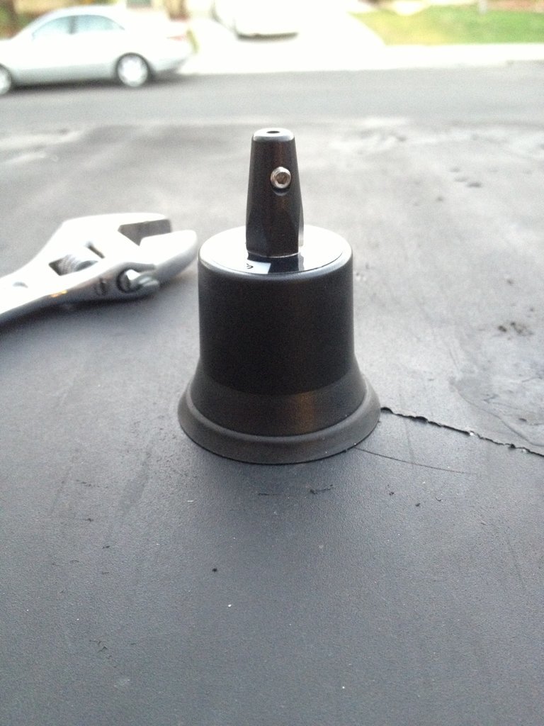

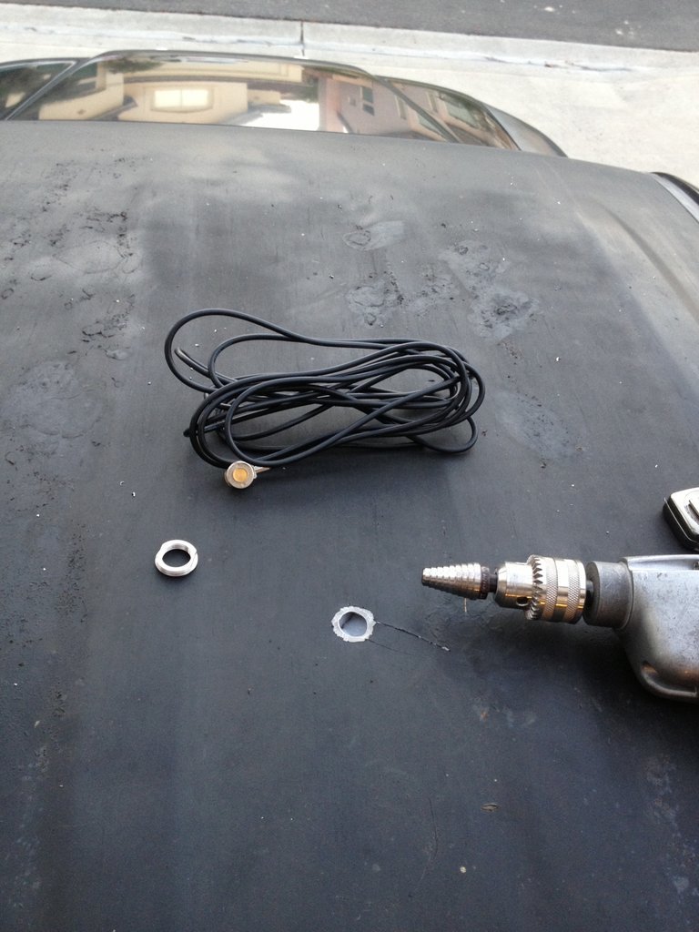

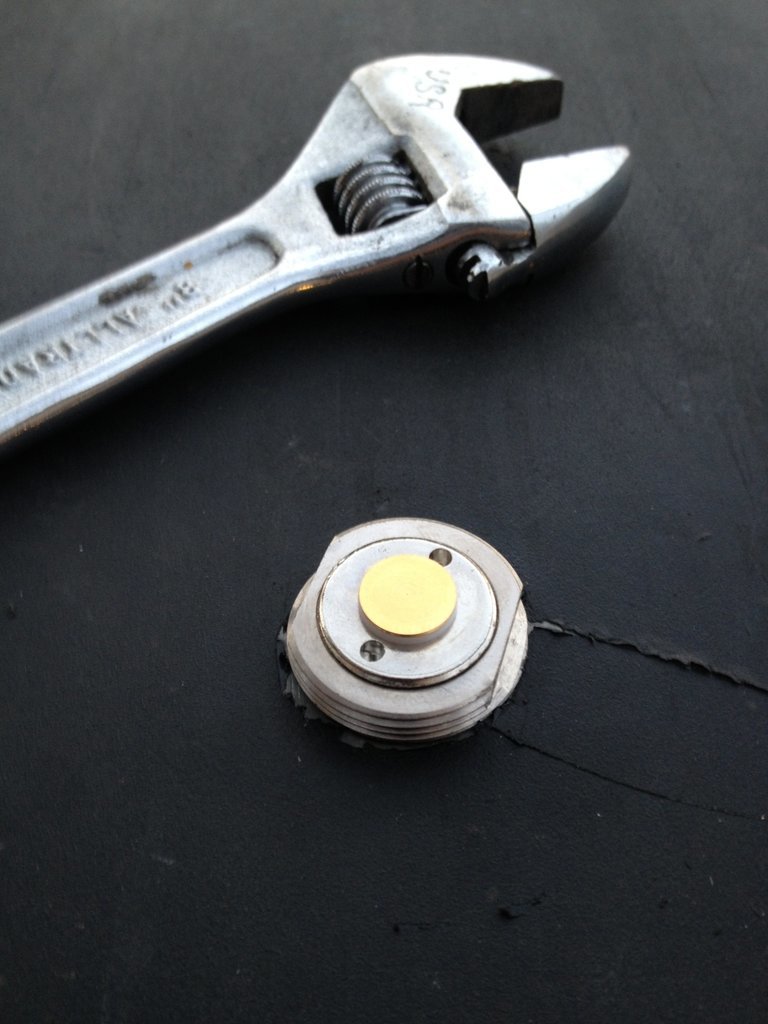

    also installed a scan gauge and a larsen permanent antennae mount for the radio
    drill 3/4'' hole in roof, check.
    don't mind my fucked up paint / plastidipped roof. These black sand pearl roofs seem to have some sort of paint cancer.
    #becausechasetruck

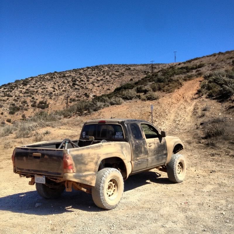

    Went to test out the locker after work, my babe climbs like a champ.

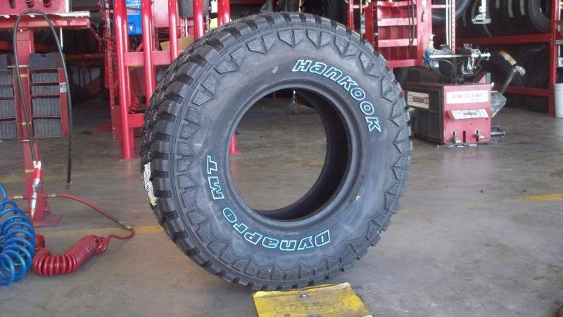

    35's and Truck Shop sliders ordered and on the way :cool: ......its only money righttt?

    yeeeeeee, saw the tires in person and I was sold. I was about to get the kuhmo road venture at's but they are surprisingly heavier than the hankooks!

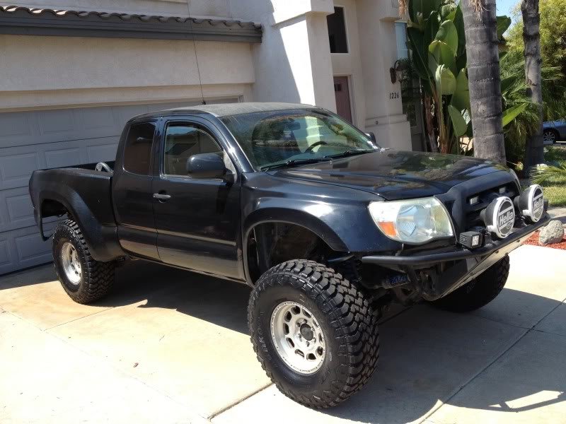

    Shes got some new shoes :cool:
