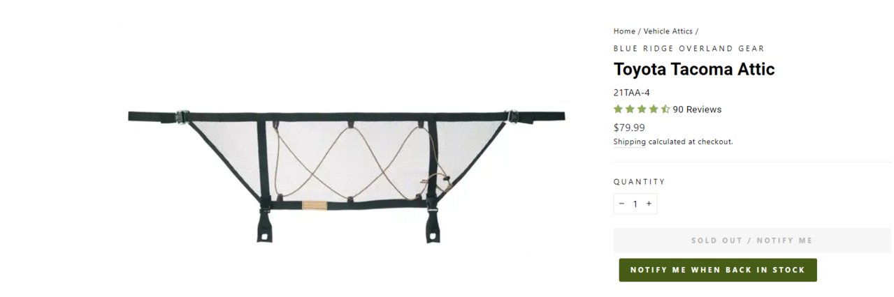

    On the Blue Ridge Overland Gear Website there is a Tacoma Attic and within the description it says "Does NOT fit access cab versions of the Tacoma." which is actually lie because with about 8 more pieces of hardware it fits perfectly

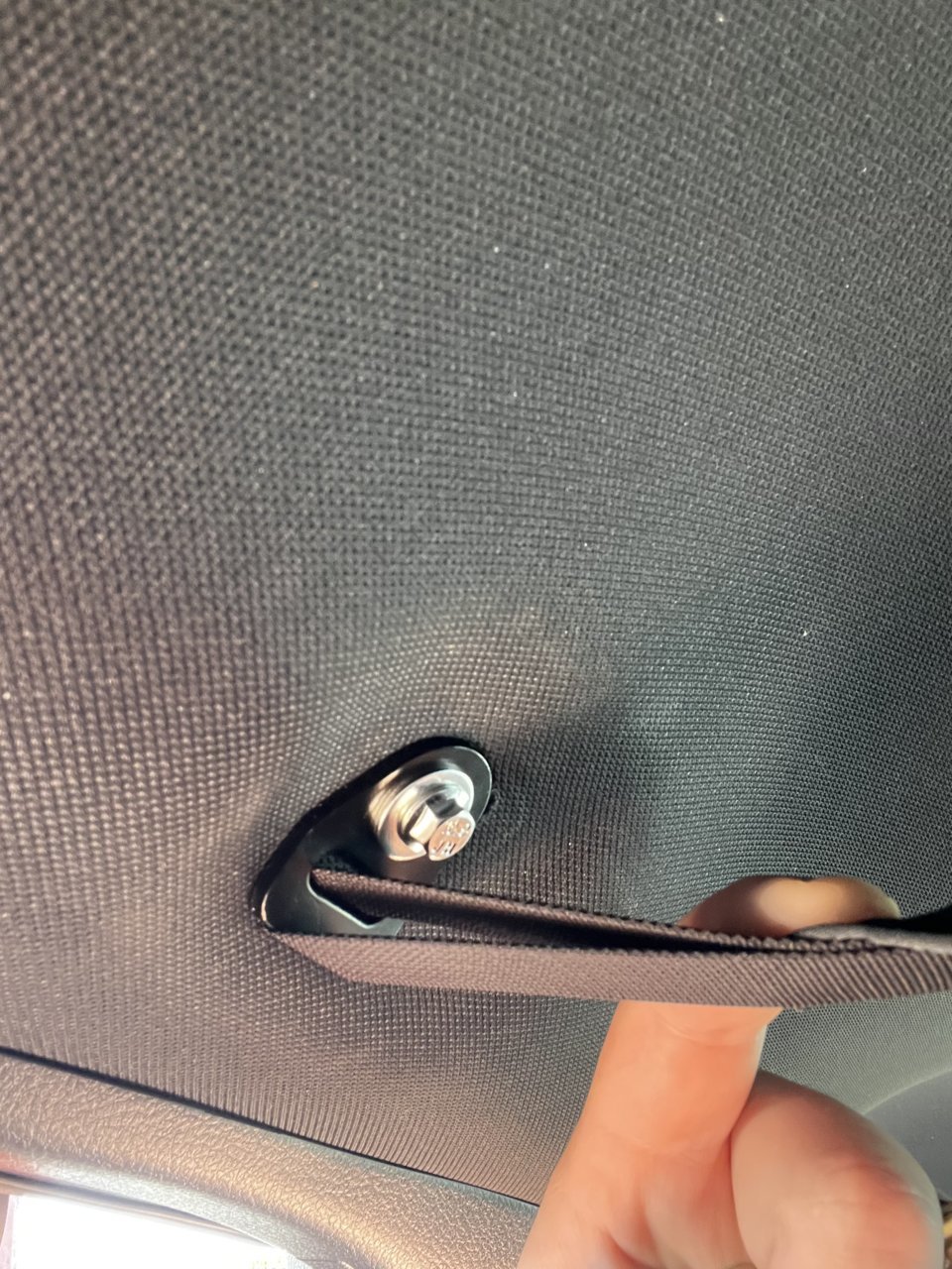

    2 - M6 Rivnuts
    2 - M6 Flange bolt (Short 15-25mm)
    2 - Washers
    2 - Bolt plates with 1inch strap opening https://www.shipperssupplies.com/1-inch-bolt-down-plate

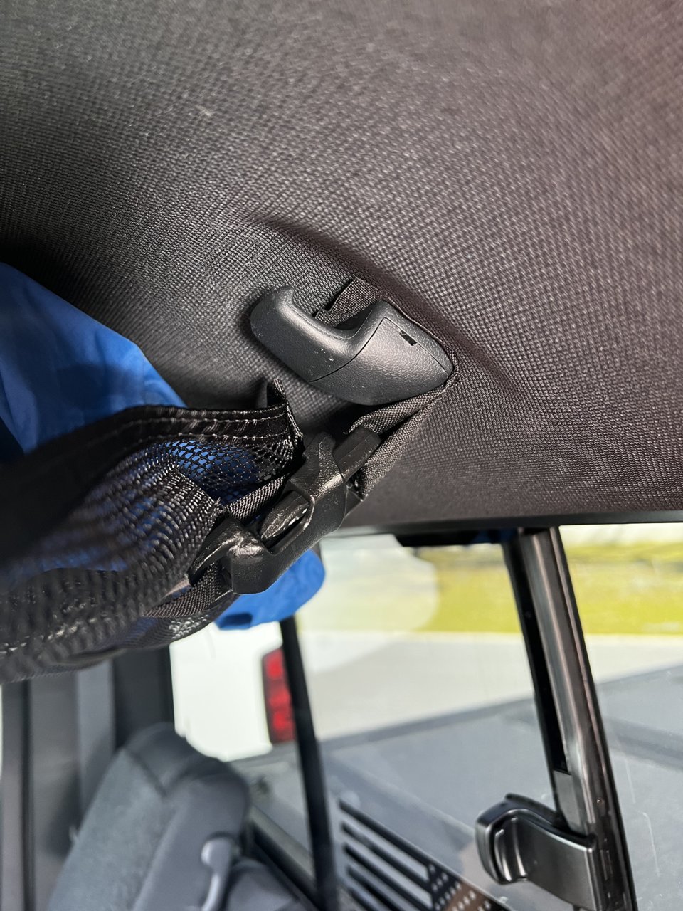

    On the back wall you install it just like the directions say but with the clips pointing down instead of forward like the directions

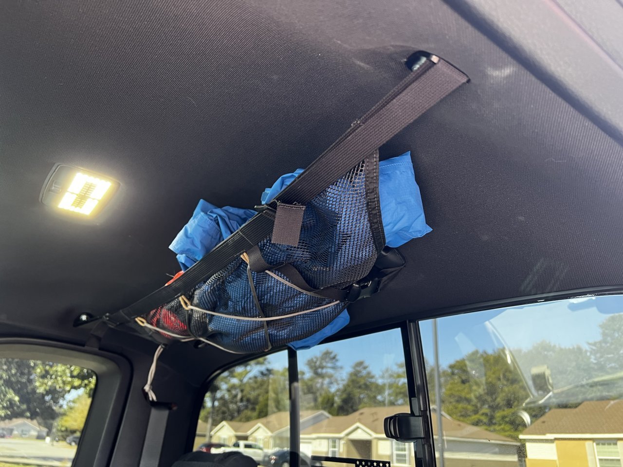

    On the side just above the half doors there are black plastic covers with an opening the size of a flat-blade screw driver size hole that you will use to pry it open once open remove just like the clips off the back wall but these will not be reused.
    In the Rectangle opening is where you will use the M6 Rivnut I just tried to center so that the bolt plate covers the opening when installed

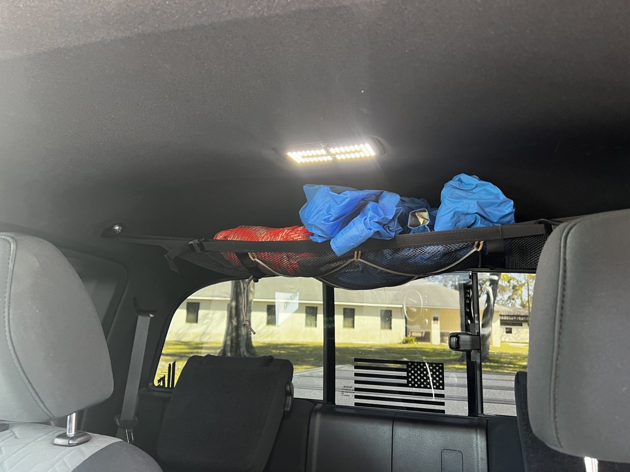

    Once the Riv-nuts are in you will bolt in the bolt plate pointing down with a washer on the M6 flange bolt and install the sides just like in the BROG instructions where the handles would be and now you have an access cab Tacoma attic

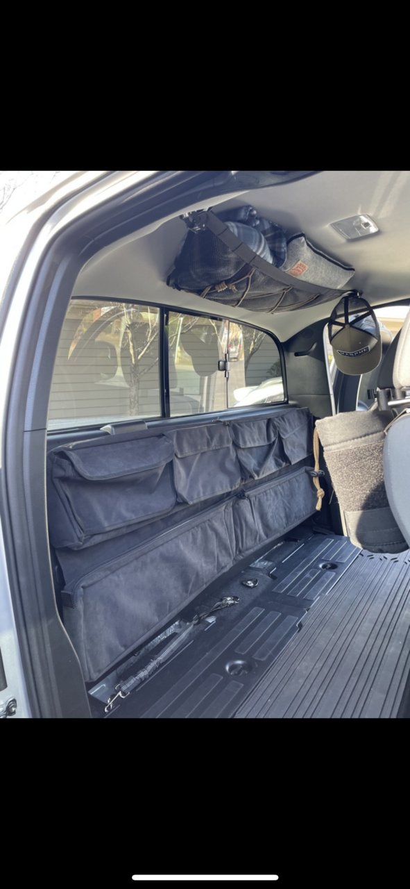

    Our attic kits work with access cabs, no modification necessary :thumbsup:
