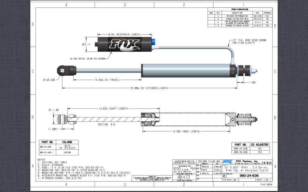

    UPDATE:
    I was able to reach out and speak to Will in warranty claims at Fox. He informed me that as of May 5, 2014 (last year essentially) there was a major revision done on these shocks to address the stem problem, but he did say that the new design was much more stout and was now designed to be a serviceable item. He emailed me a PDF while on the phone of the new design and he also went on to inform me that they have since not had an issue whatsoever with the design revision. He also did mention that the previous design was inferior and was asking for issues the way it currently sat just because of how it was designed (thick stem welded into a thin steel body tube). There is currently still the old design out there in circulation so those looking to order some of these better make sure and identify they are receiving the updated shocks and not the old ones to avoid the hassle I'm currently experiencing.
    -The new design is now a top cap made of solid machined 6061 aluminum and the stem is threaded into the cap (or there is an internal nut in there).
    -The overall thickness of the stem was not a problem because it never broke, it was its mounting point on the shock because it was just welded to thin steel where the weld broke and now lets it hang in free suspension. Once broken, there is no real way to repair it other then to TIG weld it if you are a welder or good at it.
    -As of currently there are no reported issues with those running these revisioned shocks, which is always good news, the fact that it's serviceable now simplifies the issue if they ever break again, making life easier for the at home mechanics if they are ever able to break the new design.
    He informed they were out of stock of these at the moment so he is going to have their race department custom build two new shocks for me on the house with better valving for what I do (because the compression on these is fairly light), as well as install new CD adjusters (to allow for further adjustability of compression settings) for a discounted price because of the situation and the minor inconvenience it is causing. So the only thing I will pay them for is new CD adjuster reservoirs which I will have in about a week and a half. A stand up reply and response from a company which I love. The only thing I have left to request of him which I forgot to ask was to have the shock shaft upgraded to a 7/8 as well since they are building new ones for me because the current one is a 5/8.
    Those looking for the new design, here is what they look like. Much better then the previous model.
    -I also should note the new shocks have a new Extended height of 25.88". Collapsed height of 15.88" so make your bump stop and top out limiting adjustments accordingly if needed:
    Fox%20Updated%20Taco%20Shock_zps093zwm4z_3b6c790ab10cf6bec3b5fb40fcc6c4946f400d04.jpg

    That is the old design where the stem was welded on. The new design utilizes a solid 6061 aluminum top cap and the stem gets threaded into it or a nut on the inside.
    Either way, it is repairable at this point is my point if it ever is to happen again, not rendered useless because of busted welds. Though I believe they revised the stud as well using a stronger metal on it. If I was to take a guess it would be similar to the route Icon went on their rear shocks, which have yet to have a reported issue since 2008.
