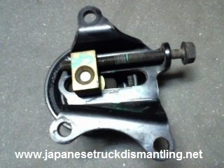

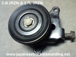

    Assuming your pulley assy looks like this below, you can see how it works. Assuming the adjuster bolt is not rusted or anything it shouldn't have any tension on it & should come out easily.

    Ah, I see. Yup, that is exactly how the pulley looks like. So if I understood correctly, I can just loosen the pulley, and be able to swap the belt without having to worry about the broken adjustment bolt?

    Yes & no. You can loosen the pulley & swap the belt but with the broken adjuster bolt you won't have a way of retensioning the belt unless you use a pry bar or something to pull the pulley up & retighten the pulley.
    I would try to getting a replacement adjusting bolt to fix when you replace the belt. Until then I would just leave it alone. If the squeak is bothering you, since it's not a constant squeak, get a bar of soap & rub it on the inside of the belt (not with the engine running of course). Or auto parts stores sell a lubricant called belt dressing in an aerosol can that works too. But that's just a bandaid & I don't like spraying anything on belts.
