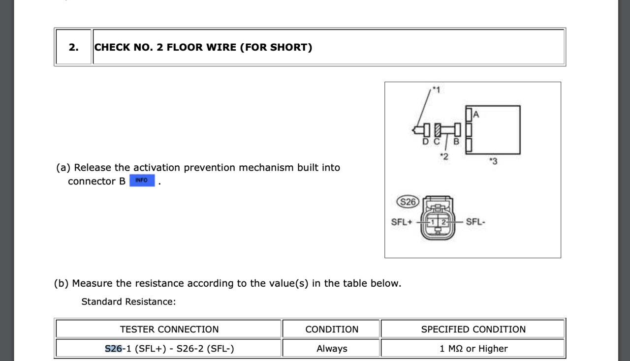

    Thanks.. What is the two different sizes there, is that a pin size or wire length?

    FYI - I think this is the clip as per the manual

    Length
