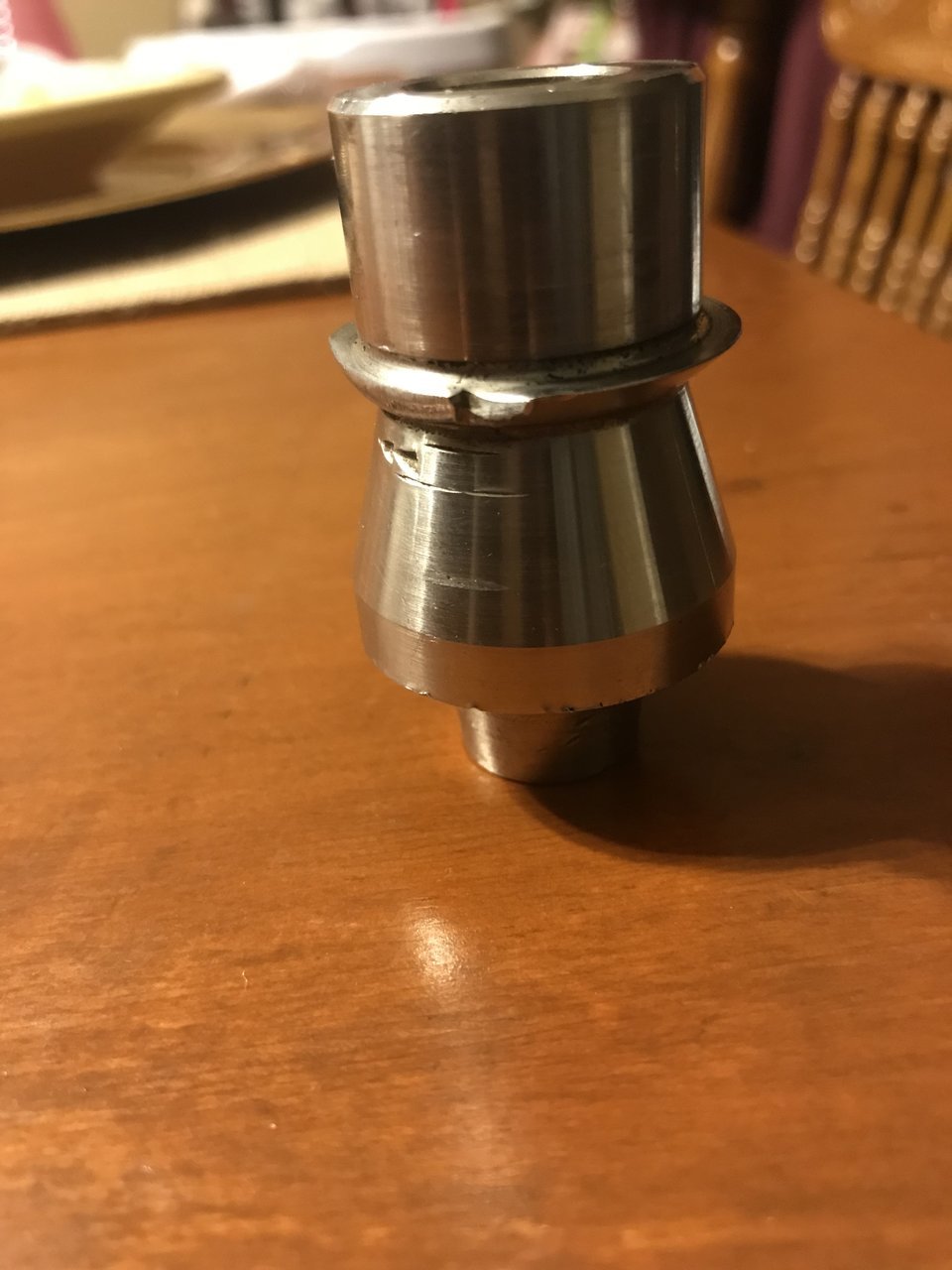

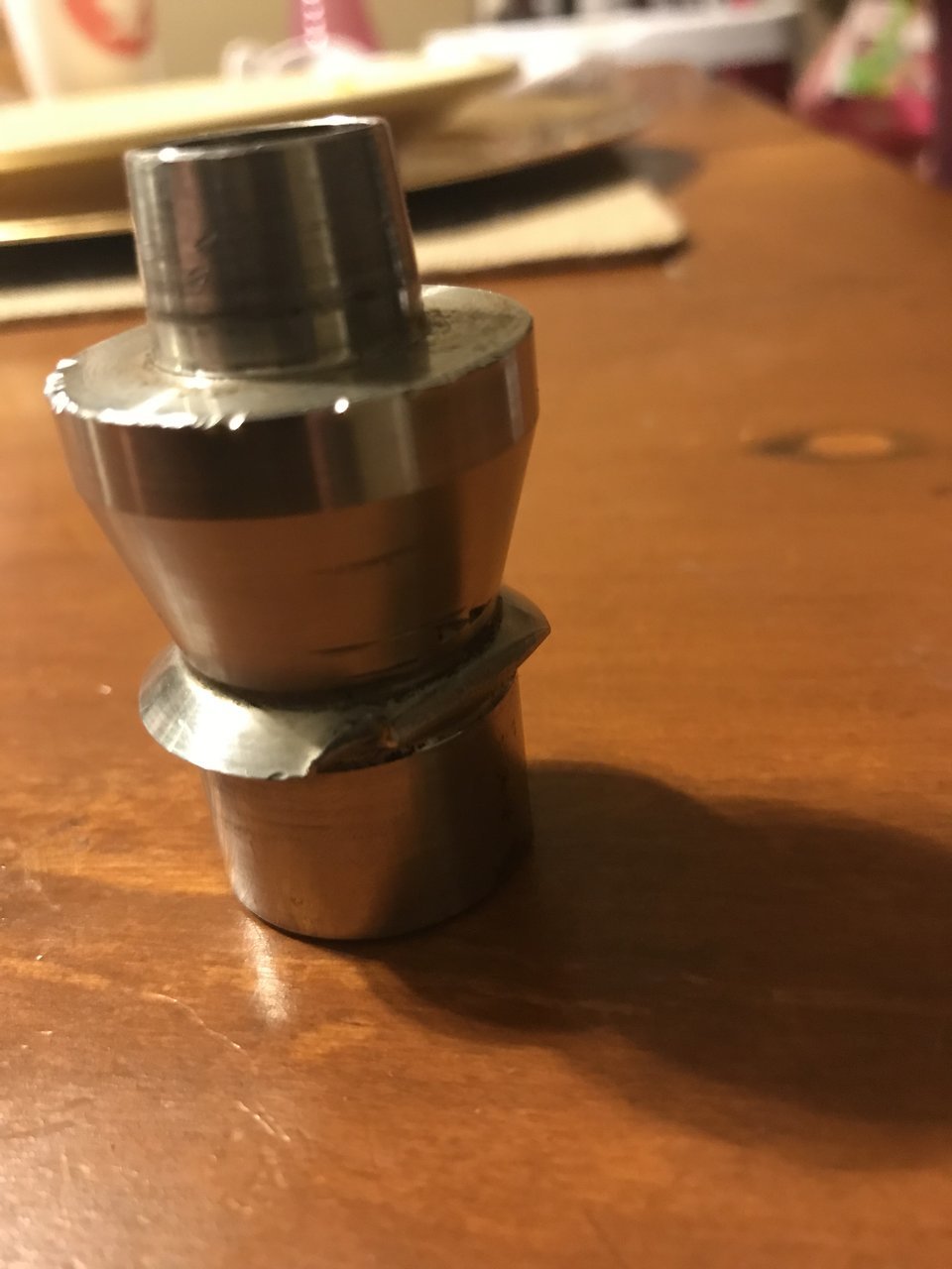

    So I was putting on some new to me built right uca I bought on the forums. Well I got the driver side arm on fine, then installing the passenger side I didn’t realize the arm had drooped and the allignment spacer got caught on the cclip as I was tightening it and the lip on the lower spacer broke. So now idk what to do.
    Do I just wait and try and contact built right Monday and try and get a ride to work then borrow a company truck, or can I put back the stock arm for a bit? Or put both stock arms back on?

    Depends on how far/ fast you have to drive to work.
    If it were me I wouldn't hesitate to throw the stock arm on and at least see how it drives (your alignment will be wonky)
    Im not known to be the most cautious person, but I wouldn't want to put others in danger if your truck isn't controllable.

    Yea I put the stock arm back on the passenger side I only drive 5 miles if that to work jus depends if I can get that part really hope I can.

    pics??

    oh psssh, run with the messed up misalignment spacer while a new one comes. Shouldnt have an issue.

    Lol I already put the factory arm back on the passenger side, so one aftermarket one factory I figure it’ll make it to work. Anybody had to buy a replacement one of these hate to pay a ton but got too guess.

    You don’t think that would’ve torn up the uniball?

    Just take any burrs off that would be above the uniball surface off with a file.

    Anybody had to buy replacement allignment spacers?

    Did you ever get spacers? I'm running into the same issue

    Yea you have to call the truck shop http://sdtruckshop.com/contact/, they manufacturer the built right control arms I ordered a replacement they are expensive though.
