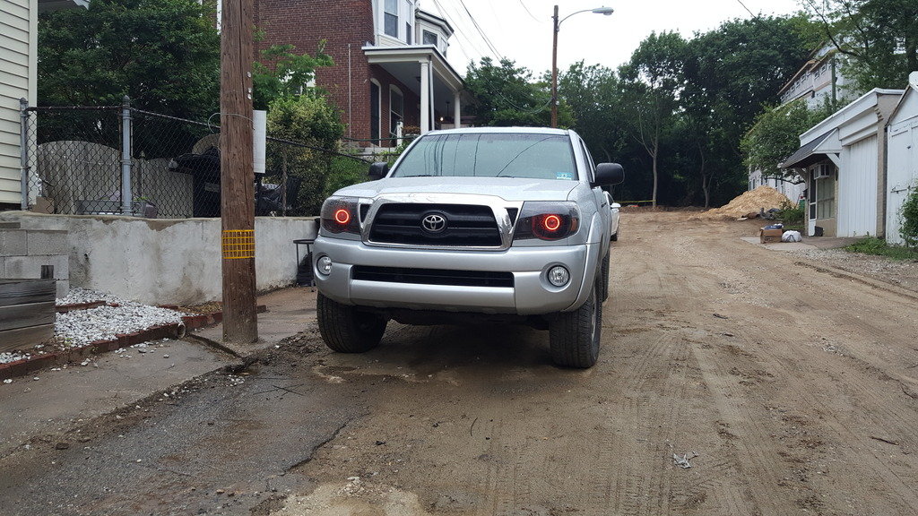

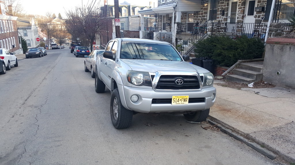

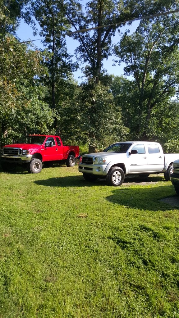

    The day i took it home, and the beast that she replaced. Had to move to the city for school and the F-350 was just to much of a pain in the ass to park, plus i didn't foresee the dropping fuel cost.

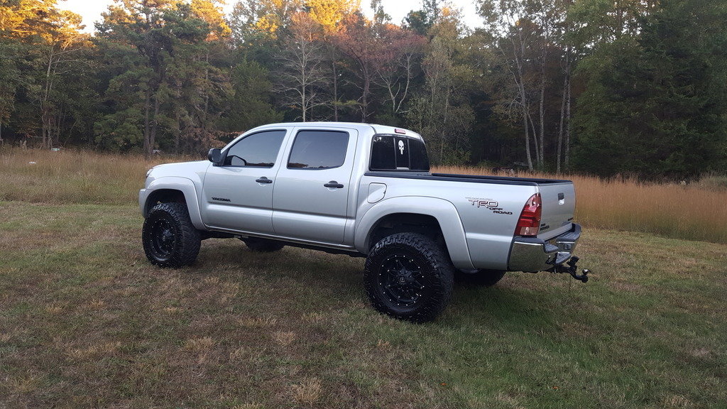

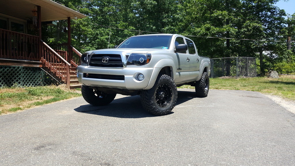

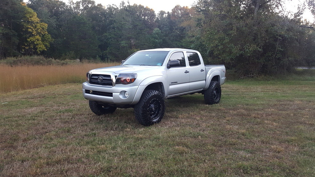

    And how she sits today:

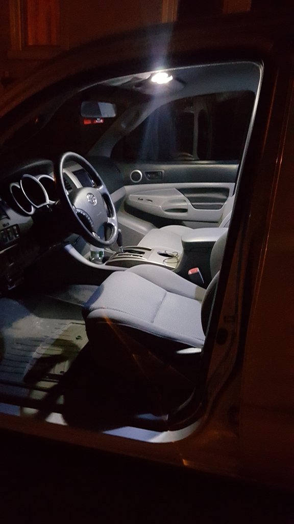

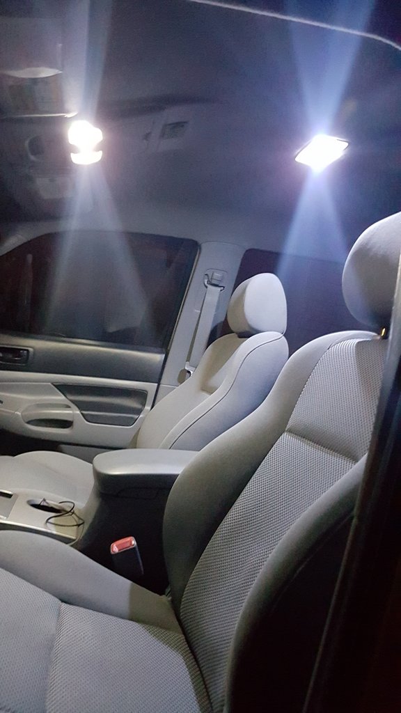

    Interior shot with leds installed:

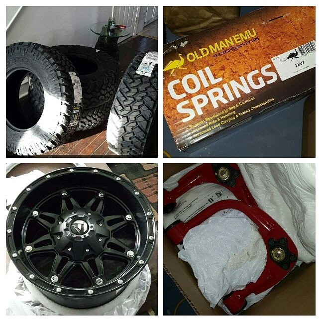

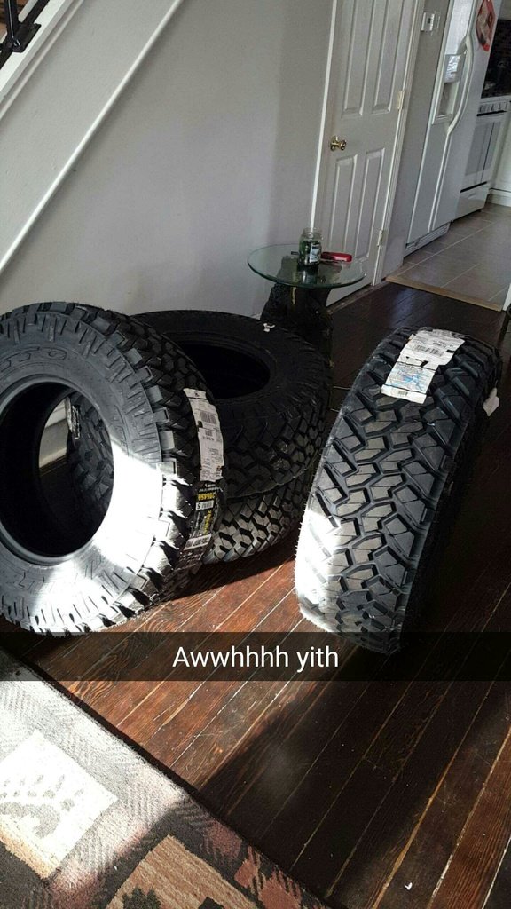

    Tires got here today!!

    Nice wooden floor. Kind of grain is that? That rug looks good too.

    Got everything rounded up, just need to order rear shocks. Now to play the waiting game until the dealer gets my frame in since i want to install everything after the swap.

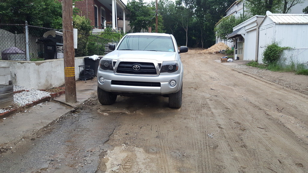

    washed her and restored my headlights, also removed front plate.

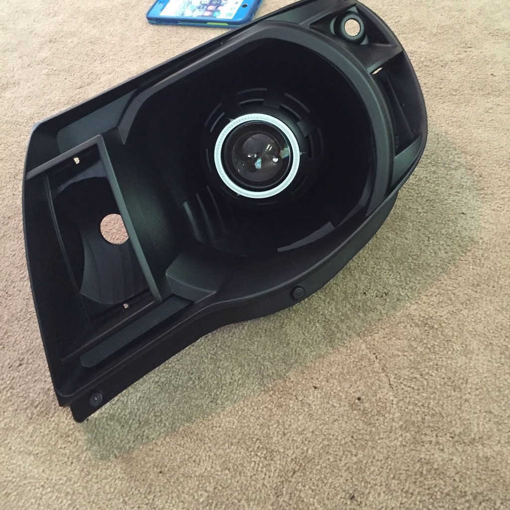

    Got my rear shocks yesterday. I now officially have everything to do my lift. Still waiting on toyota for the frame replacement, was told beginning of may at the latest but who the fuck knows. Projectors should be done and shipped end of next week or early the following, and I'm pretty close to getting my @HomerTaco Satoshi so things will apply come together soon

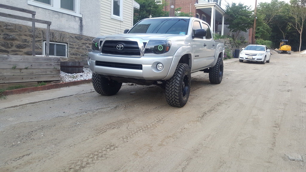

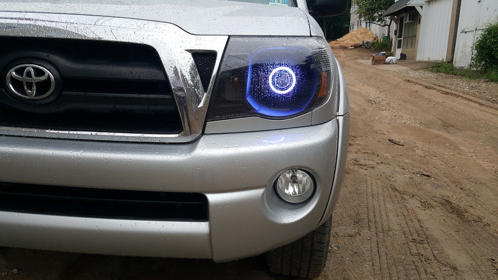

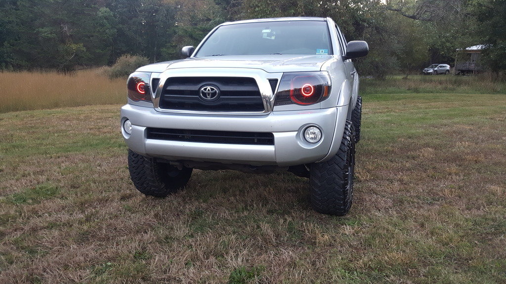

    Got my new headlights installed

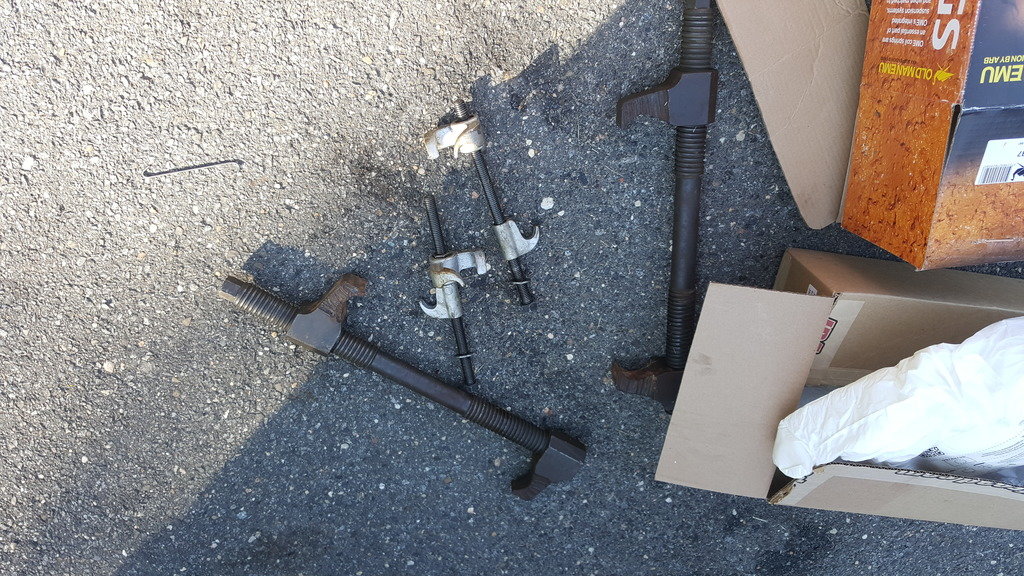

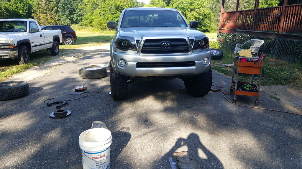

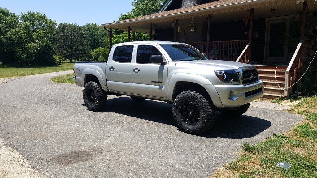

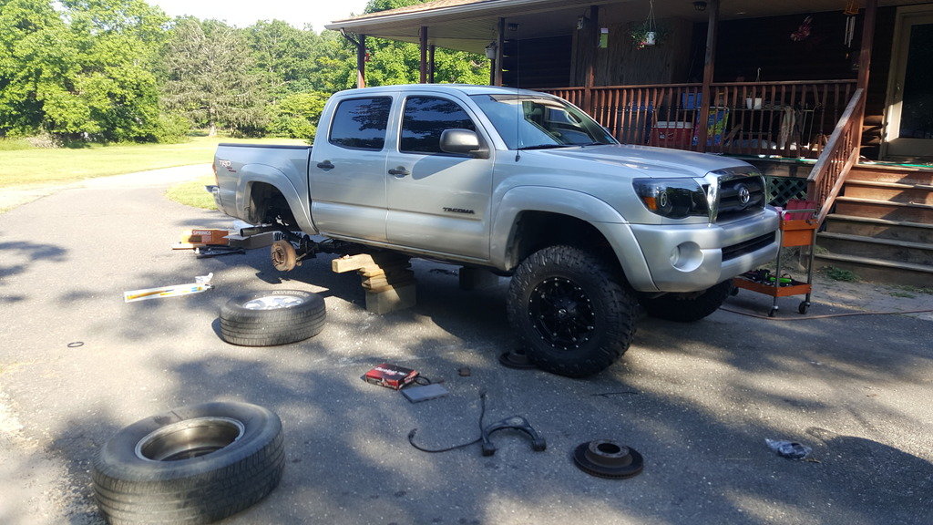

    Lift installed:
    Had to use some military spring compressorsemester

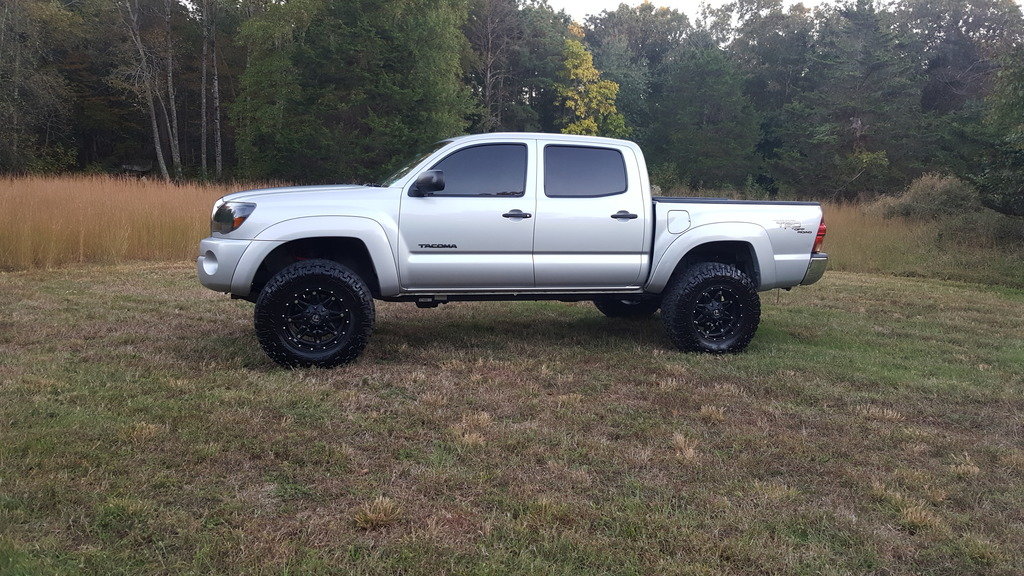

    Note for anyone wanting to run this setup; you have to do a cab mount chop and trim a lot of non visible plastic to get them to clear. Overall not to bad.
