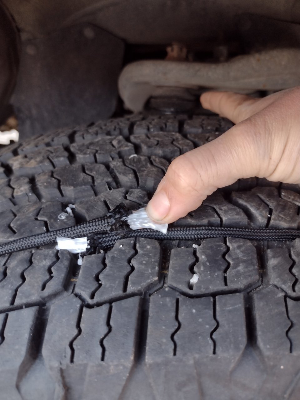

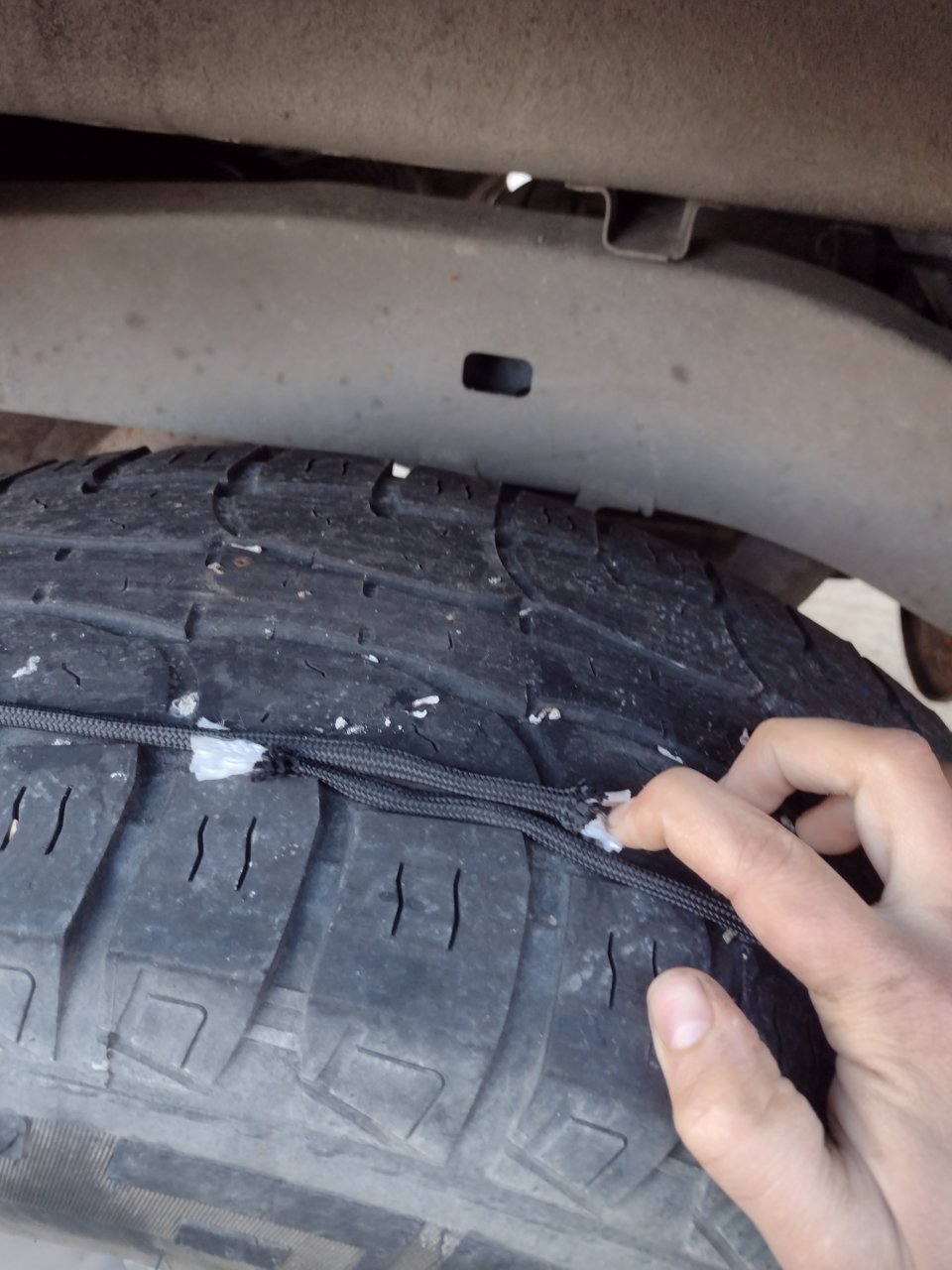

    I lied. The tires are the same size (265/70/R16) but not manufacturer. The 2 front ones are Goodyear Wranglers and the Rear are Provider Entrada A/T
    Here are the pictures I got about 3-4in difference between front and rear...
    I do fail to see how it is a big issue considering they are matching on front and matching on rear. I will research to get more edumacated tho.

    For every turn of the axles, the front of the truck is trying to go 3-4" further forward than the back of the truck, which is a long way for something that is rigid, so it puts stress on the whole drivetrain. Apparently, input for the front diff is the weakest link, so it let go after a while.

    It's an issue because the transfer case does not have a differential: the front and rear output shafts always spin at the same speed in 4wd.
    When your tire sizes are different from front to rear and you're in 4wd the front diff input and rear diff input are spinning at different RPMs while you cruise. The transfer case isn't capable of accommodating that. That creates binding and puts a lot of strain on the transfer case and differentials
