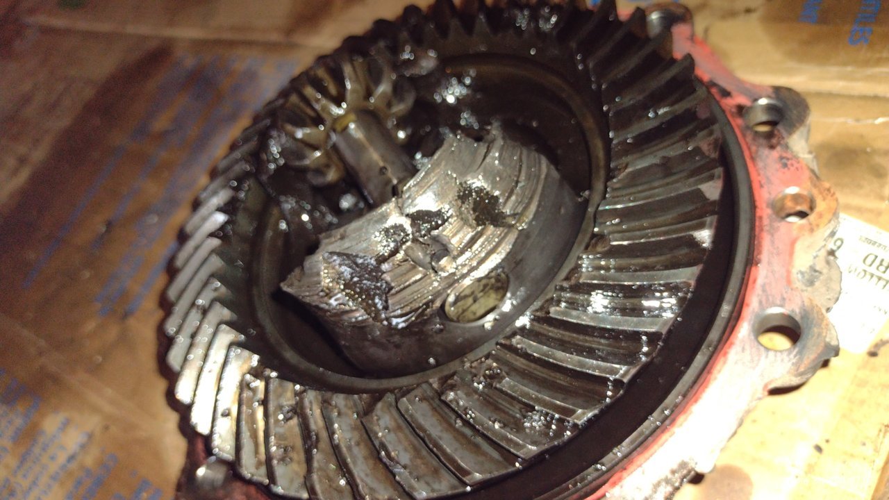

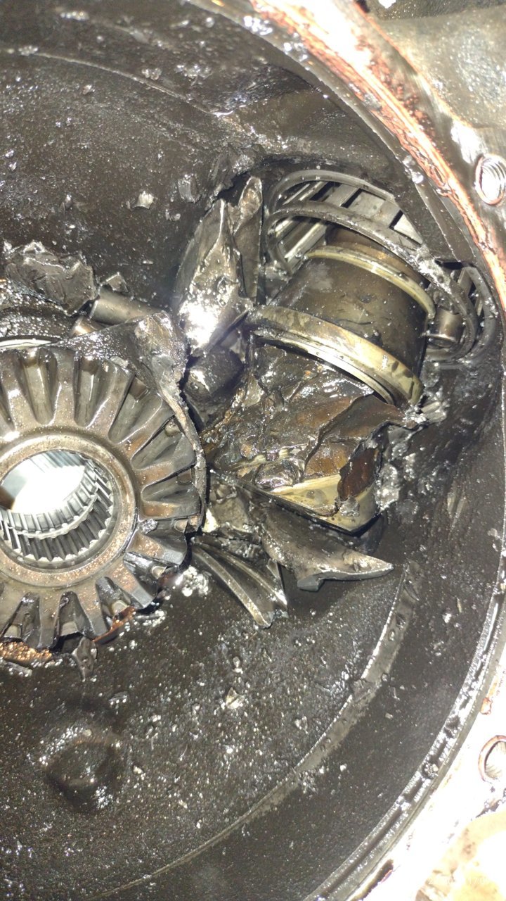

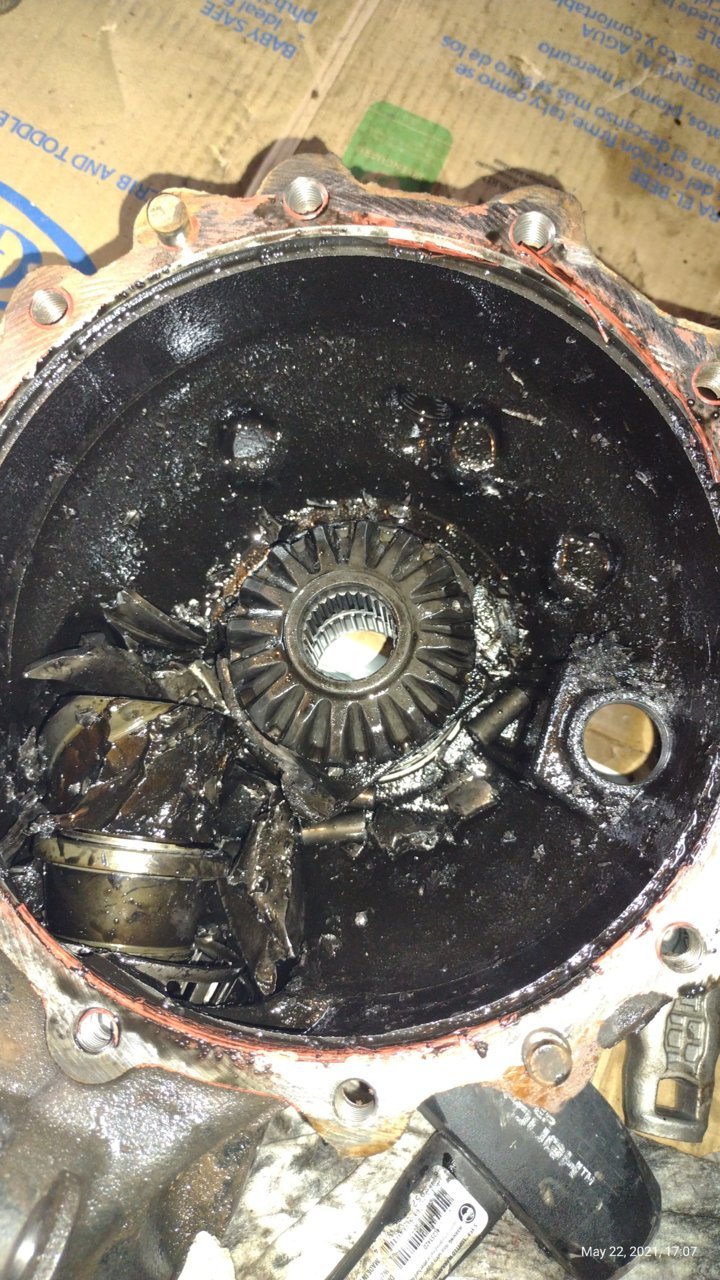

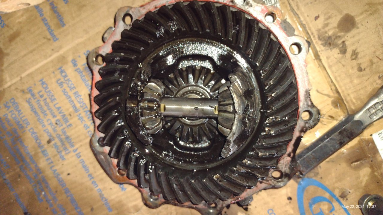

    As requested...
    IMG_20210522_170709304.jpg IMG_20210522_170720533.jpg IMG_20210522_170729148.jpg IMG_20210522_170944350.jpg

    ouch!

    I’m amazed the ring gear isn’t in worse shape than it is..

    Isn’t the maximum speed in 4WDHi is 55 mph? How fast were you going?
  5. May 22, 2021 at 5:13 PM
    #105
    Empty_Lord
    Empty_Lord Toyotaholic
    Mar 13, 2016
    #181186
    28,297
    Dan
    Northwest Indiana/Chicagoland
    To engage. Going any speed on dry pavement for a prolonged time will do damage

    You can go as fast your heart desires in 4hi, but like Dan said above me the speed limit to engage it is 55mph. Once it's in 4hi there's no speed limit

    Pretty sure we found the culprit a while back.
