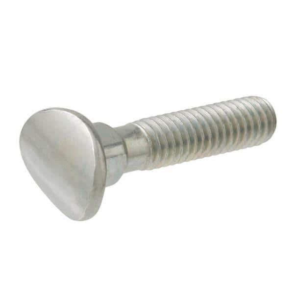

  9. Mar 22, 2022 at 6:33 PM
    Suicyco
    Suicyco Well-Known Member
    Feb 8, 2017
    #210044
    417
    14 ac 4x4
    I cant find it but there was a thread where someone used bolts instead. I think they were epoxied to the flare. The head might actually have fit inside the old clip location. Maybe have grinded it down or used special bolts like the one below. The nut inside of the fender. Kinda drawing a blank but seemed like the way to go if cutting flares and breaking a bunch of clips
