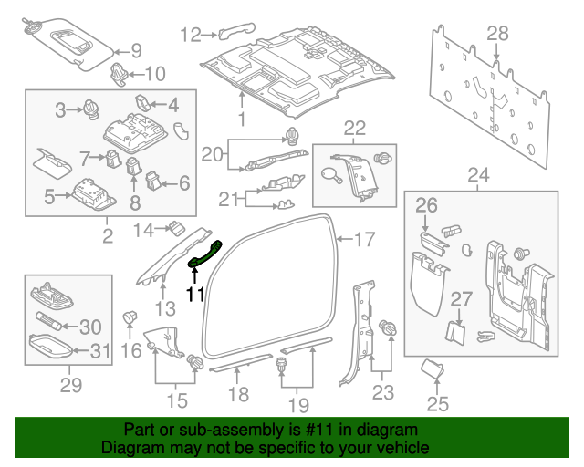

    I removed my passenger side a-pillar and can't get the upper cover back on, so I think the cover is broken. Anyone know the part number? Currently has 2 sided tape, but it doesn't sit flush so it annoys me.

    I bet you that its sold as a complete handle.

    Does it annoy you enough to spend $35 on the handle assembly? :p
    Choose between black and gray:
    https://parts.toyotaofdallas.com/oem-parts/toyota-grip-handle-7460304020c0/
    https://parts.toyotaofdallas.com/oem-parts/toyota-grip-handle-7460304020b0/

    If were talking about the same piece this happened to me. Look inside it i bet you bent the retainer clip and it folded up and thats why. Look at bottom piece then see where the two clips are and you will see which one got bent. Needle nose pliers fixed it for me pulled it out straight

    Same happened to me. I was not putting it back in right. Make sure when you push back in the two male clips line up "inside" the slots. Part # 74617-04070. Its stamped on the back.
