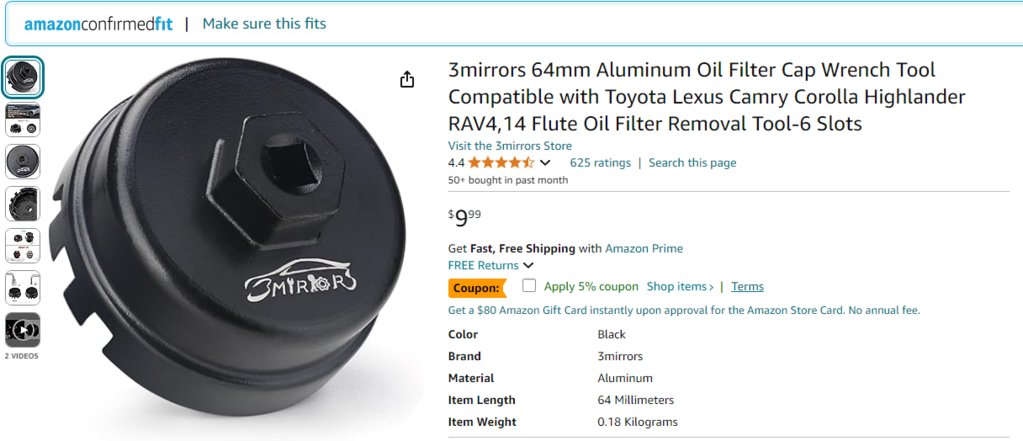

    I bought this cap wrench separate from the MotiveX kit; can't remember why? (Probably because it was cheaper)
    It's best suggested to use hex drive socket, 26mm on top of the cap wrench to remove housing.
    I was worried when I had the plastic housing because it was always difficult to remove.
    Now that I have aluminum, it's not even an issue.

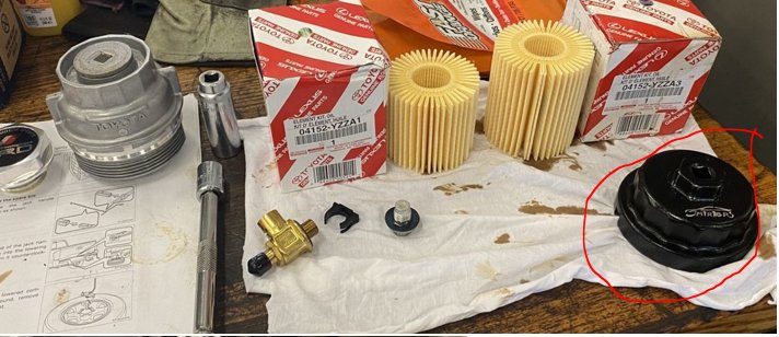

    I just finished oil changes on my Taco and minivan.
    While Taco's oil filter housing was out, I took measurments of the plastic and aluminum housings and center tubes. Both have original tubes.
    On the inside of the tube:
    Plastic 51.75mm tall
    Aluminum 51.83mm tall
    Difference of 0.08mm. Manufacturing varience
    On the outside of the tube:
    Plastic tube was 75.29mm tall, from the outmost edge of the tube to the bottom.
    Aluminum tube on the outside to the bottom was 75.97mm.
    Difference of 0.68mm. Plastic can was thicker.
    Oil filter was taller than either tube.
    In the nutshell, oil filter housings are interchangable. Do not need to swap the center tube.
    PS. Steel tool worked great to take off the housing. I used the 1/2 square hole and extension to reach thru the TRD crash plate.
    PPS added Fumoto valve with a nipple. Looking forward to cleaner oil changes. Old oil was hot and came out with super velocity. Splashed everywhere.
    Managed to put in and tighten the Fumoto valve without taking the crash plate off.
