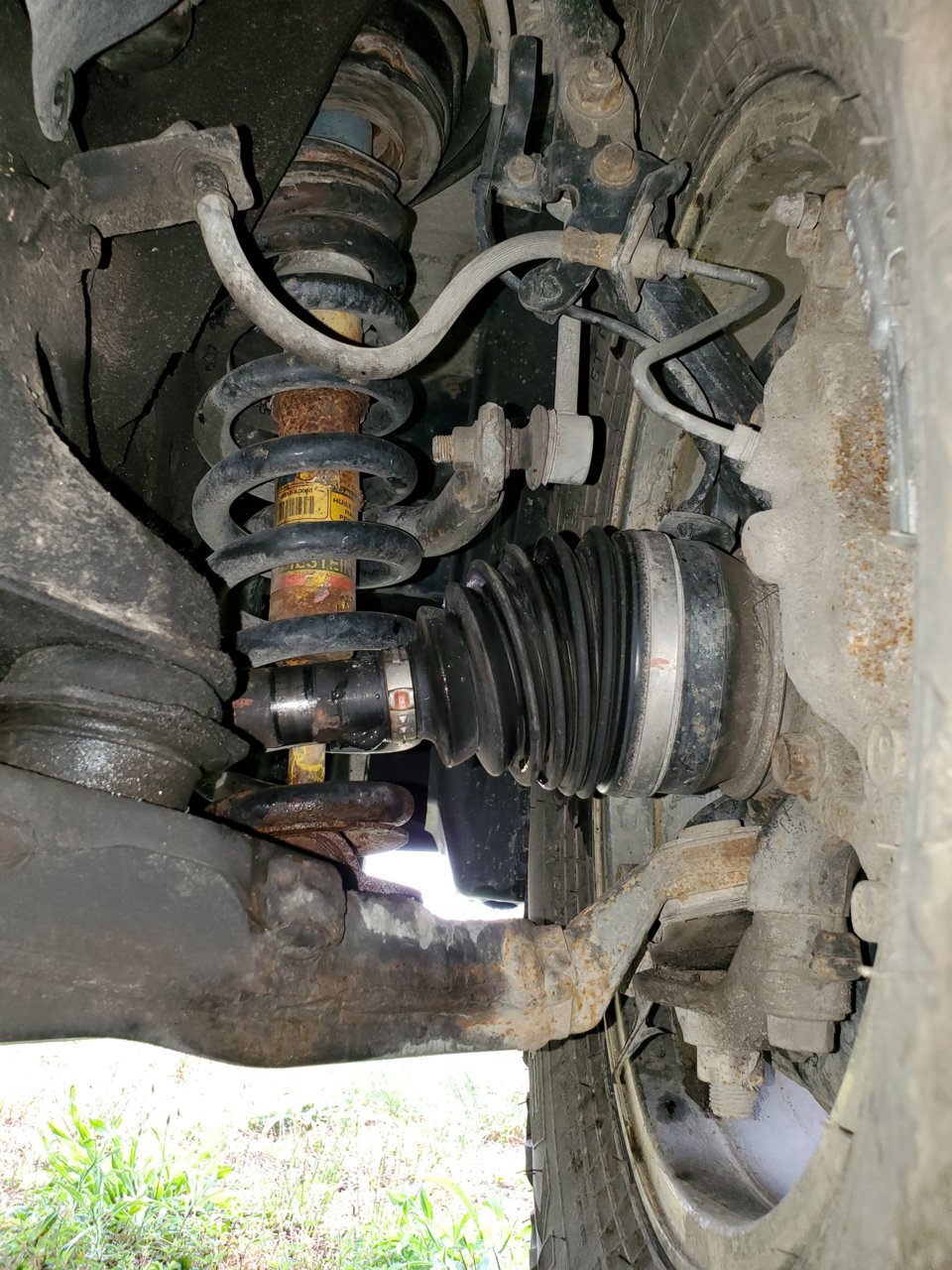

    I almost wonder if it's a strut? I'm not too mechanically inclined with suspension components.

    Yeah, the coilover is toast. Maybe someone nearby has some stock take-offs they can get you?

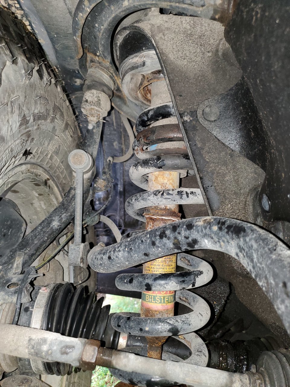

    Looks like your lower spring perch gave way. The coil spring should NOT be that low.

    Your lower perch sheared clean off!

    I see lift spacer pucks up there. Possibly the root cause of said failure. Also, looks fairly rusty. Could be material failure do to an undercut/rusted out spring perch. Probably both in conjunction.
