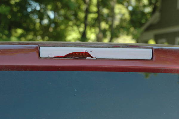

    Anyone ever repaired/replaced the 3rd brake light on an A.R.E. cap? Besides being all faded to looking white, it is broken.
    I would think it would simply pop off, but, the damn thing is so brittle and seems like it is glued in?
    Anyone else had anything like this?

    Mine was screwed and glued. I removed the screws and used a razor blade to cut the silicone. It then slid out. Contact an ARE dealer and have them give you a price on a new one and just replace it. If you don't and it is cracking, it'll be leaking in no time. Save yourself the headache.
    http://www.4are.com/dealers/locator.php

    I guess that's my only choice I was hoping there was an online source for these things.
    I know when you walk into the ARE dealer near me, they are ridiculously high on parts. Even the smallest parts.

    Here's a generic one I found on eBay, have no idea if it would fit though.
    11.5" Truck Camper Shell/Truck Cap LED 3RD Brake Light
    eBay Item #: 220768313790

    subbed, 1/2 of the LEDs in mine are out and I would love to fix that! The white cover bugged the shit outa me too ever since I got the truck so I rustoleum'd it red to match.
    I haven't noticed any screws on mine, looks like its just glued into place

    Bringing this thread back, hopefully it can help someone here.
    My (used) topper I bought a few months back had about half the LED's out on the 3rd brake light. I found these guys online, not sure if it will work for your application. I bought their 3rd brake light / interior dome light combo for $49 and works perfectly. Local dealer wanted $89 ?!!! Screw that.
    I'm fairly certain that a lot of the topper manufacturers use the same vendor for their brake / dome lights. My particular shell is a LEER 100XQ
    http://www.truckoutfittersplus.com/store/topper_parts_dome_lights_brake_lights.htm#brakelight

    Replying more for archival purposes since this thread seems pretty old.
    The 10" LED light bar on my A.R.E. cap expired and I had to pry it off with a screwdriver. It had been affixed with some 3M tape that was a bear to get through --wound up chewing up a little of the paint in the process. The strips were only along the bottom, not the back.
    I haven't found any matching online, so I will check with the A.R.E. dealer tomorrow for what is likely a $80 replacement part :mad:.
