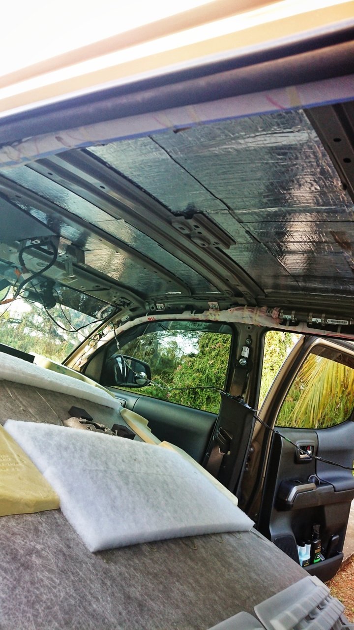

    While you have it out, you should consider installing some sound deadening material. If i ever pull mine down, thats what I would do before putting it back up.

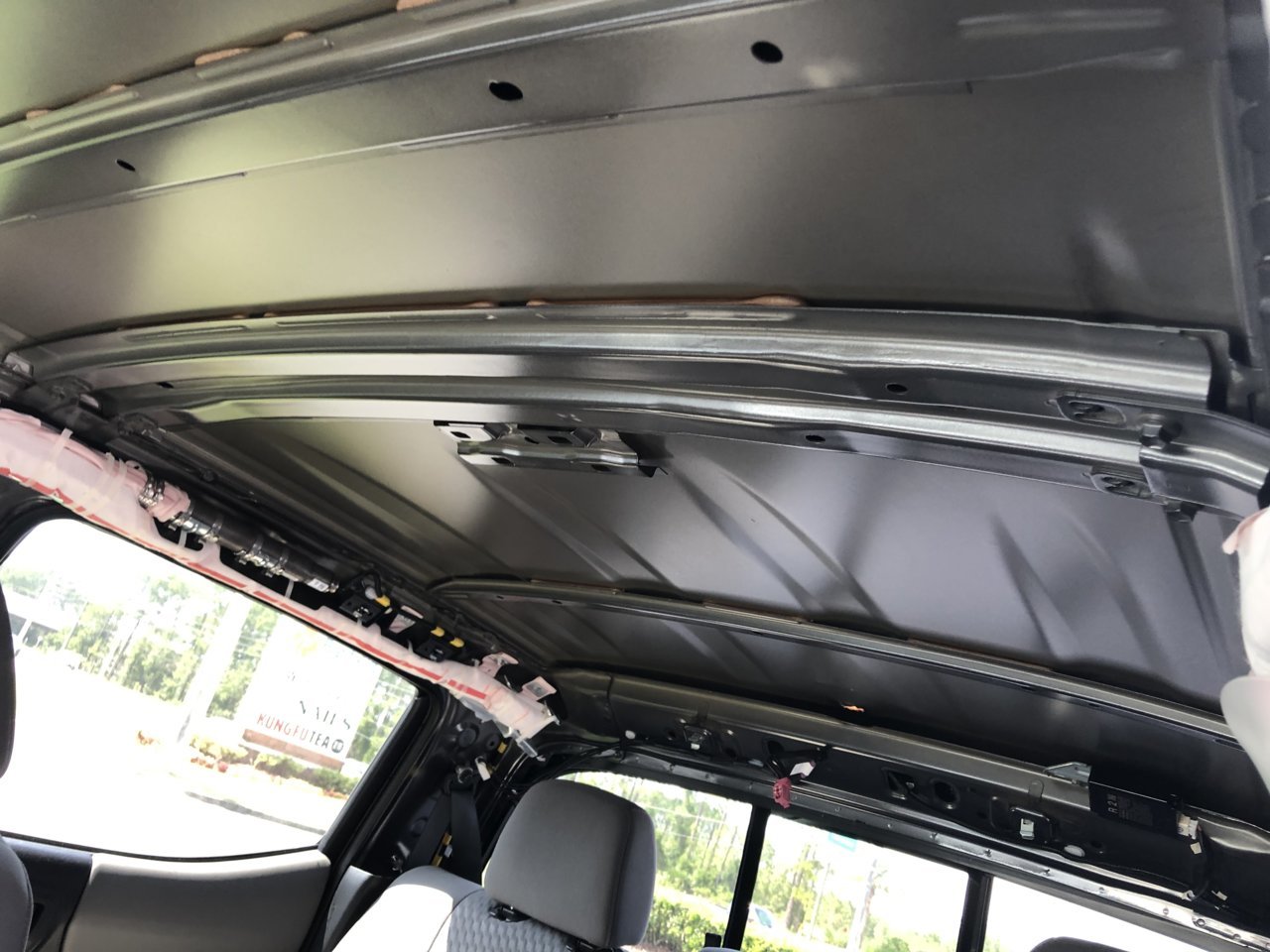

    Here’s a couple pics...

    Wow. If it was my Taco, I'd jump on the Rhino Tracks also along with the sound insulation. LoL!

    Also get some thick CCF, OCF, HMF and/or Fiber Insulation (3M Thinsulate). Great way to improve heat insulation, cool in the summer, warm in the winter.
    Did the install on mine, don't hear the rain anymore.
    There is also a layer of 150mil Closed Cell Foam, but I forgot to take a picture...

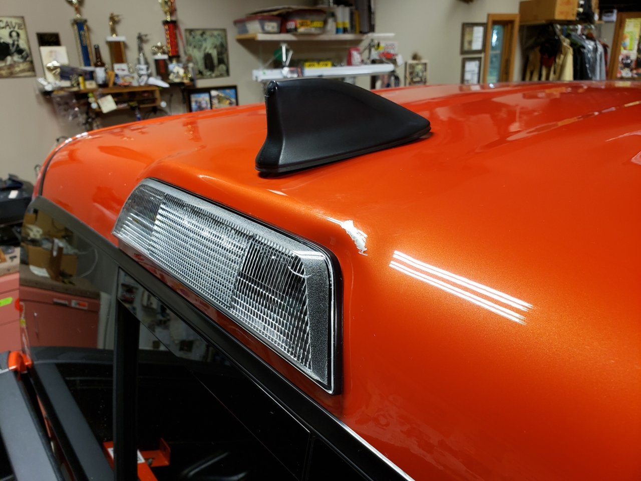

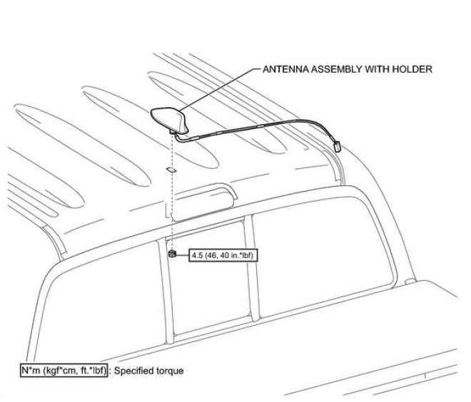

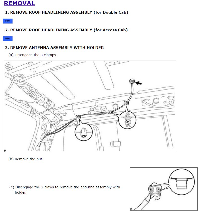

    20200914_141905_resized Antenna.jpg I'm old please don't beat me up now. I had some minor damage to the roof antenna mount sheet metal, antenna still works fine after hitting bottom panel edge of garage door, it moved! Now I have slight panel damage and cause for repairs. I'm ready to remove the antenna from mounting nut inside and the rear cargo light assembly also. Removed most all of the panels, door seals, seats & belts, and remaining restrictions. Headliner remains installed with factory moonroof forward. I have enough room to remove the nut on Antenna but no idea on disengaging the 2 claws is my problem, I need advice and would sure appreciate it. The picture drawing is where I'm unable to relate the disengage process.

    Did you get this figured out? Don’t see the picture drawing you referred to.

    Yea there is, i saw a TSB for it on another post. They just remove the rack...
