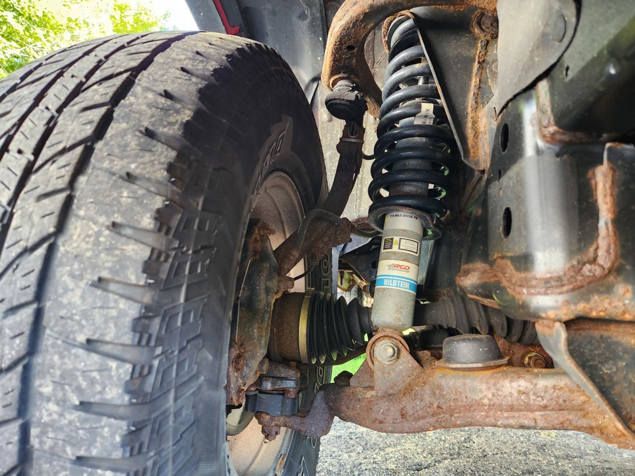

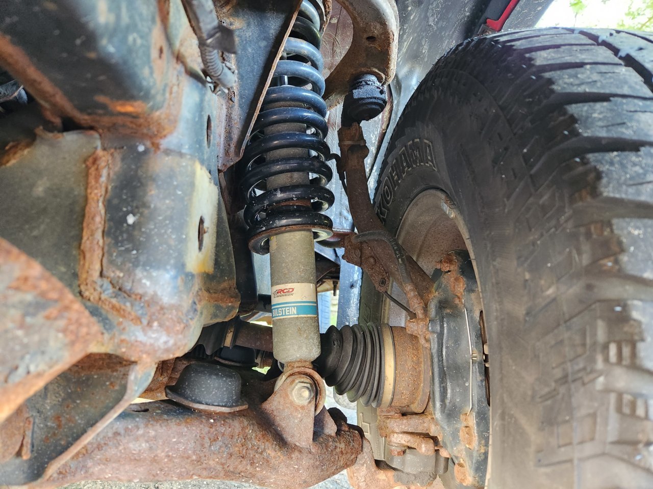

    This is the passengers side from the front.
    The video I took is of both front axles where they meet the diff. There is a lot of play and an audible knock from the left side when you apply any force up or down on the inner joint.
