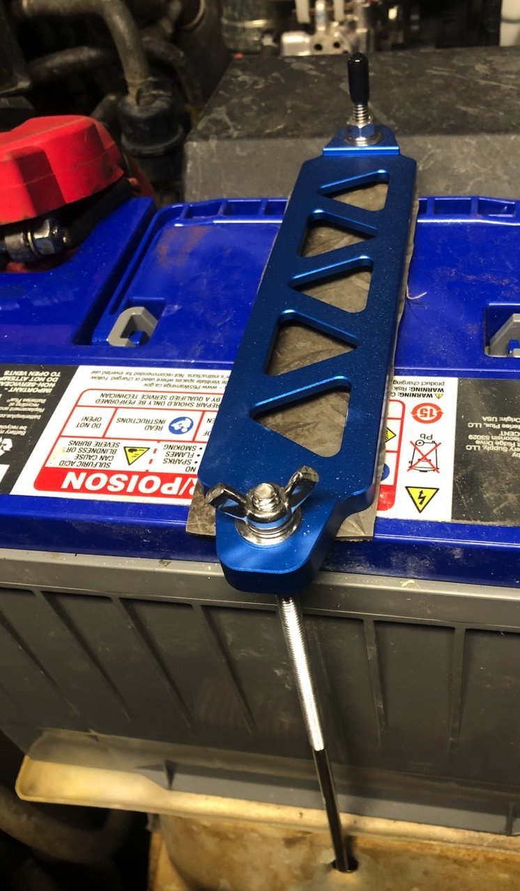

  12. Sep 2, 2023 at 9:40 PM
    BKinzey
    BKinzey Well-Known Member
    May 5, 2016
    #186211
    1,512
    Beauford
    Hollywierd, CA
    2015 White Tacoma Access Cab TRD Off Road 4x4 V6
    RCI aluminum front skid, SnugTop, Sliders, bedside supports, LED interior, CaliRaised fogs & brackets, rear diff breather mod, DIY bed platform
    So, it arrived! Funny, could see tool marks in the Amazon pic but there aren't any on the one I got. Looks quite nice really.
    First mistake, I got the blue one, I wanted the black or silver but I forgot to change that. My bad. :anonymous:
    Then I decided to follow the OEM style as they give you 2 wing nuts and 2 regular nuts. I put both regular nuts on the farside. That side takes a shorter bolt so after figgerin' I cut about 2" off of it.
    Looking at the bar itself I think the design is funky looking. I don't like seeing the depression, so I installed the bar upside down. I think it looks better. Thinking this greatly reduces the surface are of the aluminum clamp on a plastic cased battery I cut a strip of filthy dirty gray vinyl diamond plate flooring I had laying around to act as a gasket. This caused me to use every inch of the retaining bolt with the wing nut. I think it will be good.:rofl:
    :fingerscrossed:
