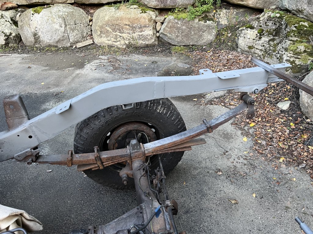

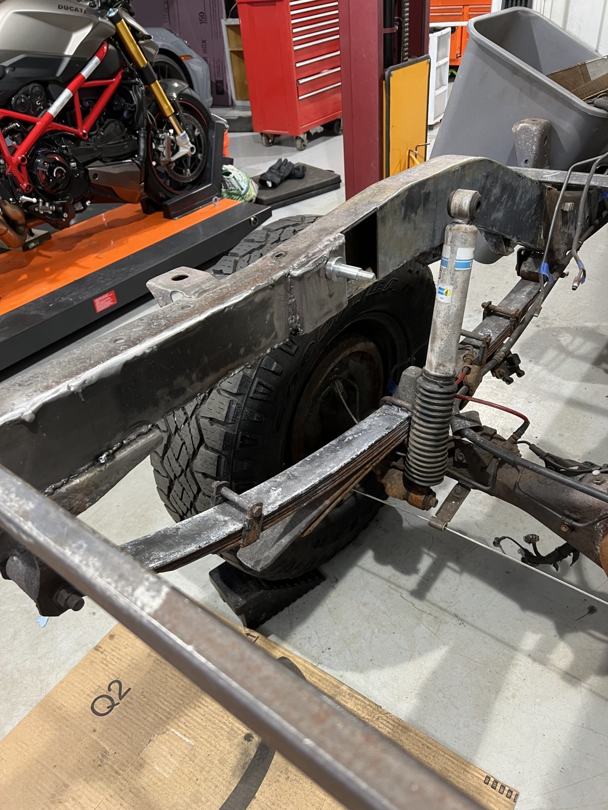

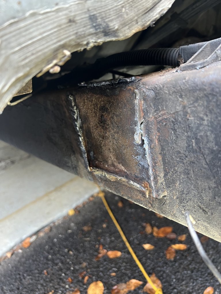

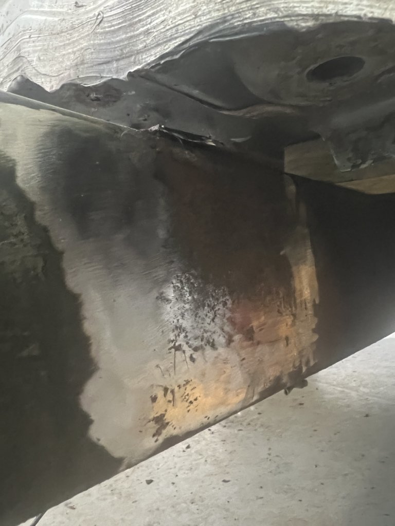

    Haven’t posted in a little while. I made the decision to repair the damage to the frame and then to do box in the rear part of the frame. Here are some shots of the driver side. Still need to some grinding and work with a flap wheel, but it’s getting there. I bought the shock mount from Safe-T-Cap.

    I didn’t take very good photos but what I did was cut out all the rust damage and the weld in a 1/8” plate. Then I reinforced the frame rails with 1/8” plate (top and bottom) and then boxed it in. I was inspired by this guy called “PostRT” on YouTube who was dealing with the same rust issue in Michigan.

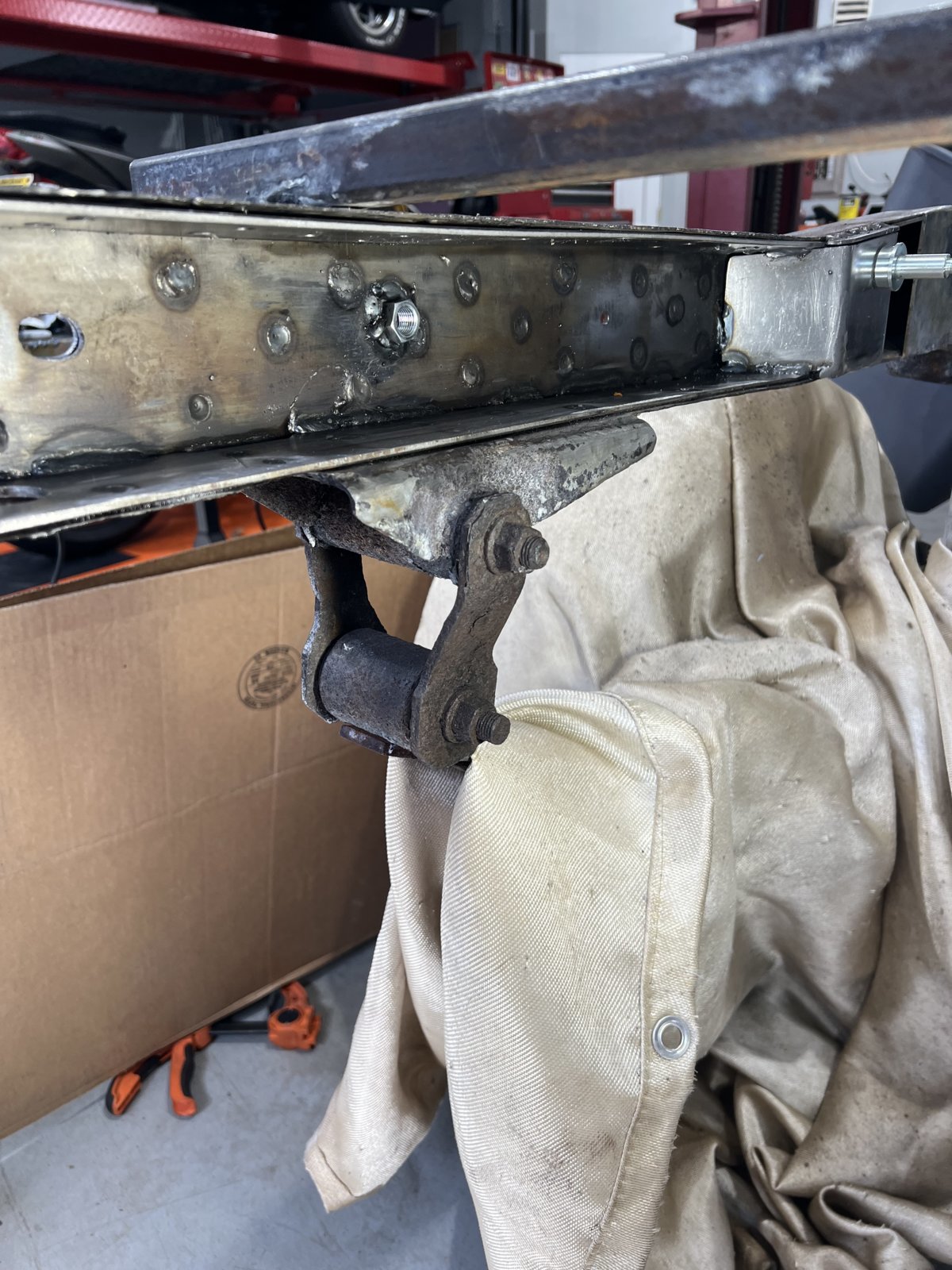

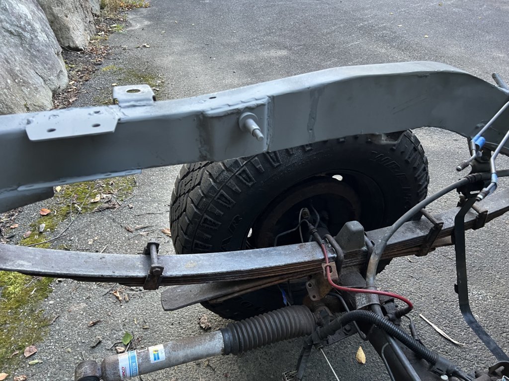

    A couple of more photos. I’m finally getting to end of frame repair, and am hoping I can get the new body mount bracket in tomorrow.

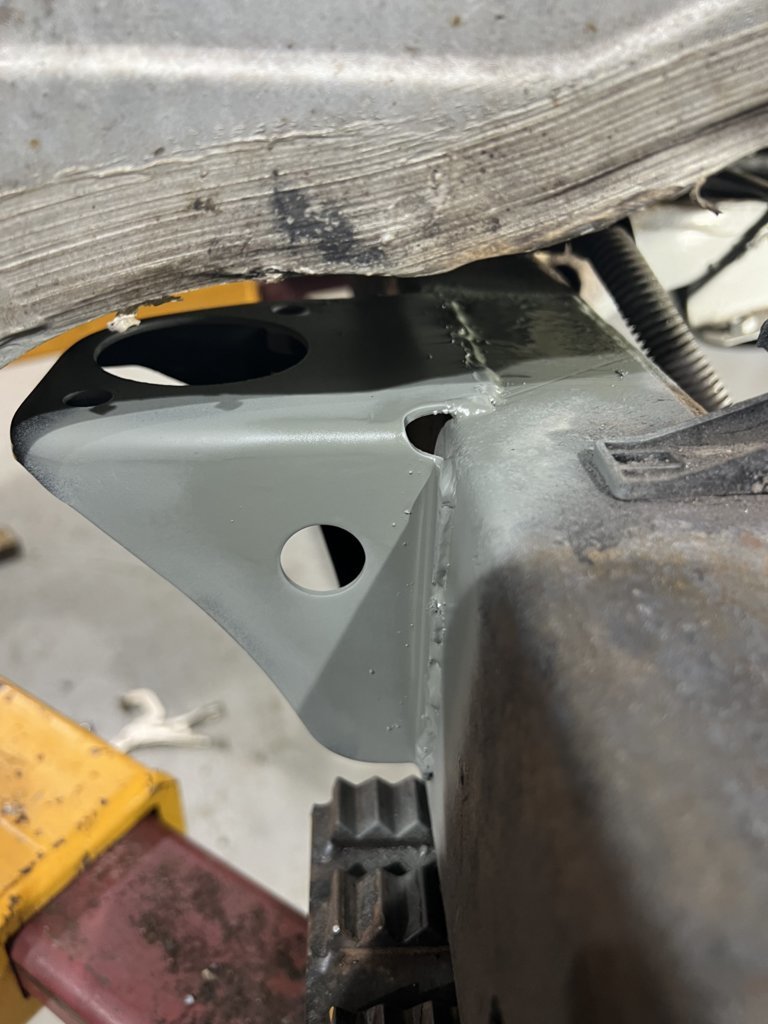

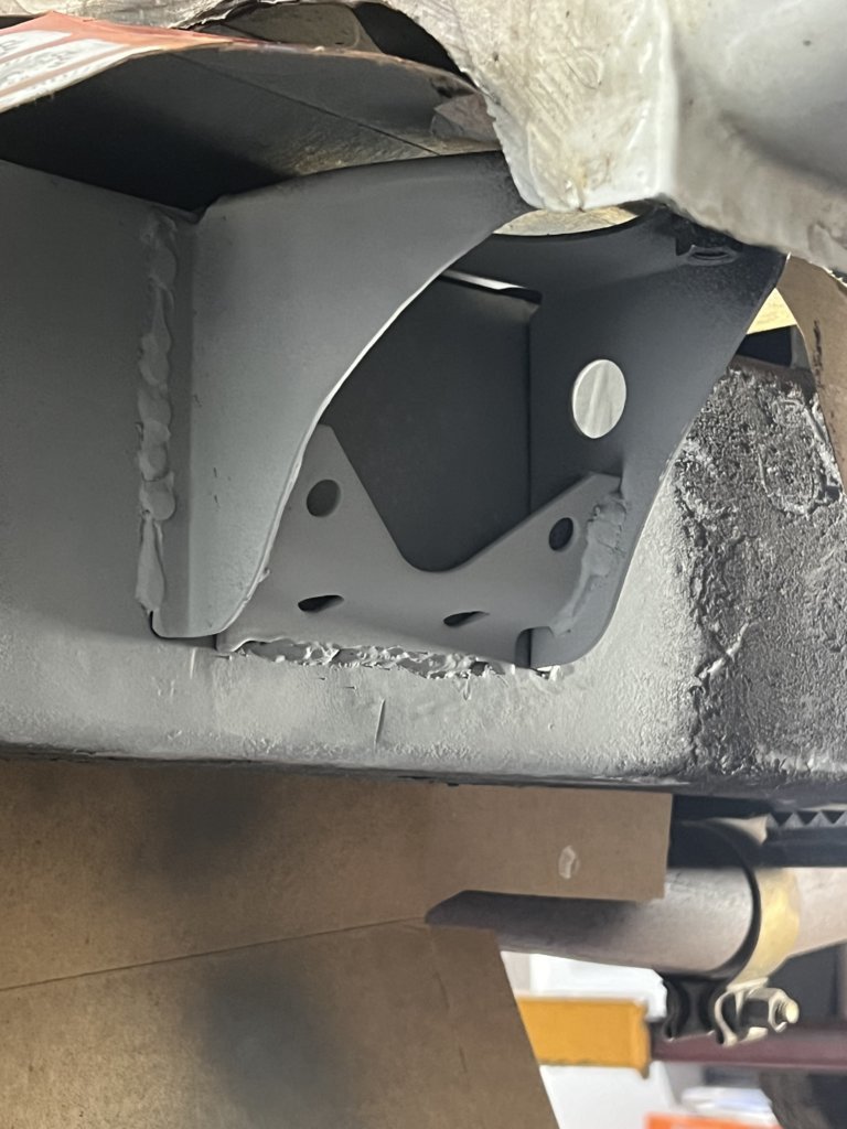

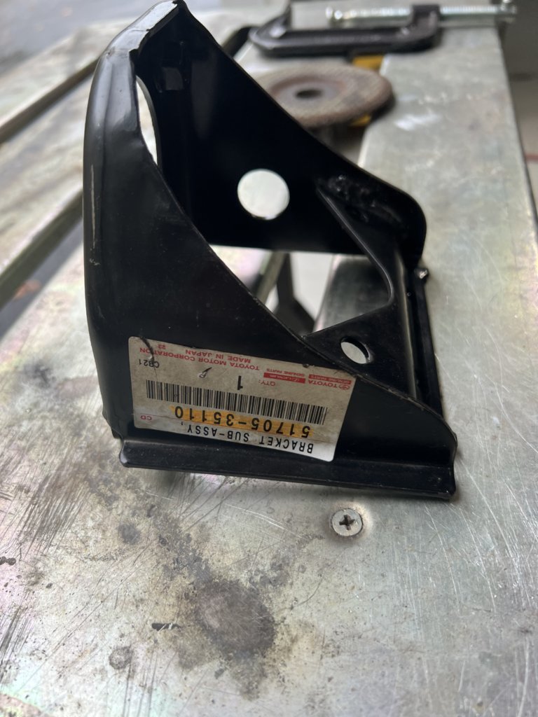

    I got the new rear body mount bracket welded in today. I decided to change all my body mount bushings in the process and in doing do, found out my driver side rear mount was just about gone as well. I had bought all 6 new mounts so I just cut that one out as well. IMG_4803.jpg IMG_4805.jpg IMG_4806.jpg

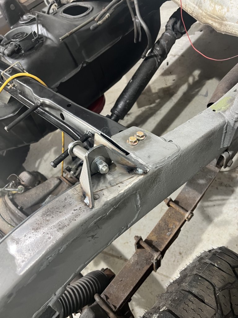

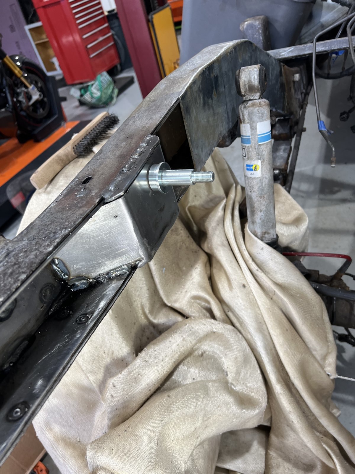

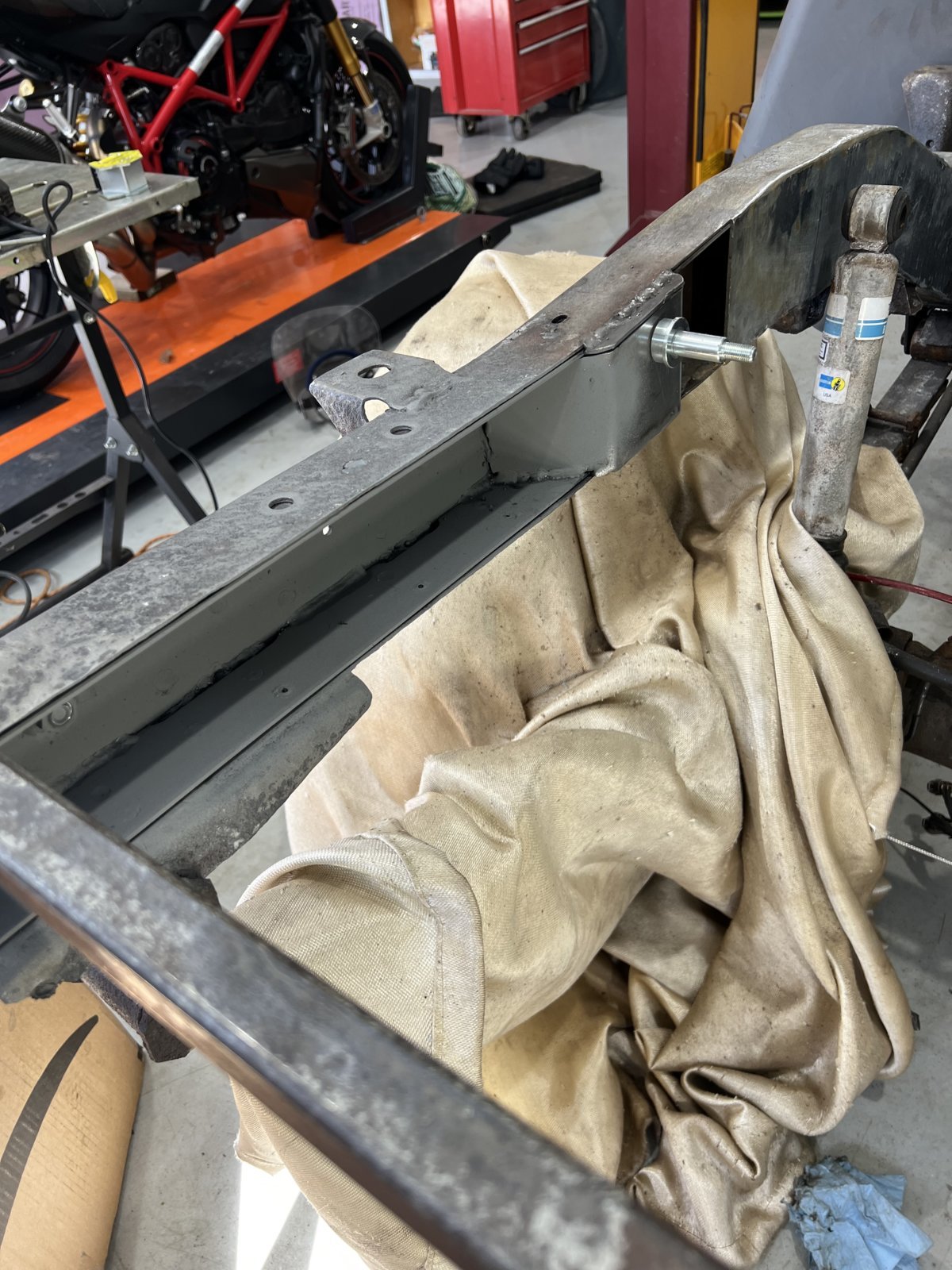

    Made some progress this weekend. Got all the body bushings replaced (except for the middle one on driver side). Replaced both rear body mount bushing brackets, tack welded in the passenger shock mount, and got gas tank mounted. It’s starting to look a little bit like a truck again. You can kind of see how I had to shorten the gas tank crossmember to fit between the boxed frame rails. I welded in some mounting brackets for support. I’ll hopefully get the shock mount fully welded one night this week. I need to purchase one of this riv-nut guns do I can mount the rear proportioning valve. I’ll take some pictures tomorrow.
