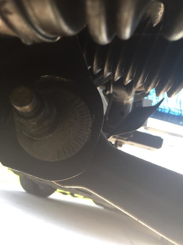

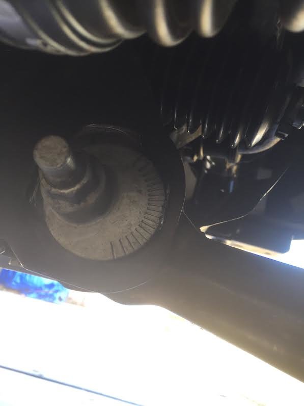

    pics showed up in my email finally....sorry about the quality....
    Before the wreck
    After the wreck
    It's hard to tell but it's flatted out now where as before there was something for it to but up against.

    Hopefully the bolts aren’t siezed. Control arms could be worn out too.
    looks like your cam tabs flattened.
    You could cut them off then weld on new stronger TC cam tabs.
    Or bend them back and lay a bead.
    Marlin reinforcements might fit added to the TC tabs.
    All of this is relatively cheap compared to pivots.
    And makes sense to do on a known weak point.
    never makes sense to me when trucks get $7k suspension on stock tabs/mounts like building a house on foundation of styrofoam.
