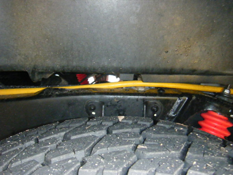

    Time to break out the tape measure to see where the problem lies. Measure from the mounting bolt centers to the center bolt. Maybe you got a bad leaf? I doubt the frame is bent.

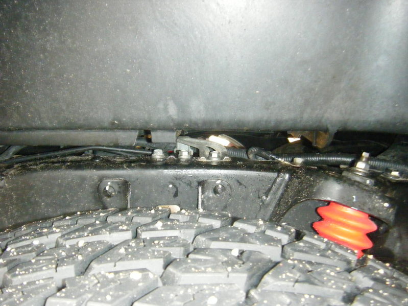

    F#@* me, it might actually be the frame...look at these pictures. the first one is of the left side of the truck, and the second one is of the right side...look to the left side of the second picture(rear of the truck) it looks like there is a ripple in the metal. please tell me it's supposed to look like that

    I'm afraid that does not look promising. :(

    Yeah.....that should be flat. :(
