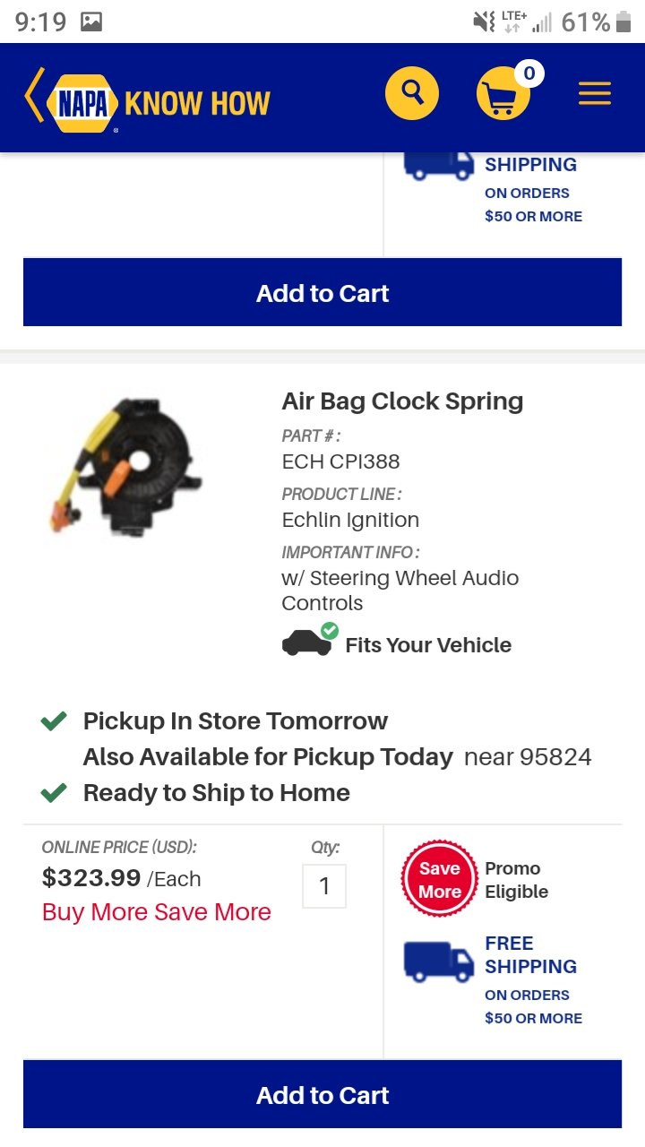

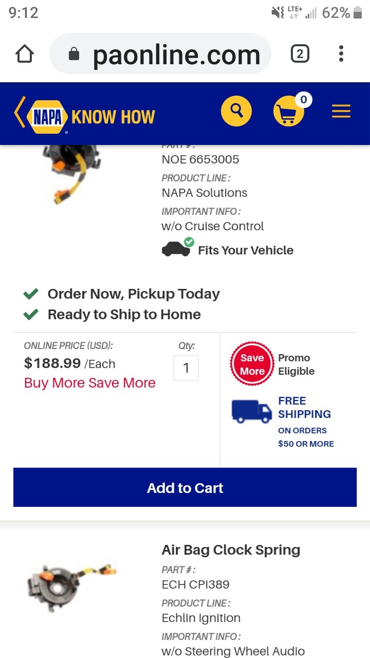

    I'm sorry one last question lol. How come on Napa's website there are 4 different options to choose, one with or without cruise control and one with or without audio controls?

    Screenshot_20200325-091238_Chrome.jpg 2 are napa
    2 are echlin
    Fixed it...
    1 cruise
    2 no cruise
    3 cruise no audio
    4 cruise w/audio

    Youre going to want the one with audio
