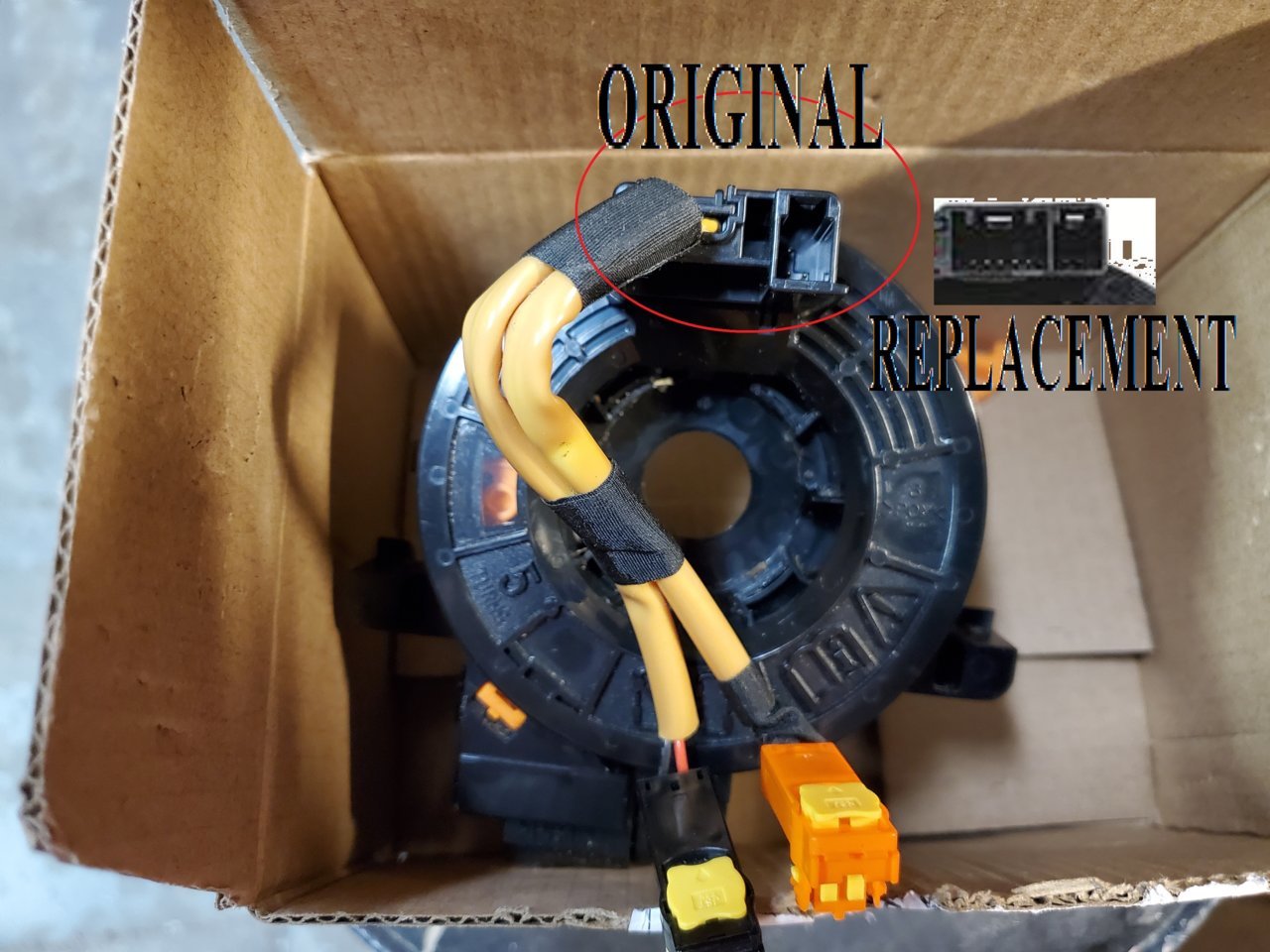

    I am looking for help with a clockspring. Our 2012 SR5 V6 AC cruise quit and I am hoping it is the clockspring. The problem is that the dealer used the vin to provide a part number. The part they said is listed for my vin, pn 8430604080, is not with cruise control. The truck has factory cruise control thus why we are replacing the clockspring. Not buying from a dealer but want to make sure I get the correct one. Truck has cruise but does not have steering wheel controls. Another question is can we use one made for steering wheel controls without using the swc socket. Thanks for any help.

    I went thru 4 dealers today and every one gave me the same 04080 part number. Being a transition year model it may be different. I found a 04080 for $11 shipped. The picture shows the cruise connector pins. When I install it then I can compare the original to a 0E010 before I buy one. For $11 what do I have to lose. If it lasts 6 months then it pays for itself.

    Installed the $11 pn 8430604080 from Walmart today. Works fine. Cruise is back. Separating the angle sensor was indeed a bitch. There are 2 holes in the sensor to align the clockspring plastic pins. Broke half of one of the molded holes off the sensor. Fortunately there was enough radius remaining to maintain the alignment with the 2nd aligning pin. Scary at first though. All good. Very happy for $11. The actual pn on the box, from Bapmic Auto Parts Inc, was A0153A0002. It did have the pin connection for steering wheel controls that we don't need. Looks exactly like the 0E010 clockspring.

    Yeah that's the problem with aftermarket clocksprings - they last 6 months to a year, then you'll have to replace it again. Think the steering angle sensor will survive another swap?

    For $11 I will do this every 6 months if needed. Truck is nearing 160k so may not have it another 6 to 12 months. The sensor will be fine if need to swap again. Next time will slide small shims under each locking tab, to hold each one open, instead of fighting and pulling to separate it. If it was my 2008 with only 84.9k miles I would go all out and spend $40.
