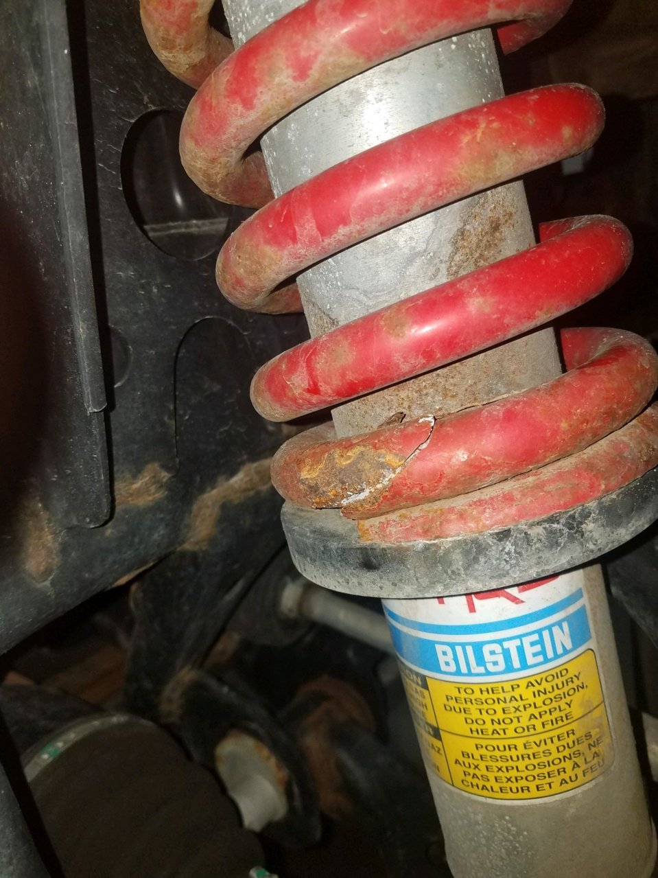

    Where is the "is it surface rust? Yes or no" option on your poll?

    That spring has been broke a while for there to be that amount of rust in the broke area. If that was recent, then you should see clean steel with maybe some minor rust where the crack originated.
    Rust is a factor. Looking at the picture, you have rust scale coming off in chunks.

    yes it is
    The rust inside the break looks worse due to the jagged surface of the metal. The rust on the springs is purely surface rust, but the shit has been broken for several months and is eating the stuff inside the break.

    Agree with original poster... Looks to me like a stress fracture caused by the end of the spring creating a stress riser where it's not tapered, then the rust came after. That bare uncoated metal on the inside of the coil can rust quick.
    My dad's tacoma with TRD had almost the exact same failure, sure a little surface rust but you can see the metal on the inside of the stress fracture is clean. Look at any spring on any old car, it will have surface rust (esp if you live in Michigan). That's absolutely no excuse for a spring failure! And this 60k truck has barely seen a pebble. Bad design.

    I had one break, too. It happens. This Emu only had 10k and no wheeling before it broke.
