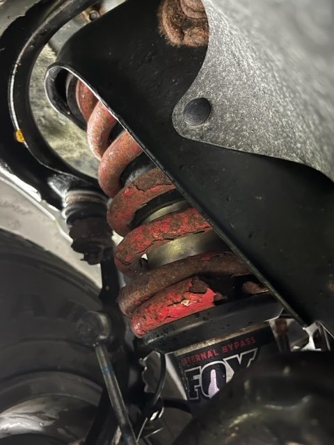

    Found some pieces from my front driver side coil spring under my 2018 TRD Pro recently. I searched online and discovered this website and pertinent thread about this issue. Sad to see that this appears to be a common issue with these coil springs! Luckily I have an extended warranty which I've been advised will cover everything except the cost of a new alignment. However maybe a law firm would take up this case to explore a class-action suit. Siskins, a London Ontario Canada firm just recently reached two landmark settlements worth millions against several auto-parts companies over price-fixing. So maybe there is hope!

    The spring broke because of excessive rust,that's not the manufactures fault.

    Excessive rust yes. Why is there excessive rust? Due to the red powder-coat paint? I've owned several trucks previously with much more mileage than this Tacoma. None have had the coil spring deteriorate so rapidly, in fact not at all. Looking at this thread, others have had the same issue.

    If you haven’t already, check to see if your frame is showing signs of rust forming. The through-bolt for your UCA in the picture looks rough
