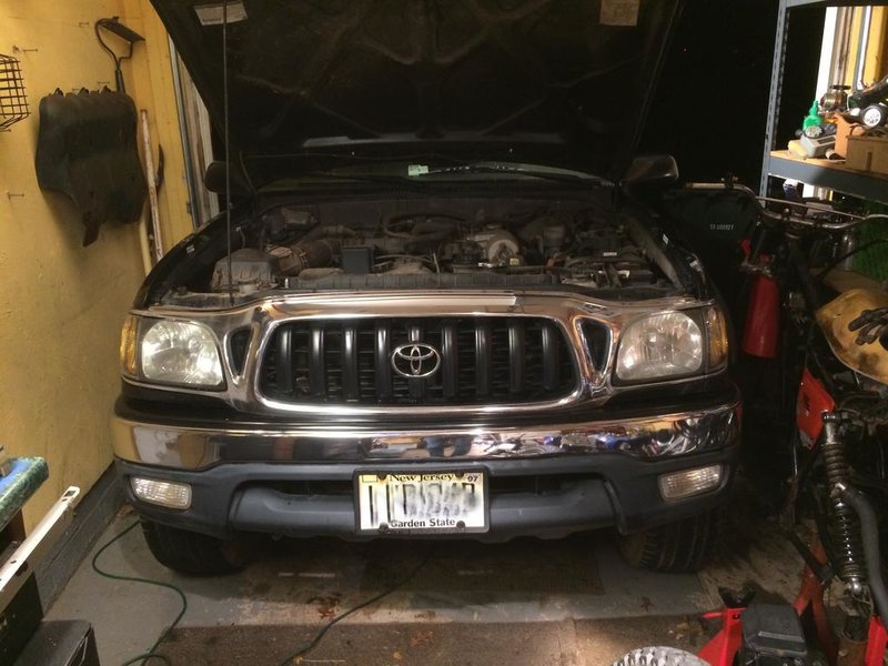

    Yea I'm pretty confident it needs a rebuild but I'll probably take a look sooner or later I was forced to drive it to school today so I'm wearing it out even more. Work starts this week so well see how we do

    Ok so yes it's been awhile and I haven't touched the tacoma it's just been sitting in the driveway waiting to be fixed, I've been busy and wanted to get the xl done first but now I'm gonna just start it. Apparently I have a lot less space to work then anticipated. This is tight but I think it should be pretty comfortable to work in and I'm gonna clean out as much as possible to make space. I'm guessing I need some space to pull the motor so when we get there it'll go outside. I want to start tearing everything apart this weekend and get the motor nice and open ready to be ripped out...

    It's gonna suck to work on it in that space. Valve seals don't go bad in a couple weeks.

    The con rod is beating on the crank there is nothing left of the bearing. The rod at a minimum is going to have to be machined and the crank turned. It will also need the top end done or your just putting an expensive band aid on it. If you put big money into a high mileage truck it will go the the bone yard with a good engine in it instead of a used engine that will probably out last it.
