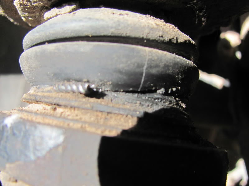

    ok so i was looking under my truck today and i noticed something that didnt look good.
    there is a rubber piece (dont know what its called) on the end of my suspension arm that is broken and it looked like it previously had oil inside of it.
    any help/advice you could give me would be much appreciated!

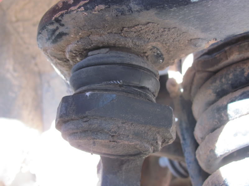

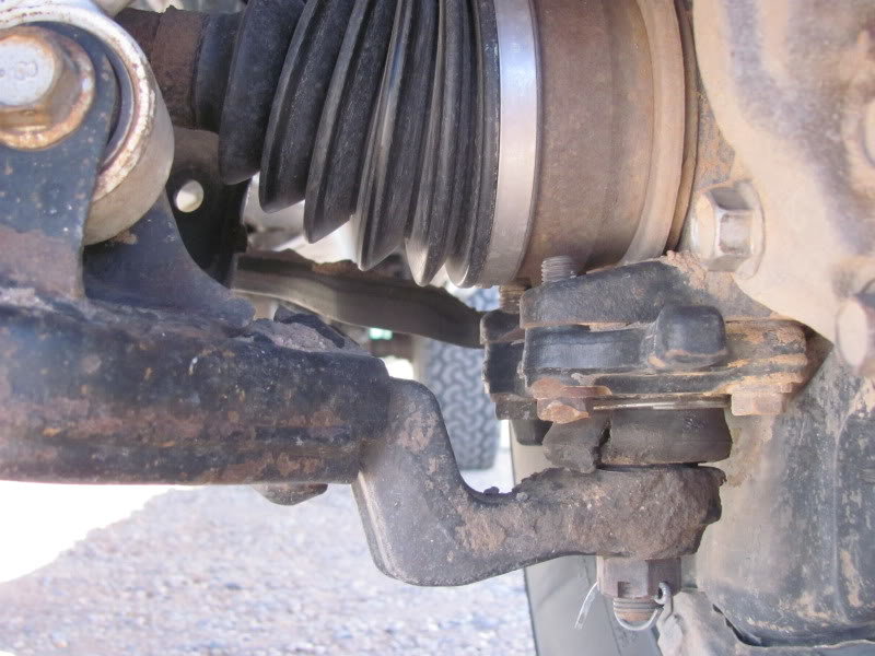

    i also found some more broken and leaky rubber pieces on the suspension

    ...too much shit to list.
    You need new ball joints.

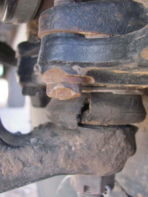

    bunch of crap
    new lower ball jooints, uppers and tie rod ends dont look bad

    What happened to that bolt!?

    Probably dropped onto a curb or something.

    Ugh a broken rubber is always bad...get that fixed....

    just wondering how much miles you have on it? and x2 to new ball joints

    Check your local toyota dealership to have your vin number looked up, you might get a whole new lower ball joint Assembly for free.
    I did.

    Don't need to replace shit just because of torn boots. If there's play in it, then yes.
    They will wear faster and develop play (wear out) sooner because of torn boots but don't replace your entire front end over that.
