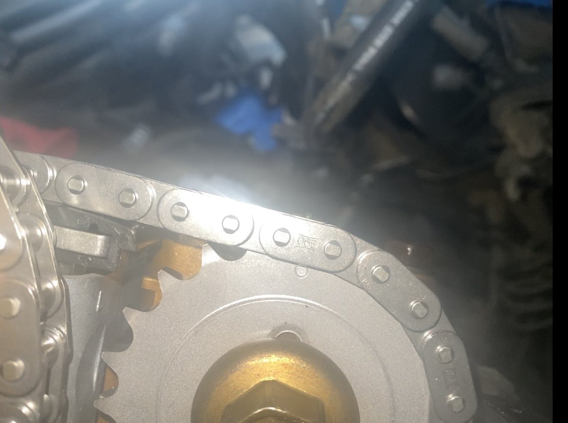

    If you are not replacing the sprocket and already replaced the key, do not try to remove it. Why potentially create another problem.
    Do you have any other pics of the camshafts head on as opposed to from the top? From your pics it looks off ever so slightly.

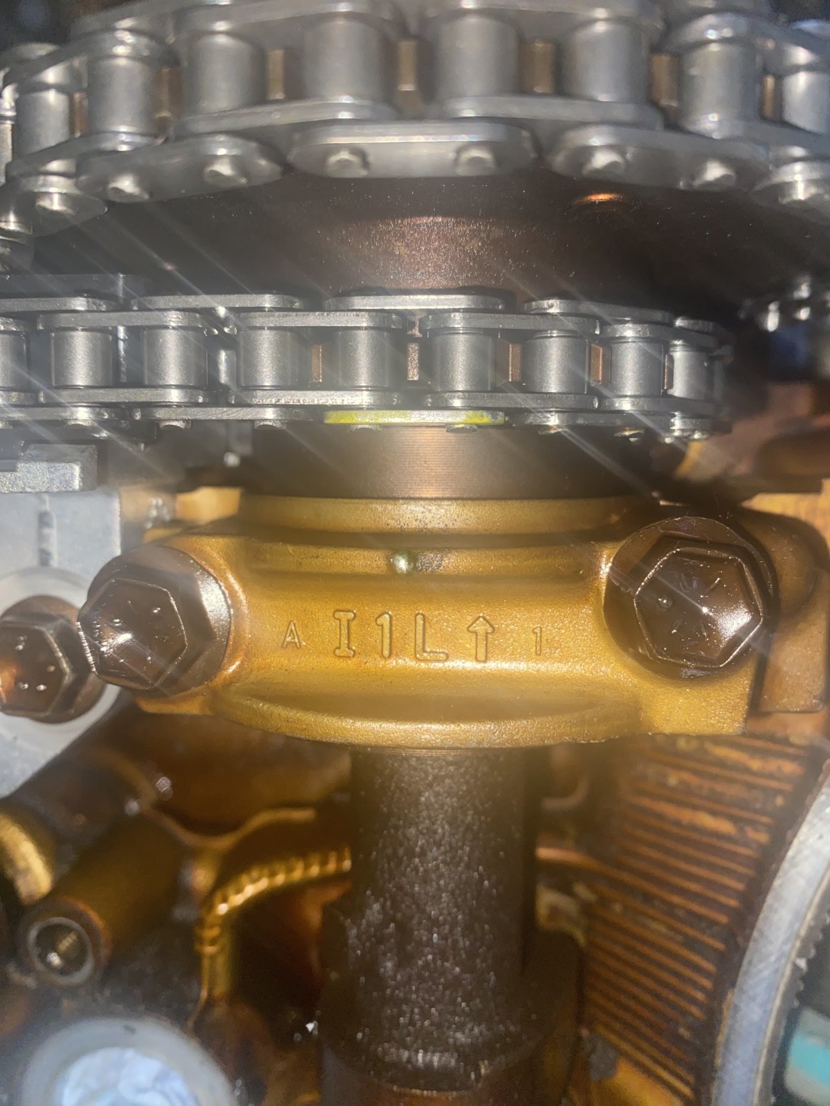

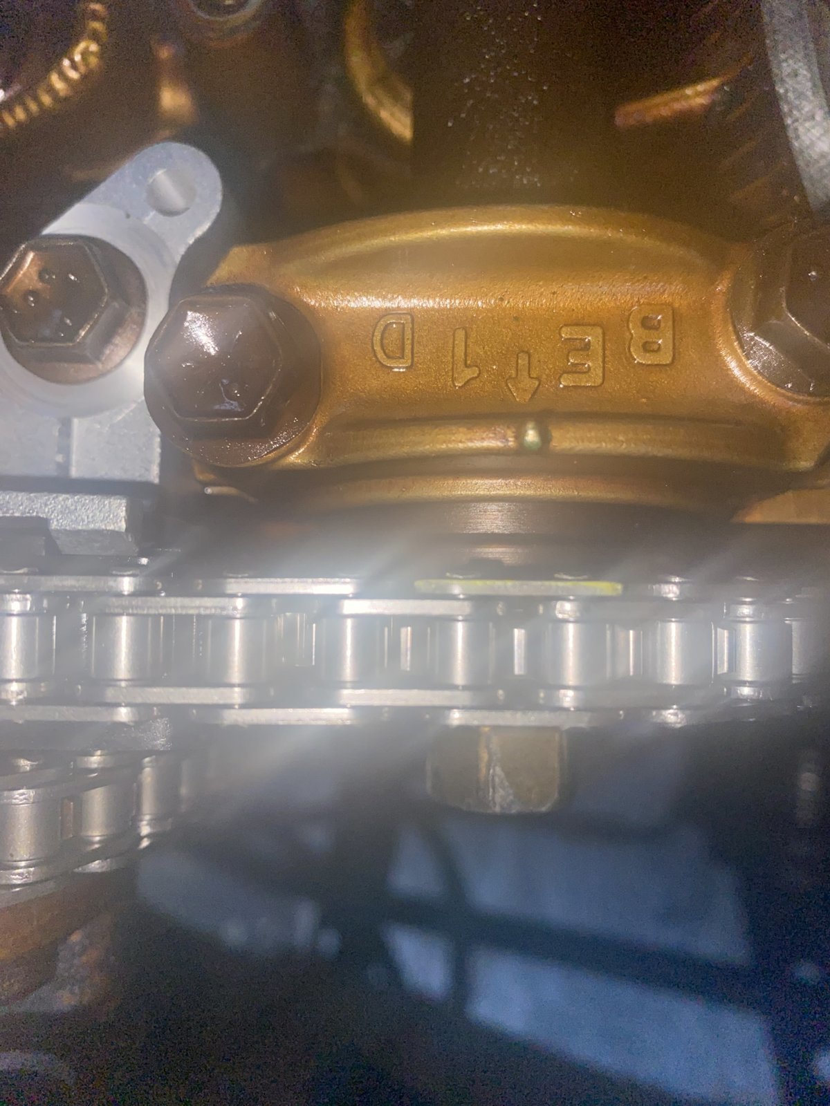

    Here are two more that kinda show what my eye sees when I’m looking at it. Yeah at this point I’m wondering how much off is okay?

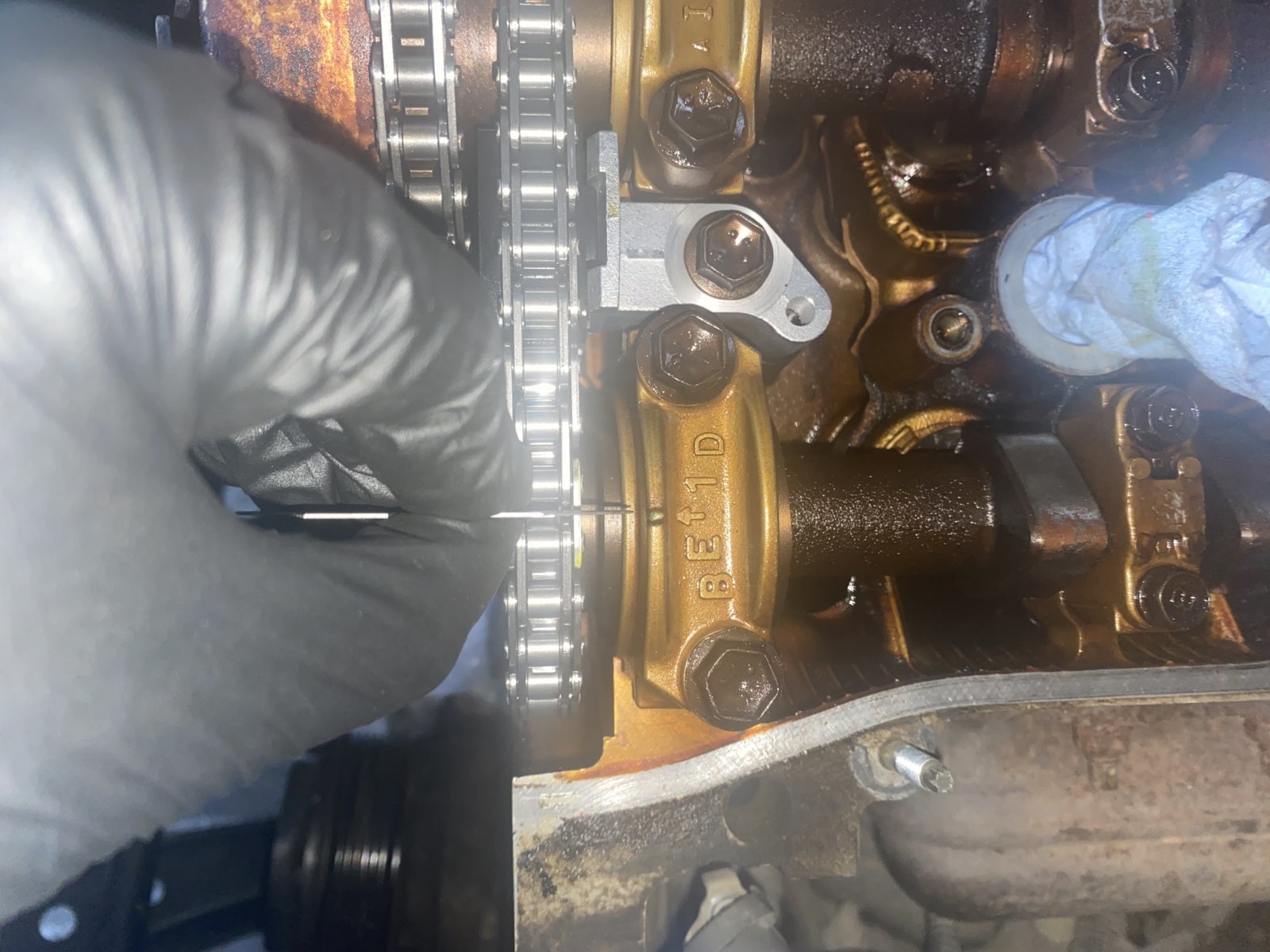

    This is a good angle too

    Maybe I’m just tripping but it bothers me, I might not have a choice though

    Think about it in terms of gears
    Has it moved enough to be a tooth off? No? Then send it

    No I’d say MAYBE a quarter tooth

    Hard to tell if it is off from the pics. I bet if you wanted to put a crescent wrench on either of the banks cams it would move the gears ever so slightly to ease your ocd.

    If you are off by a tooth then it’s a problem. If you have new timing components then there shouldn’t be a problem since there is nothing that can be worn out. Send it.

    It's probably fine. You have to jump a complete tooth left or right to change anything anyway
    Spin it over a few times and recheck your marks

    Yeah, it would have to be a lot further off than what your pics show -- I thought you were just showing us how well you aligned the marks.

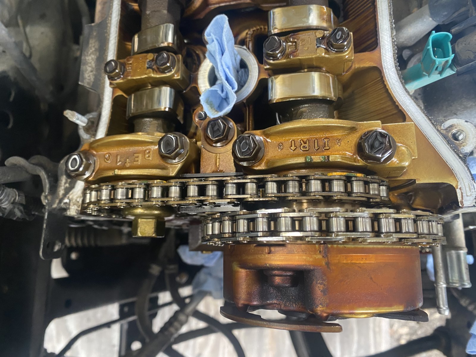

    When running, the tensioners will take up some slack. The valve springs will try to push it off a bit. Maybe post a pic from the front?

    I’ll take a another pic in a little but here’s one that shows it

    This is how off it was when set to tdc before taking off my old timing components

    Like others have mentioned, that's not enough to worry about. If everything else is lined up where the proper tooth is closer to the reference mark than any other teeth, you should be just fine.
