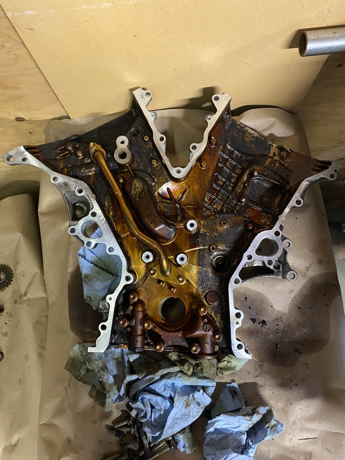

    Is the gunk on the inside of the cover worth getting fully off? I’ve scraped a good majority of it already but it’s still on there

    I sprayed mine down with brake cleaner and called it a day. Yours has a bit more build up than mine did though.
    Edit: I meant parts cleaner. Probably similar to brake clean though.

    Yeah and that picture I took is after I already scraped a bunch off. I’m just wondering if it’s bad to leave. I figure if it’s that stuck on there too much won’t come off and clog anything. Will probably do another oil change pretty soon after this job just to get any debris out

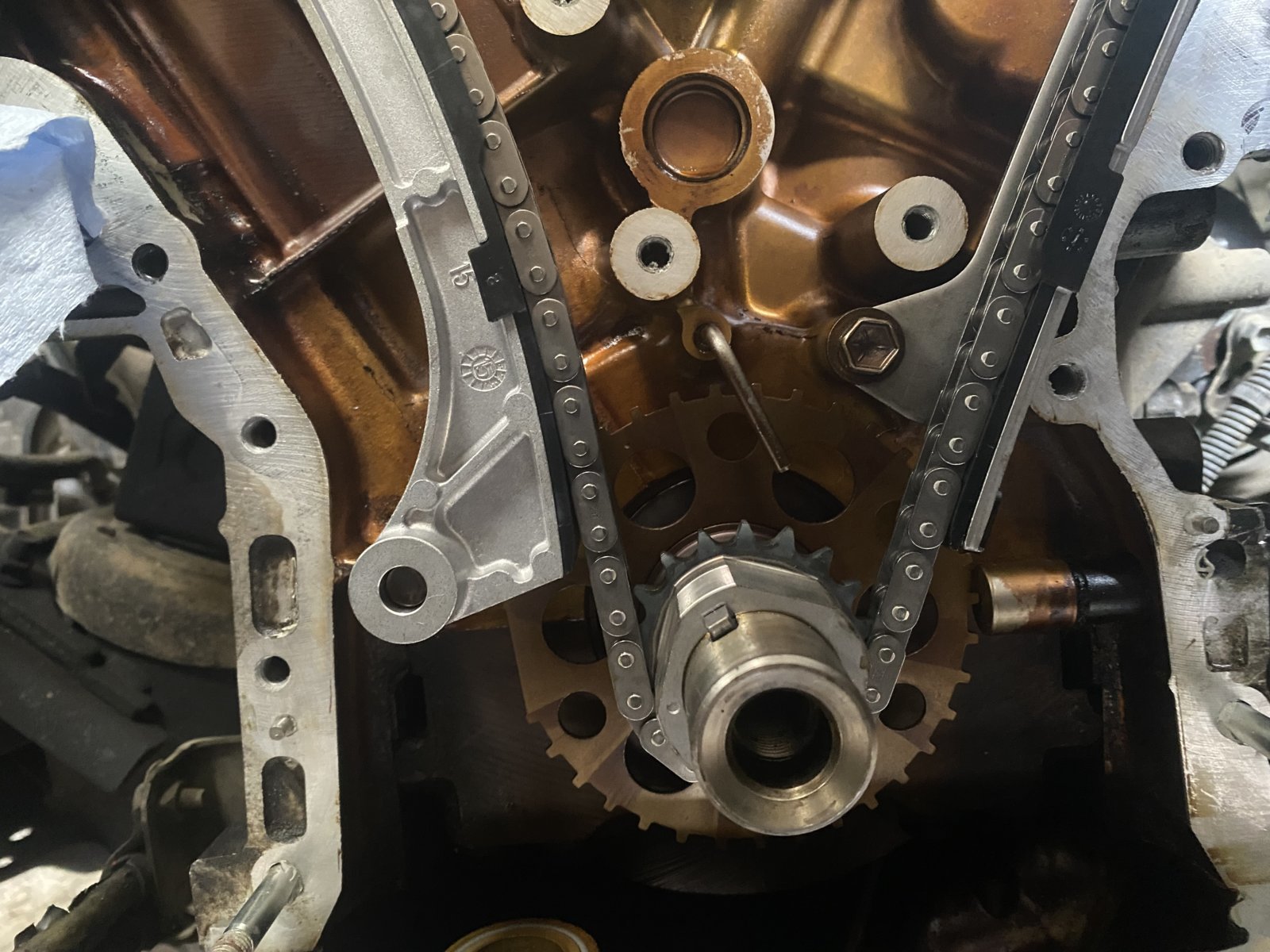

    There will be "tight" and "loose" spots as each cylinder comes up to TDC. Once the engine is running, oil pressure will show up behind that main tensioner and keep it more firm against the chain

    I can see why you guys said it’s annoying putting the cover back on. I’m doing a dry run and it’s so hard to get the oil pump around the crank as well as keeping that o ring from falling

    results after turning by hand, a few rotations
