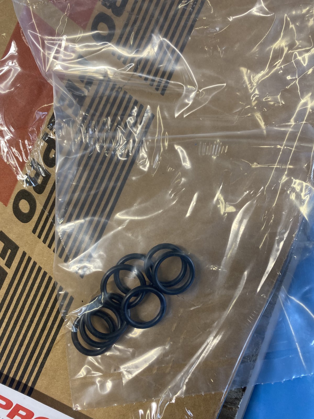

    Anyone know what these o rings are for that came with my valve cover gaskets? On the packaging it says “4 oil control plug” and “4 oil pump inlet tube” I don’t really see where they fit. It also came with 12 of the grommets needed for the 6 long bolts in the middle of the covers.
  6. Mar 4, 2024 at 2:51 PM
    #326
    zguy1
    zguy1 Well-Known Member
    Aug 9, 2021
    #373659
    418
    Midwest
    Maybe the 12 grommets are for the fuel injectors? The OEM gasket kit has 12 for the fuel injectors but the upper and lower are slightly different in size. Hard to tell from yours since you are using aftermarket.

    The grommets aren’t what I’m wondering about. They are for the long bolts that go through the middle of the valve covers next to the coils. The other o rings I believe are for the vvt and cam sensors I believe…

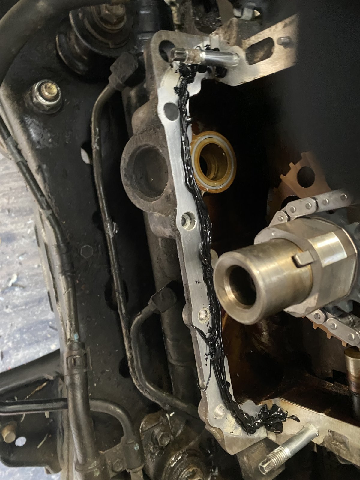

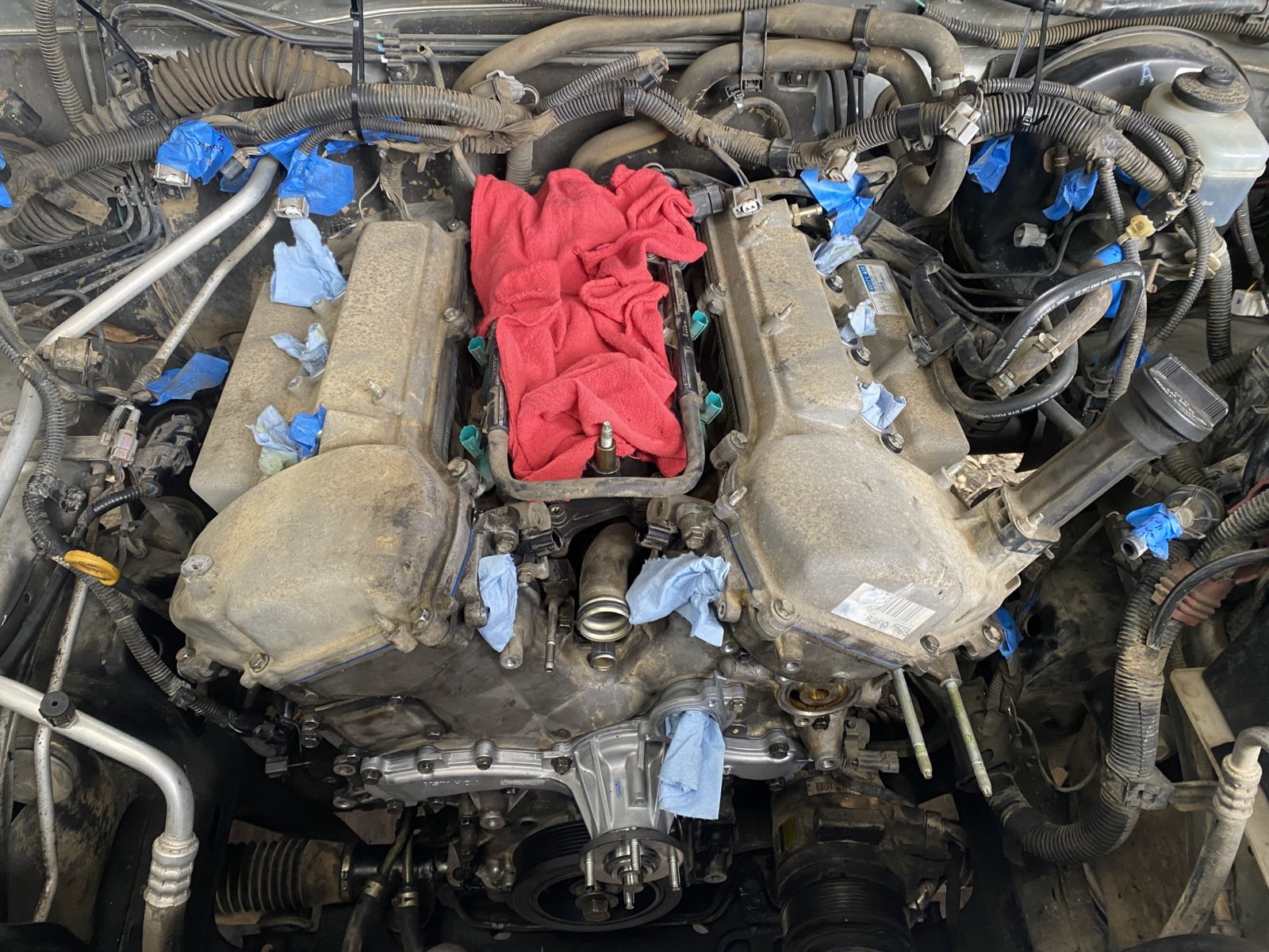

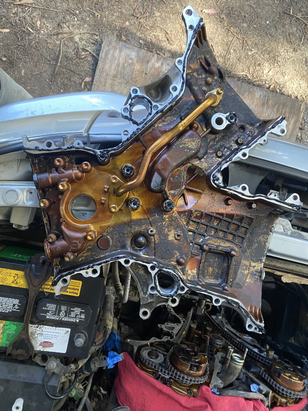

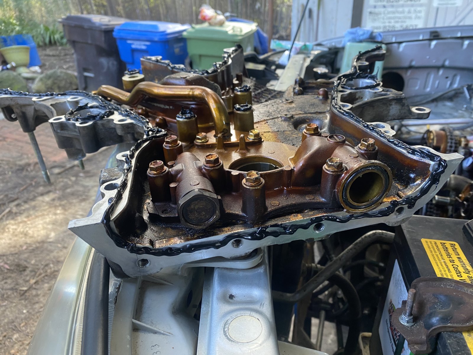

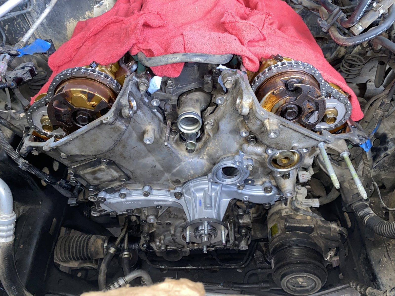

    A little progress has been made…

    How did the timing cover install go?
    p16[OP] likes this.
  10. Mar 4, 2024 at 3:11 PM
    #330
    p16
    p16 [OP] Well-Known Member
    Mar 8, 2021
    #358635
    244
    2005 Tacoma V6 4.0 L 4x4
    Not bad i think the key is to do dry runs to get the hang of it (without breaking an o ring like I did) and to put the cover on there dry right before you are ready to do it. Very carefully slip it off and pull it up without any sudden moves because that WILL move the oil pump. Lay it down carefully. Clean the surfaces one last time and then apply the sealant. Then be very slow and careful when picking it up and lowering it down. I put some on the bottom of my cover as well as the top of the oil pan to make sure I didn’t smear any off when putting the cover on. A small amount of vaseline helped a great deal with keep the o ring in place
