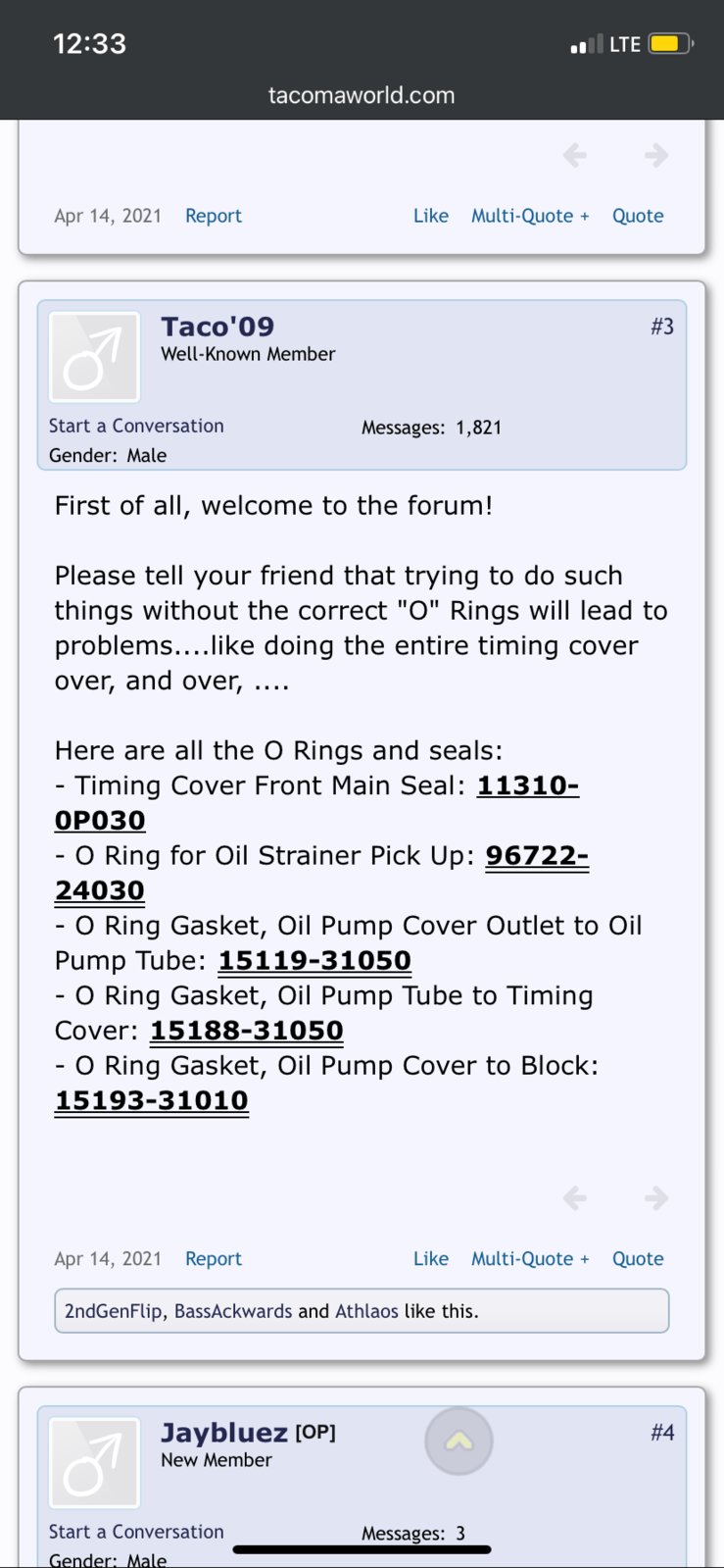

    I know there are a few o rings that should be changed when I do the timing cover. I noticed a lot of kits don’t include those. Anyone have the names of them or part numbers?
    update: think I found em can anyone confirm these are what I need?

    Ideally O rings would be replaced if there is any
    FSM and parts catalog should outline this and what is one time use
    in a pinch generic o ring assorted kits can be of use but aren’t as ideal as the actual right part

    Worst case scenario o rings can be cleaned and re installed with silicone grease
    But ideal is new replacement.
    parts catalog is worth consulting any time to verify latest up to date PN and applicable to VIN as sometimes revisions happen.
