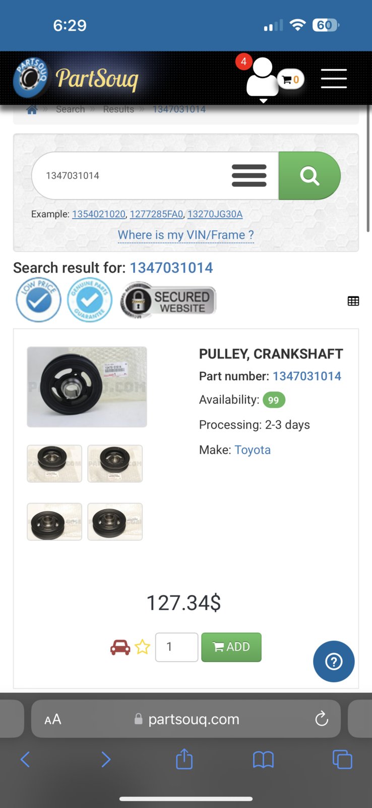

    buy from parts ouq much much cheaper.

    I bought from parts ouq many times for the Tacoma and my Mazda. Oem parts for significantly cheaper and VERY fast shipping
    buy the pulley, the seal and the bolt
    p16[OP] likes this.

    Is this a reliable site for oem parts?

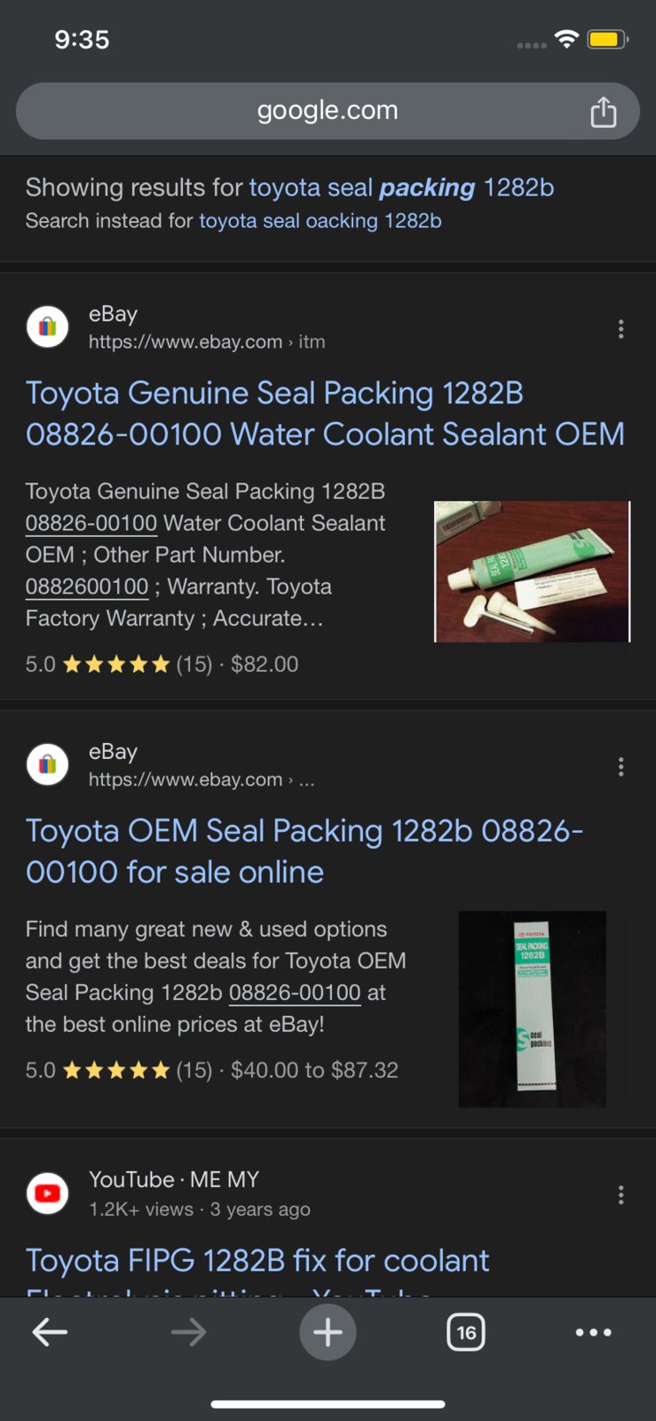

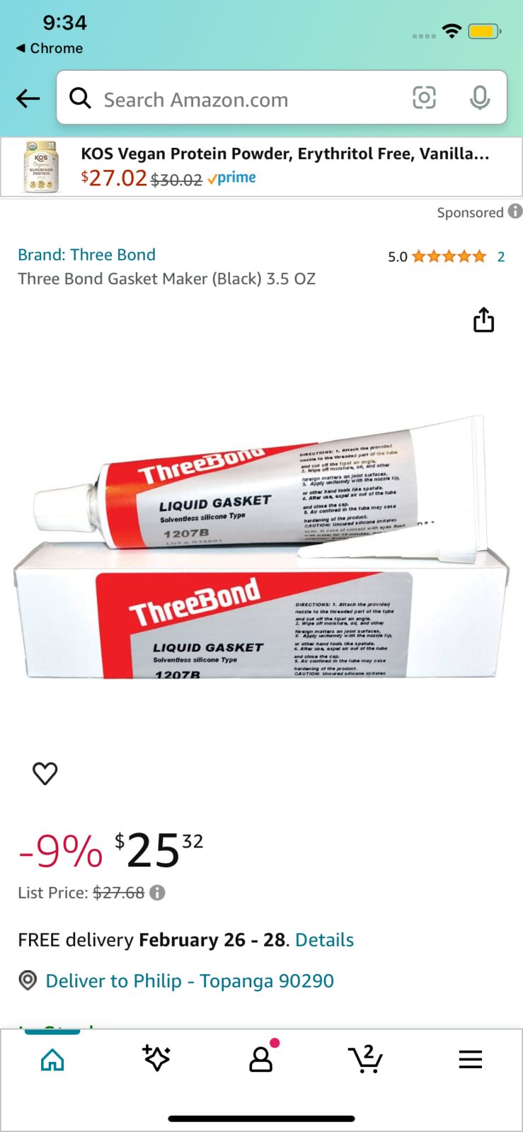

    So I was looking at sealants to use for the timing cover and was reading in the manual that they recommend using a different one around the water passages. These are the ones that are recommended but I couldn’t help to notice how expensive the coolant sealant is. Are there any good alternatives that anyone knows to that one? I prefer not to pay 80 bucks for a sealant that I barely have to use

    So, another judgement call here. The wisdom on the internet seems to be torn, and it sounds like you've seen a lot of the posts I was able to find. The 1282B is apparently the proper one to use and is resistant to the pink coolant. Most people don't use that, but some mechanics see failures when other types are used. Other people have seen no issues using the other types. Apparently there is a version of a Toyota FSM out there that calls for 1207B. So, you could be just fine using the 1207B. Aisin is usually the OEM for water pumps and sells their own version, not sure what that is, though. I would use one of those 2 types.
    Maybe someone here with some longer-term experience will chime in.

    If we are strictly talking about OEM sealants then the FSM calls for two, 08826-00100 and 00295-00103. If you get both of those then you should be confident that you are using the right stuff assuming you apply it correctly. If you are looking to save money, then I am sure you can use other products like suggested above. I asked around when I did mine and several techs stated that they just use FIPG 103 for both areas. I ended up going that route.
    FYI here is another post referring to sealants.

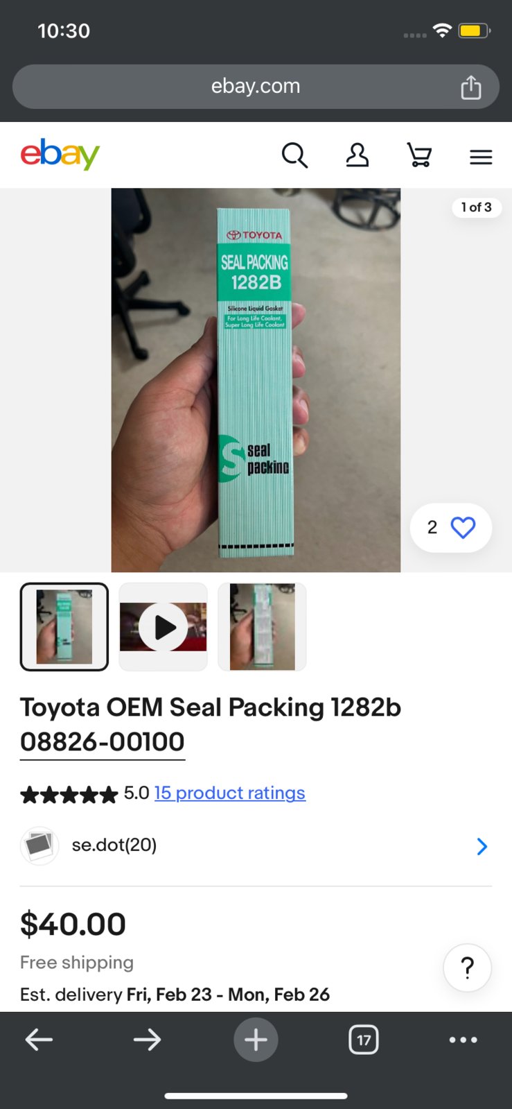

    Found this one for $40 off eBay. Not a bad deal considering what it’s priced everywhere else
