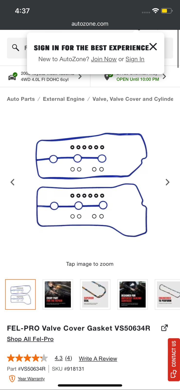

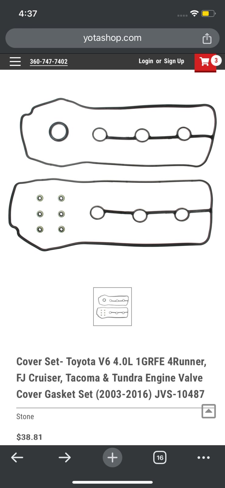

    Anyone know about the “valve cover bolt seals” that come with these gaskets. Are they just extra incase you need them or are they reccomended to be changed when you do the seals? Also the one from AutoZone seems to have a few more seals, anyone know what they are for? The description isn’t too descriptive…

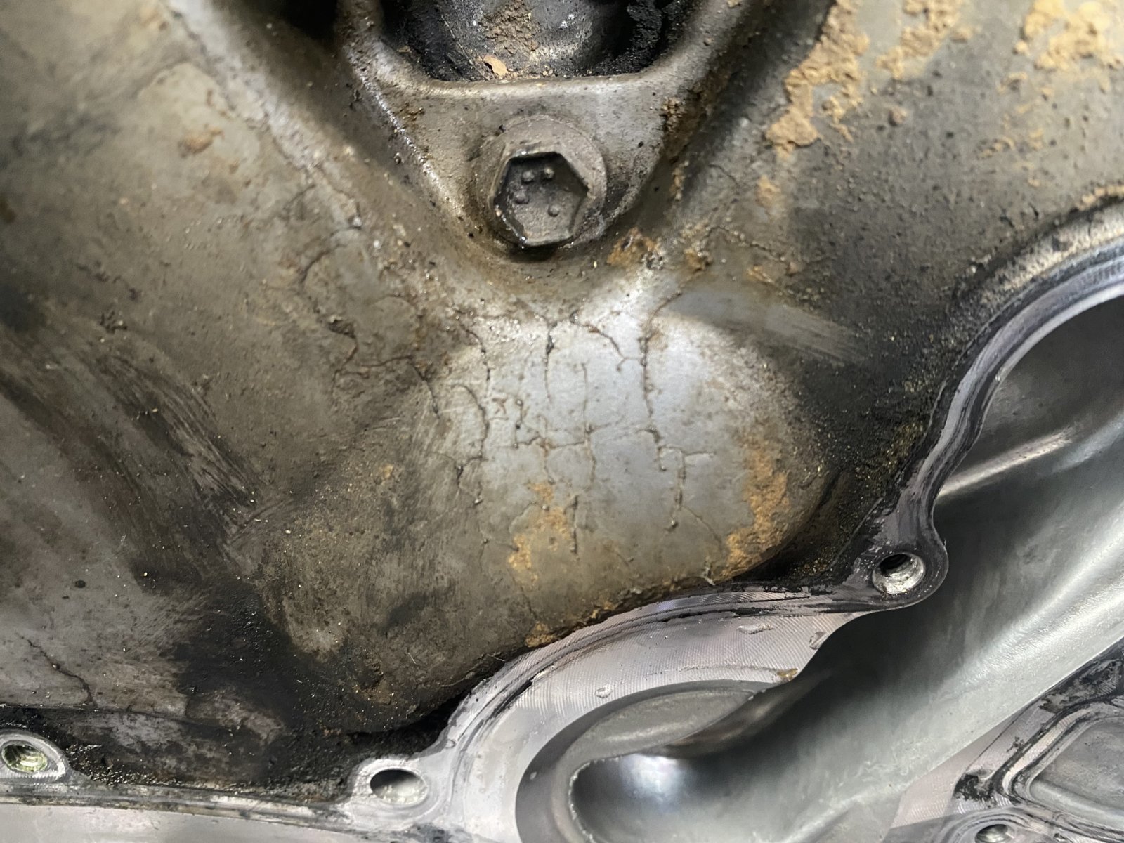

    Are these little cracks an issue? They just seem like surface cracks

    casting flaws

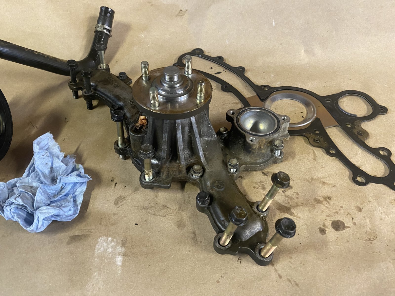

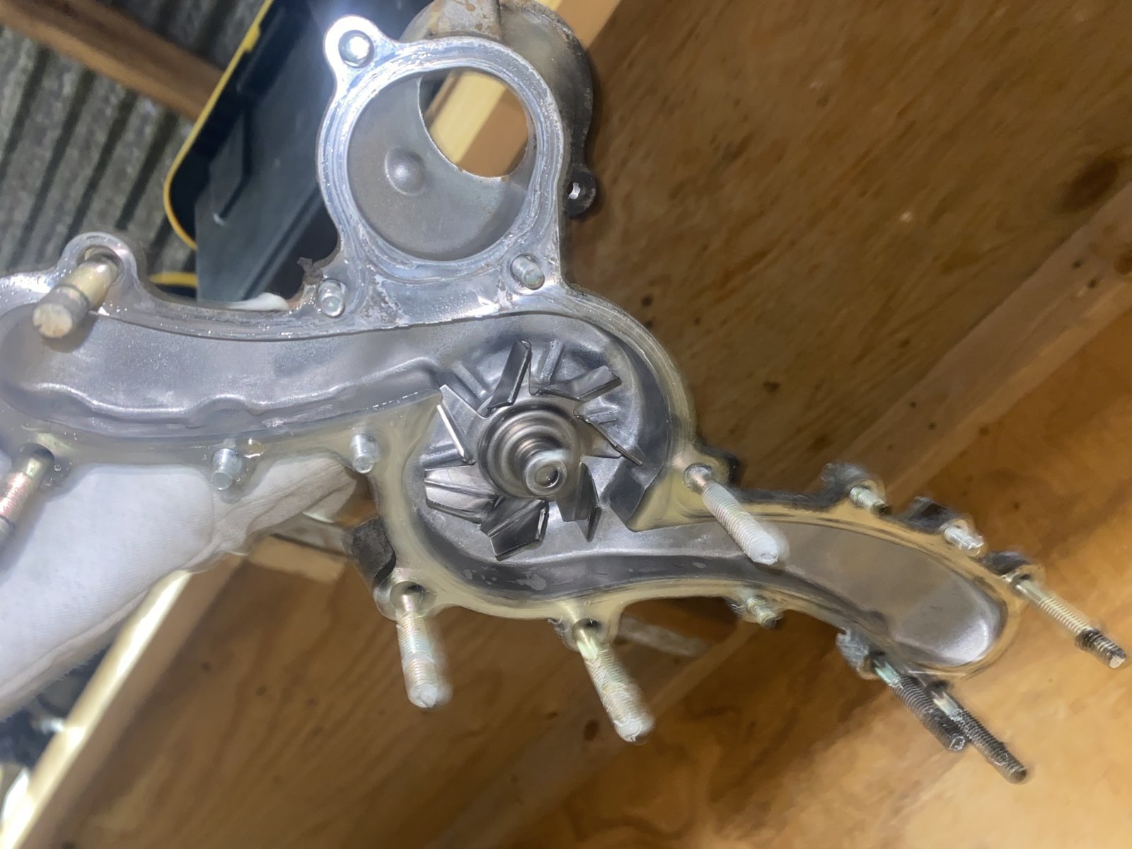

    Also do y’all think I should replace this water pump? It looks pretty clean on the inside.

    Yes, it has been leaking look at the crust blob.

    It isn't a matter of being clean. It usually develops a leak at the shaft seal and is shown by the crust at the weep tell tell hole. Just like you have there.
    Get a new one or plan on going back in soon.

    Yeah I’ll probably just do it while I’m in there

    I bought the blue felpro kit for mine. The new washers were really loose so I re used the stock ones.

    Think ima get the one off of yotashop

    You already have it out. The bearing has miles and age.
