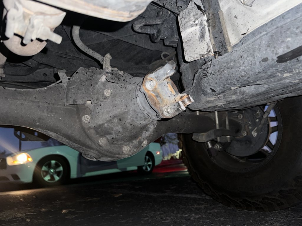

    y Rear Drive Shaft had broke. I’m extremely curious to get your guys opinion on this. My Tacoma only has 42k miles and is well taken care of. I do have 2.5in icon lift and 285/75/17 Ko2 on my truck, could that possibly be be the issue???

    Assume your driveshaft side of the yoke is fine, other then some scratches, it's cheap to fix. Without the model/trim speicifics, the U-joint with yoke flange is listed at $116.
    You should check the drive line, mainly pinion angle.

    Wow. no option to tap the u joint out and replace the u joint, and flange? Yoke? Not sure of the terminology.

    Yes, if you are sure the other halve(part of the actual drive shaft is still in good shape). The other halve yoke flange (attached to the pinion), is broken, can be replaced by itself.

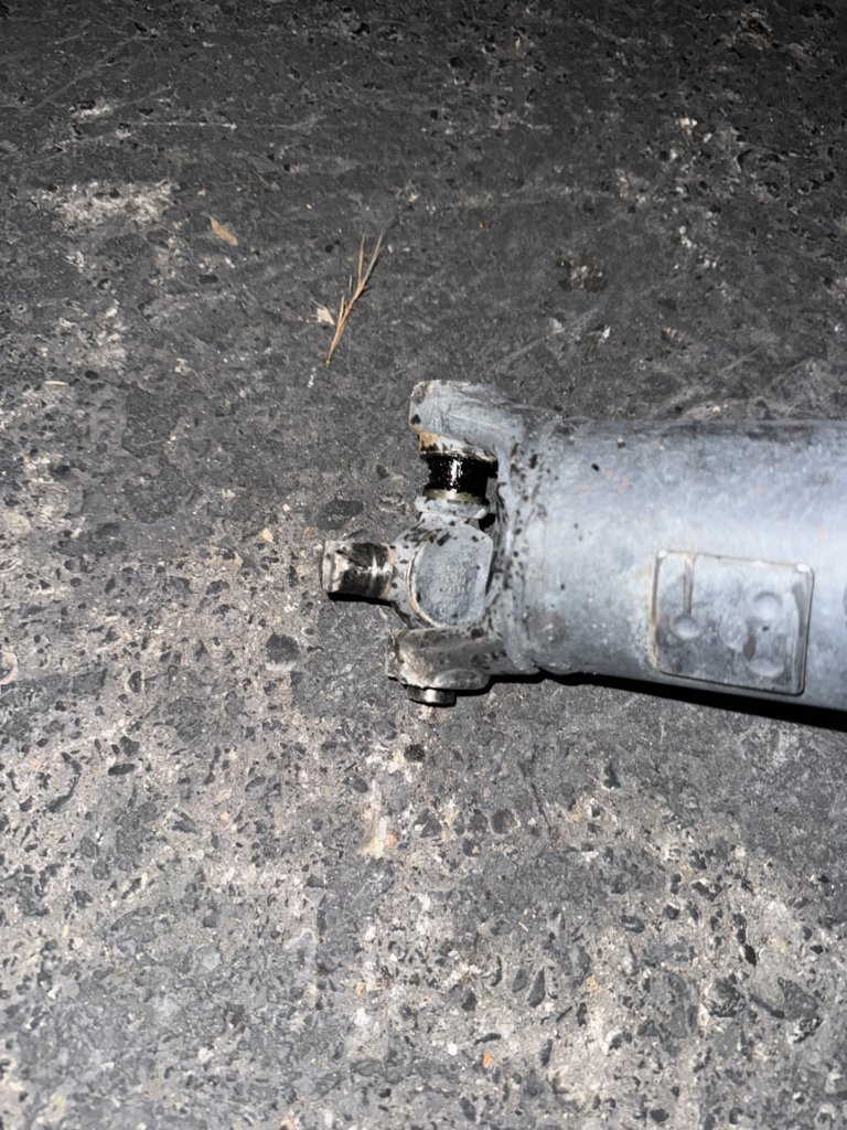

    Here’s a picture of the u joints

    Don't just junk it. Any competent axle shop can lob it off and reweld a yoke on the shaft. You may lose 1/2", but the slip yoke has more than enough length to compensate it. At lease you will have a good spare.

    Did you ever notice a weird squeak when moving very slowly in a parking lot? That looks like the standard u joint ran out of grease and seized then broke kinda break

    Looks kinda dry to me..........

    Rear drive shaft has no grease fittings for this year only front drive shaft.
