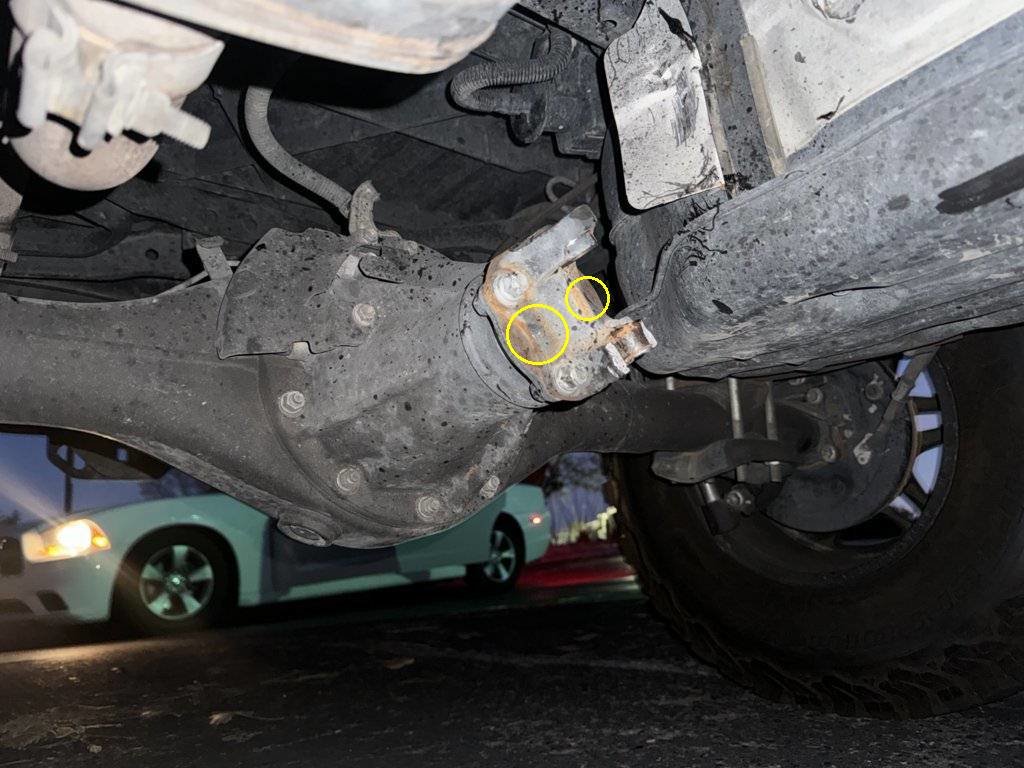

    Hard to tell in your pic, but are these marks on the flange-yoke from the u-joint binding from too much angle (maybe from improper pinion angle and/or excessive leaf spring wind-up (axle wrap))? If so, this is would be a reason why it broke.

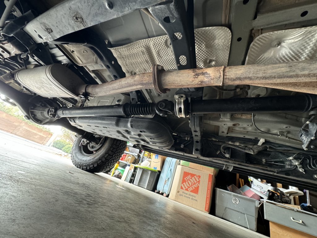

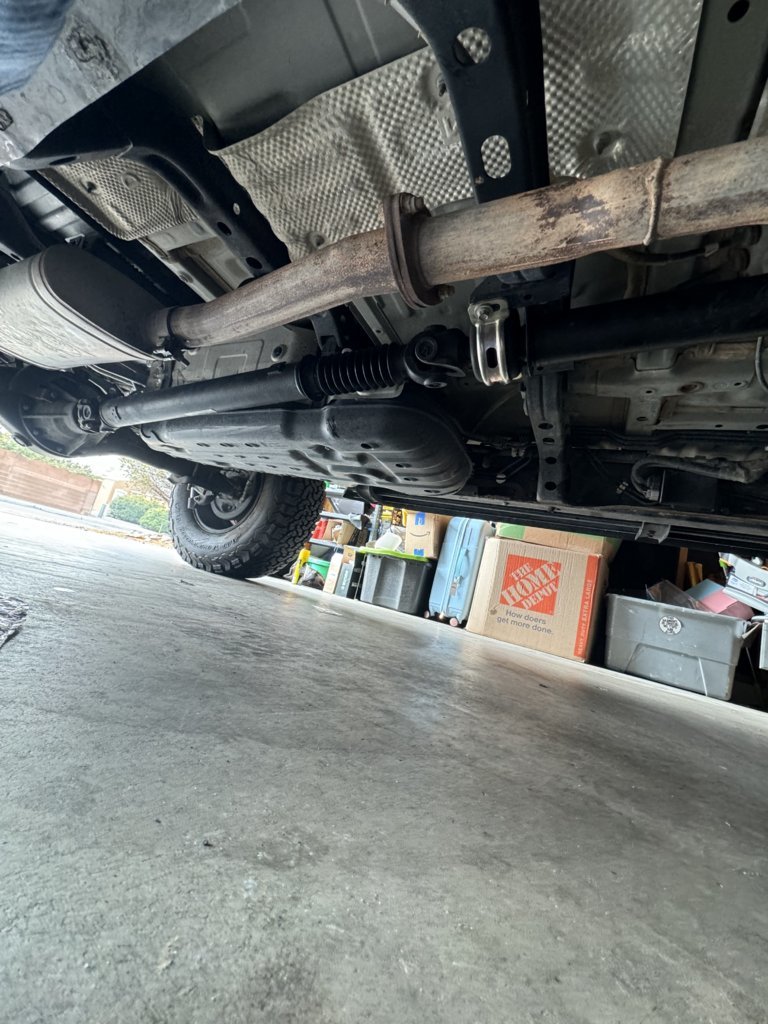

    This is how the new install looks
