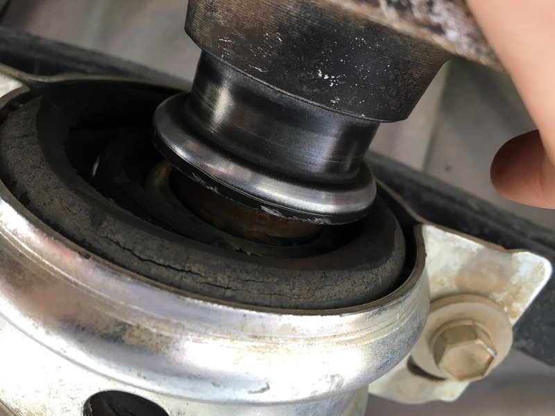

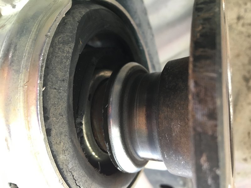

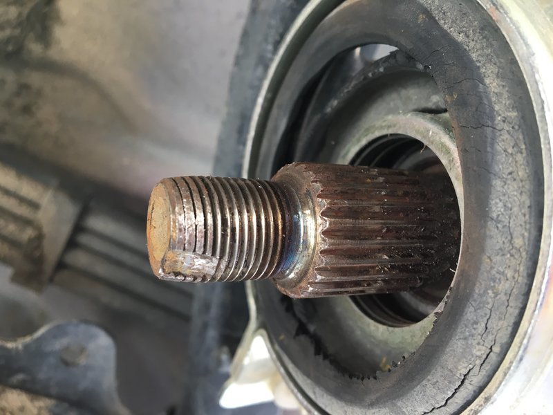

    **UPDATE**
    Parts just came in
    -Carrier Bearing
    -Nut for driveshaft
    Threads seem to be flattened so I can't get the Nut to even thread on it.

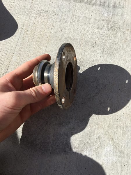

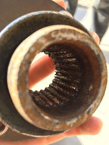

    IMG_1551.jpg these threads are flattened also so can't put the piece on all the way ( this is the price I'm going to try and file down before buying a new one -_-IMG_1561.jpg And then noticed the flange that connects to the threads behind that spline that connected to the front part of the driveshaft is also flattened and all sorts of fucked up. Bought a file and am going to try to file down the flattened sides on the flange so it can seat in but might just have to drop another $50. Hopefully can rethread the other piece. Any advice ?? Lol

    The threads left are where the nut will be so that's not to big of a deal. Just go to work with a file.
    The flange id probably replace. Dont want any slop there.

    I was thinking of using a tap and die kit on the thread that the Nut screws on too, Damn I'm bummed about that flange. Just want to drive my truck lol

    Could I hammer the flange on with a dead blow, until it's seated all the way in ? It stops with about a centimeter of room left IMG_1565.jpgIMG_1564.jpg

    You could, but if you hit it wrong and it screws up, you'll never get it back off.

    You could tap it on. But you need to replace that carrier bearing. It's bad! They make what is called a thread file. That would be your easiest and cheapest way to straighten the threads up.

    You'd have to use a puller
