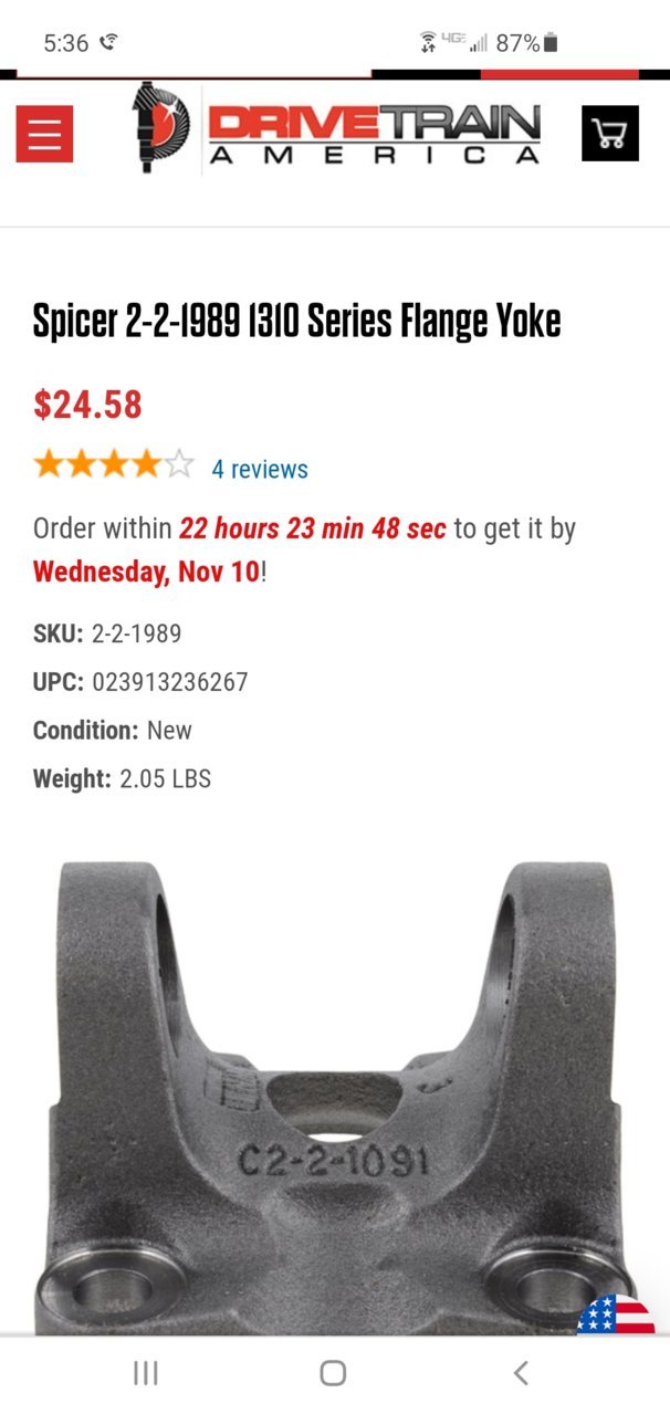

  11. Nov 7, 2021 at 3:47 PM

    That's a bummer. Have you taken the caps out of it yet? Clean that piece up and share a better look please.
