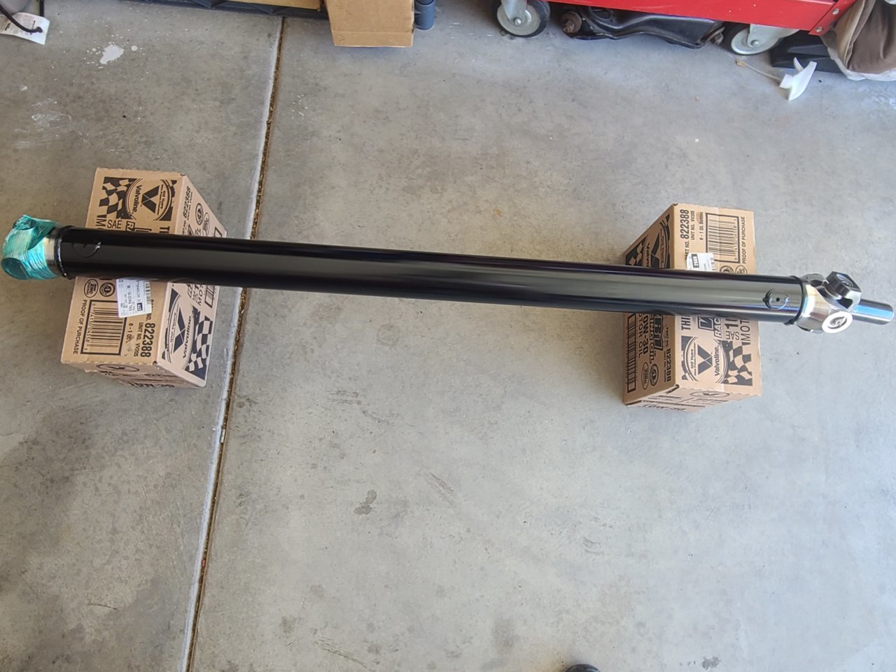

    Can't break this driveshaft :thumbsup:
    Chromemolly tube , Billet steel yokes and Spicer 1410 series u joints . This is in my Camaro and capable of supporting over 1500hp
    I used to run this style driveshaft but with Spicer 1350 u joints in my Jeep rock crawlers
