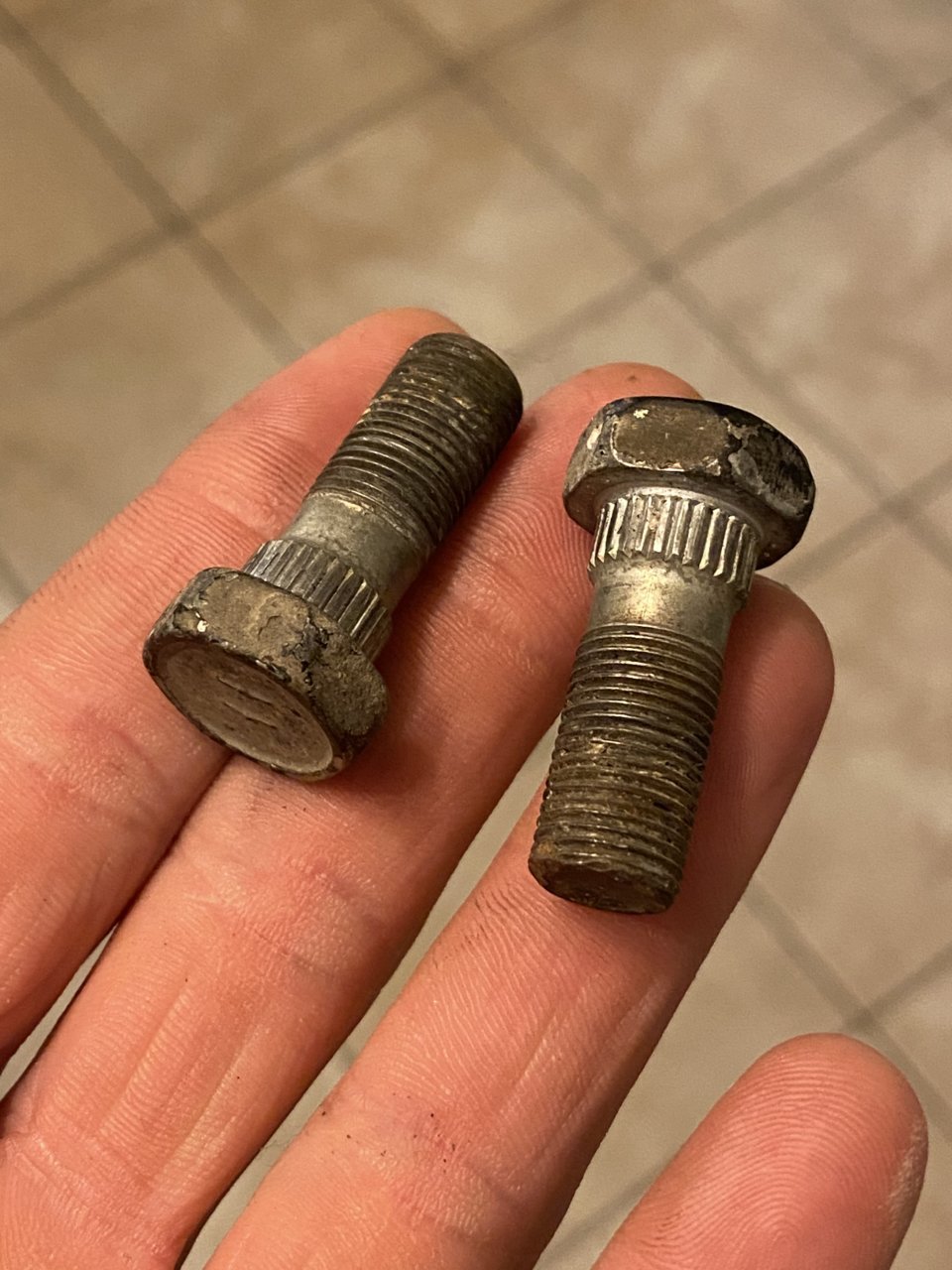

    These are the bolts I’m in search of now. I need at least 2 more. The Toyota employee just said I can find any old bolt that would fit, but I highly doubt that. Aside from matching threads I imagine it needs that bump out in the middle and would have to be a certain grade of bolt to withstand the torque subjected to the driveshaft 5E0FF939-A576-40C0-81C8-5CC7BF96C3C5.jpg

    Take those bolts to a drive line shop and they should be able to match them up.

    Those bolts look like a wheel stud ??

    They're the bolts that connect the front of the rear propeller shaft to the transfer case. I've asked around at drive shaft shops and nobody seems to be able to find me these bolts, and they say I should go to Toyota. The problem is Toyota only sells those bolts with the transfer case for some reason.
    It's very frustrating that Toyota couldn't just sell me a flange yoke to replace the broken one I have, instead only offering the entire propeller shaft assembly, and now they can't even get me 4 simple bolts without trying to sell me an entire transfer case. It's insane. I'm out of ideas now

    I’d use standard bolts with either a lock washer or removable lock-tite and call it a day.

    Yeah the factory bolts are fine thread M8 or M10, something like that. Id just use a regular hex bolt of the same size (high-quality and high-strength of course)
    Just make sure they are opposite each other on the flange for balance reasons.
    Youll probably find the original ones you lost soon enough anyway.

    Replace all 4 bolts with Grade 8 or metric equivalent.
    Go to your local hardware store who has metric bolts. Pay attention to the strength Grade.
    Instead of Locktite, try a set of 4 nylock type nuts. Here again, match the strength Grade.
    If the local box store doesn't have, go to Fastenal or McMaster Carr.

    not even Fastenal has these bolts! I’m baffled.

    You don't need the exact bolts.
    Focus on the diameter, length and strength grade. Get matching nuts.
    A flange head bolt paired with a flat washer and nylock nut would work very well.

    you can buy the Toyota bolts, the transfer case ends have serration bolts like a wheel stud but I just replace them with the same bolts that hold on the shaft to the differential. Easily sourced from Toyota
    Bolt - 90105A0075
    Washer - 9020111013
    Nut - 90178A0045
