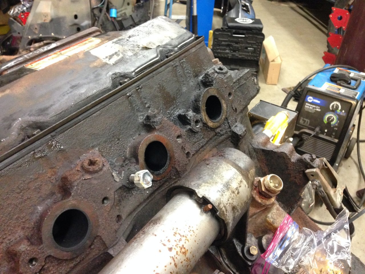

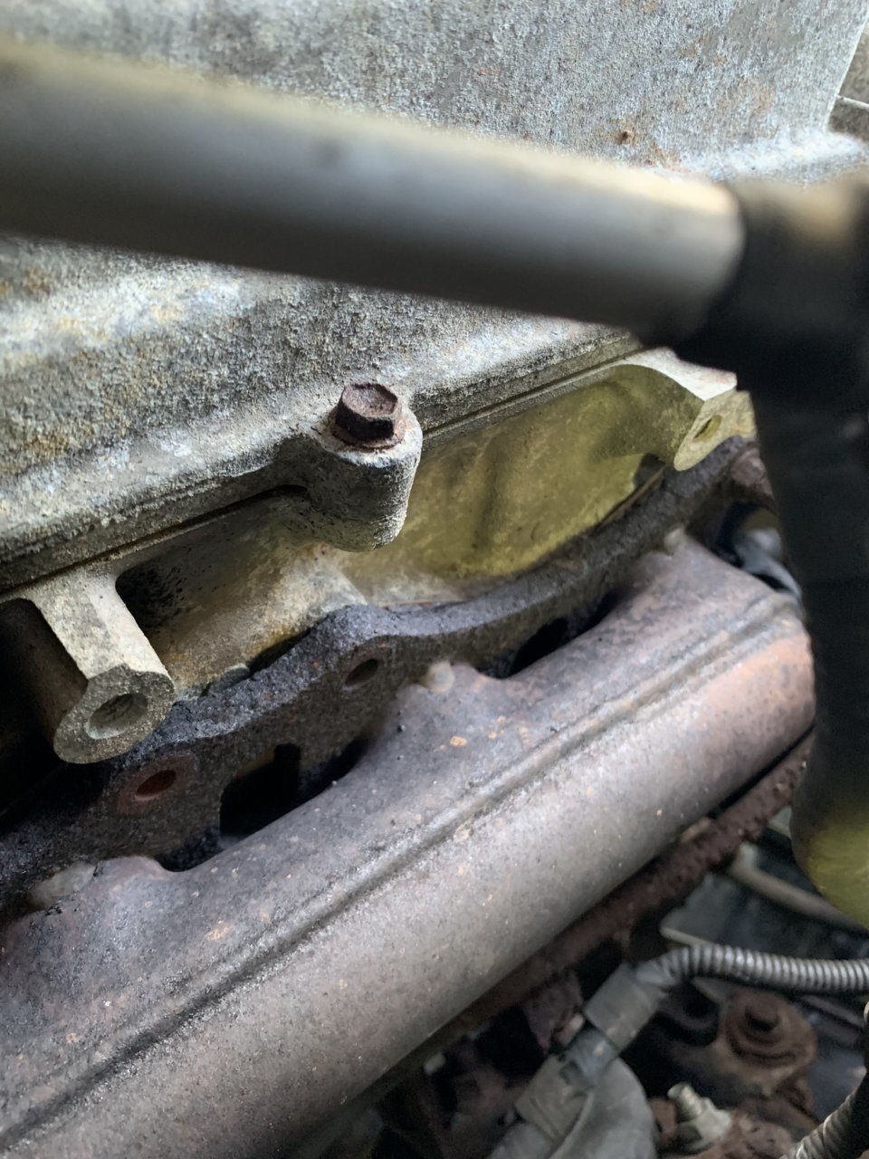

    So this is what it looks like I haven’t had too much time to look how far the in the stud snapped but it’s only theses two the other side is mint
