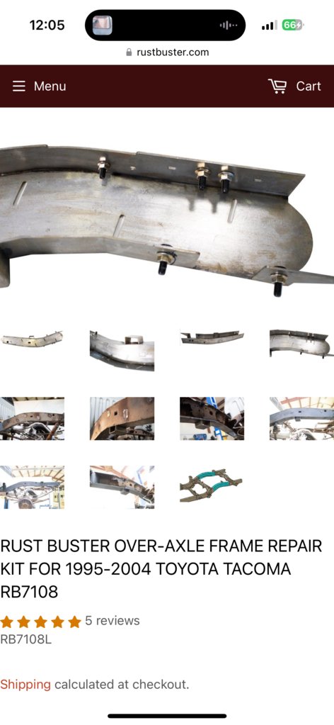

    this is a better product for that area than the saf t cap. It contains new bolt holes because yours will mostly get damaged when removing the cross member. The safe t cap version of this panel is made to slide over gas tank crossmember holes
