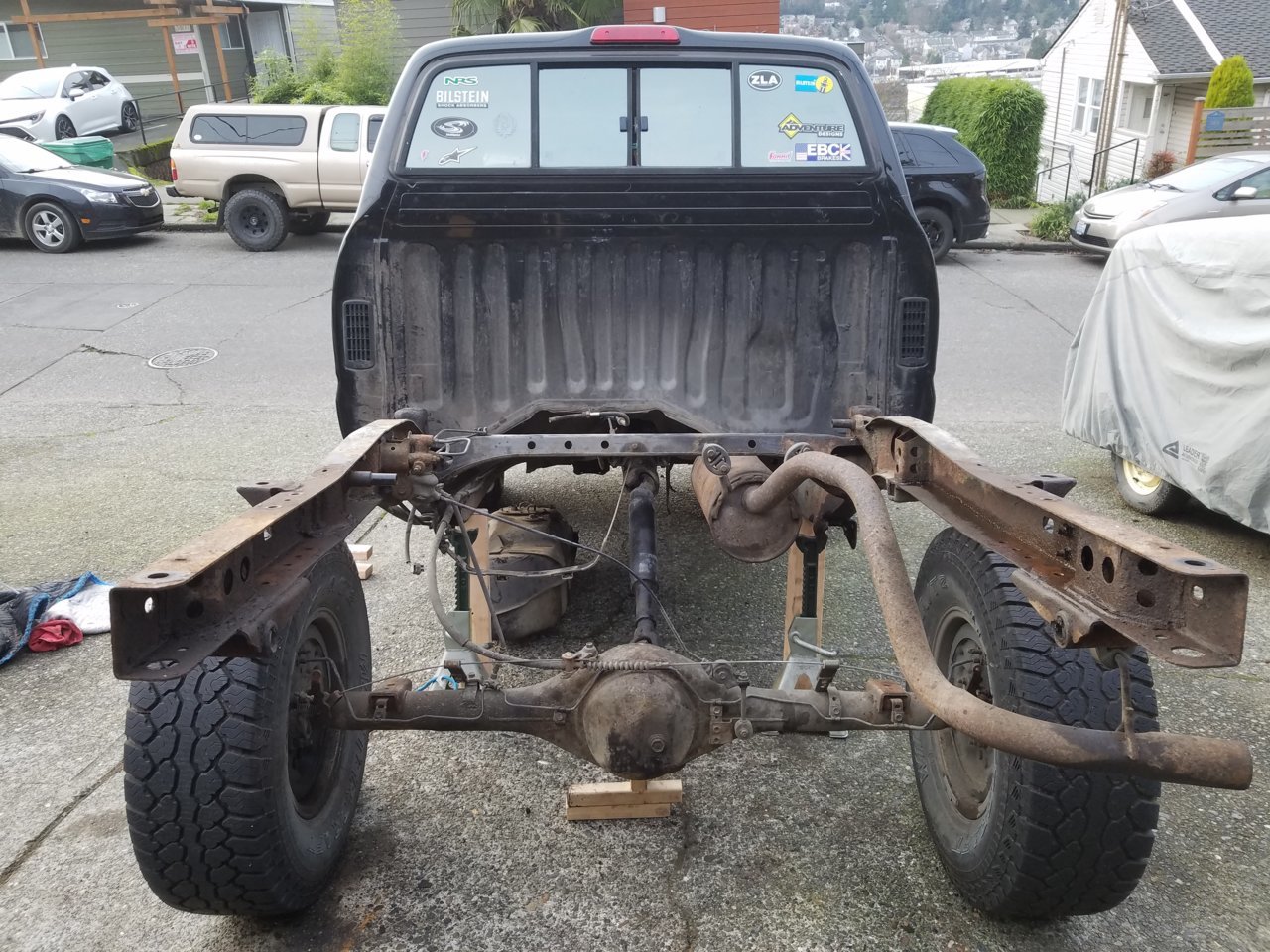

    Got the bed off to assess the damage. It doesn't appear to be as bed as I had feared.

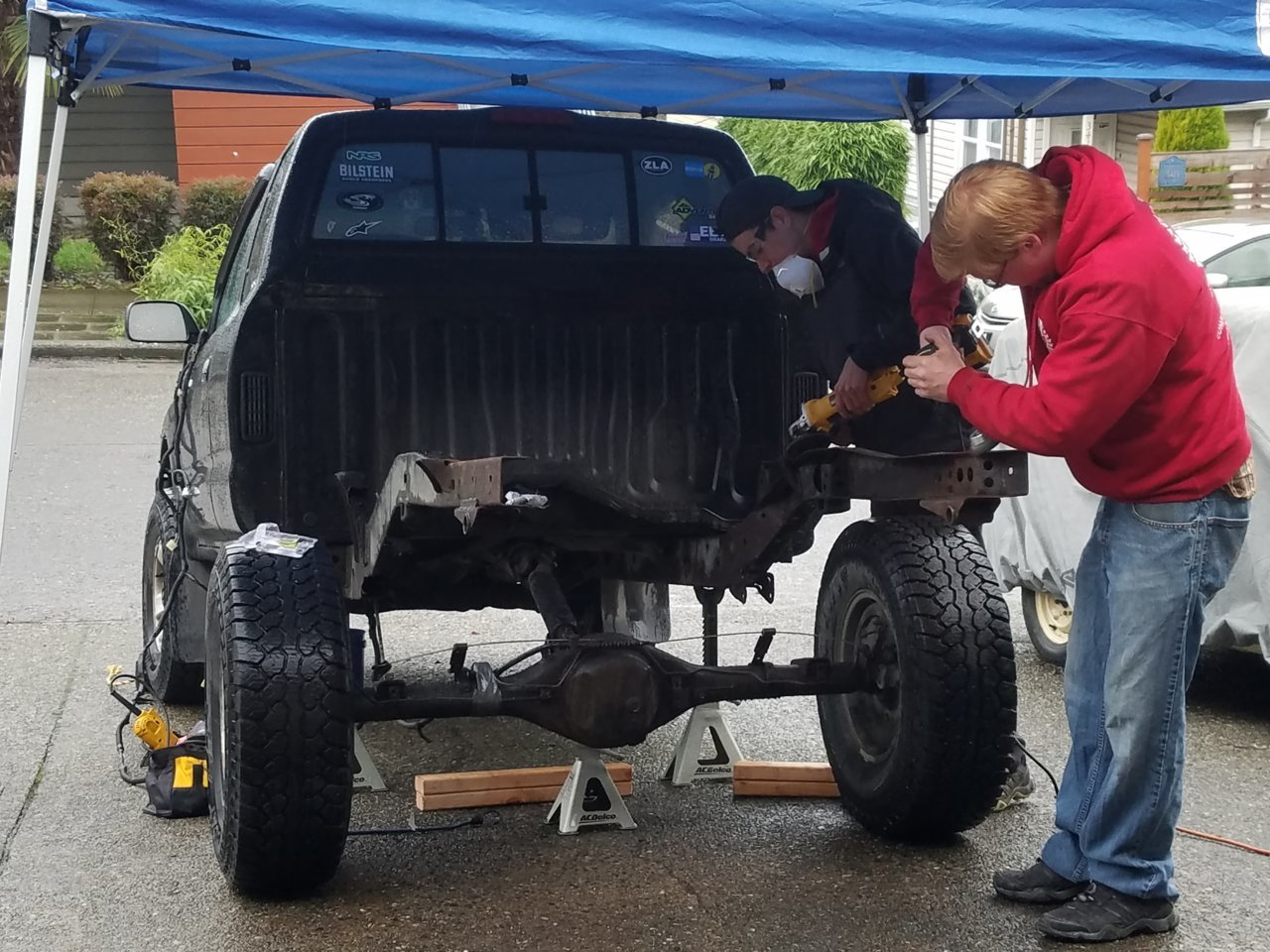

    A neighbor of mine is a welder at a local shipyard and he offered to give me a pair of hands in getting her back on the road. I plan to clean up the frame, remove the flakey stuff, and POR 15 the entire rear frame. The front of the frame looks good but I'll drill some drain holes, blast the inner frame with some water/compressed air, and spray some POR 15 inside to stop future rust.
    Since I found a replacement daily driver I'm tempted to do a flatbed conversion, smoke stack the exhaust, and install a trail rear bumper and maybe a roll bar.
    I'm open to any suggestions though.

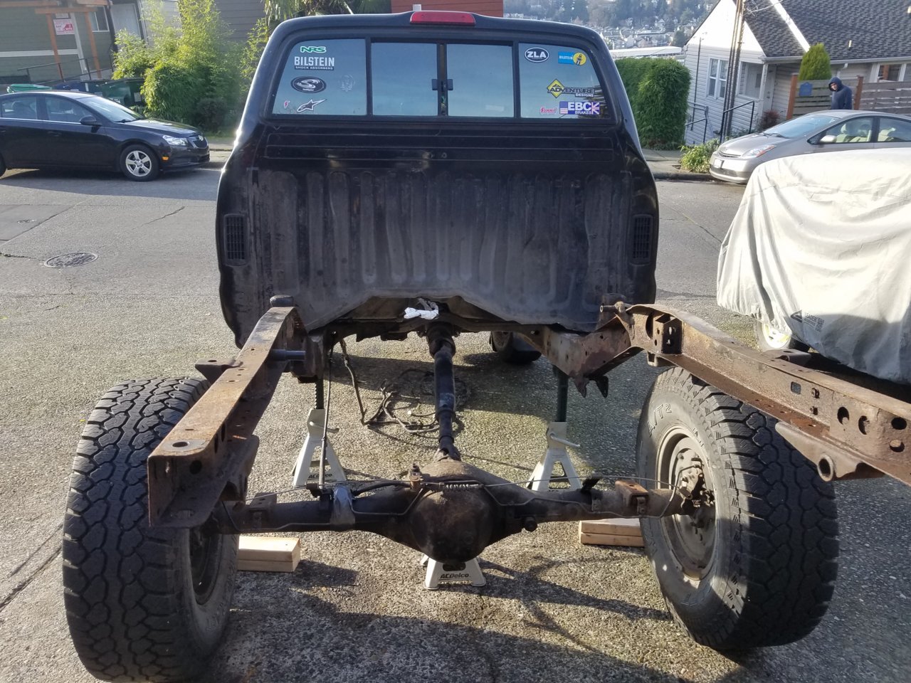

    Working away on being the backend taken apart. Most the bolts are super rusty so progress has been slow and go.

    I'm actually surprised the rust damage isn't worse.

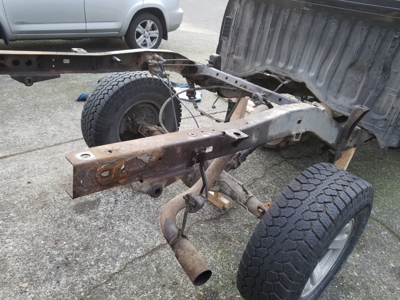

    Got the exhaust off as well as the rear brake lines. Next up is to take a needle gun to the frame and cut out the bad stuff.

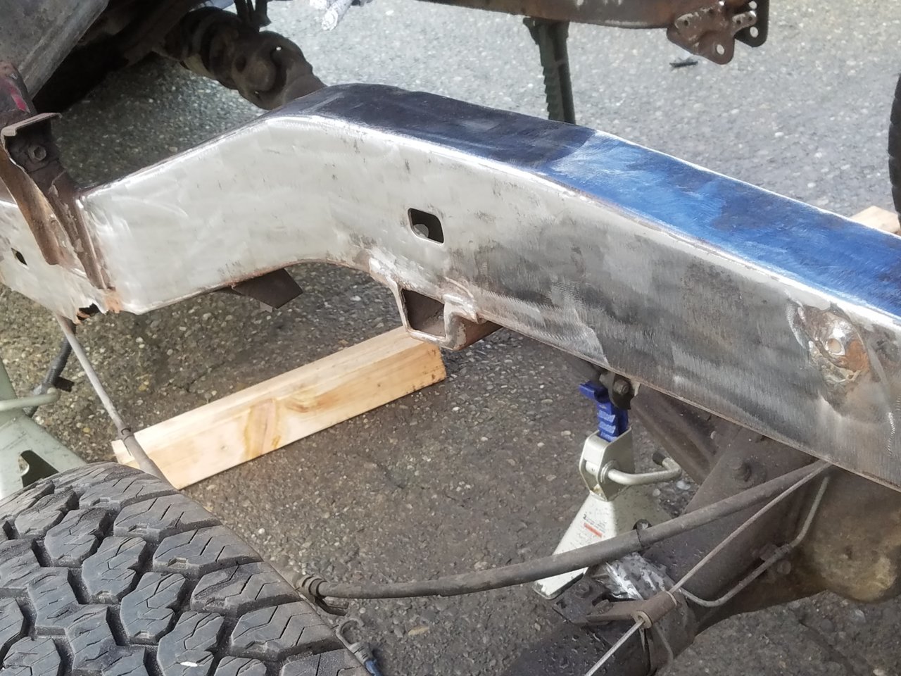

    Prep work on the frame begins today. Rust/paint removal is the goal.

    Frame is coming along.
