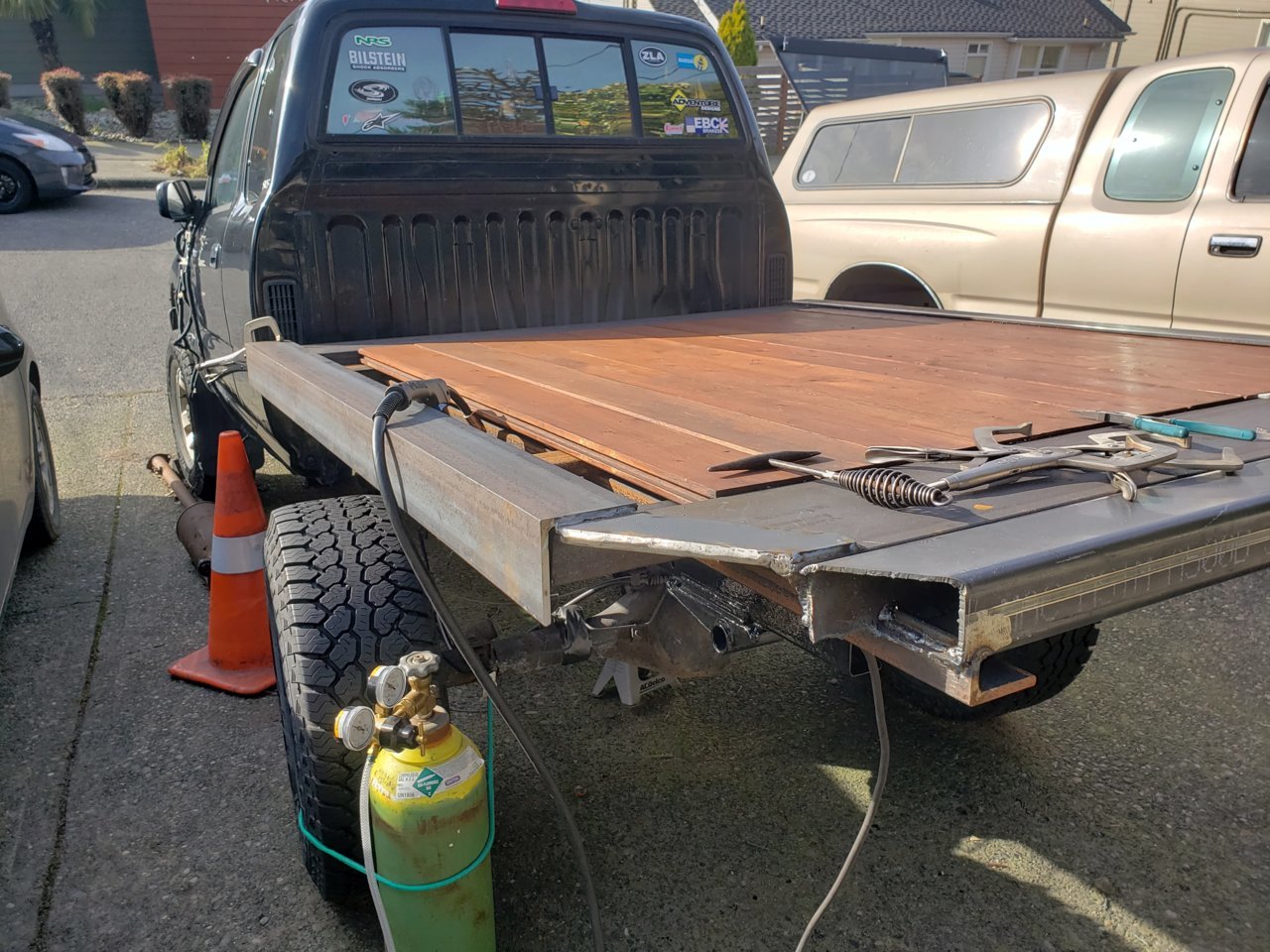

    172

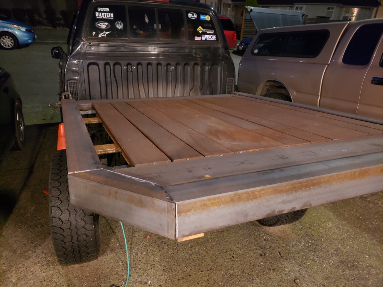

    Decided to cut the rear at an angle to break up the lines. Since the wood sits a little above the angle I had to cut out some risers using my hypertherm 30xp. I wanted to be able to remove the wood slats and didn't want the side rails to lock in the wood.
    I also used the plasma cutter to cut the rear at the appropriate angle. After cleaning up the edges with an angle grinder it was coming along.
    SwampYota likes this.

    172
    I cut some more 4" angle to wrap around the corners. I had to take off an inch on the top portion so the lines mat up. The plasma cutter and a straight edge made quick work. I wasn't able to weld tonight as it was getting a little late and running the Trailblazer 302 to power the Miller wire feed gets a little loud and I'm already beyond the typical work done in a heavily populated neighborhood. Want to play nice with the neighbors.
    I'm glad I angled the tail. It looks a lot better.

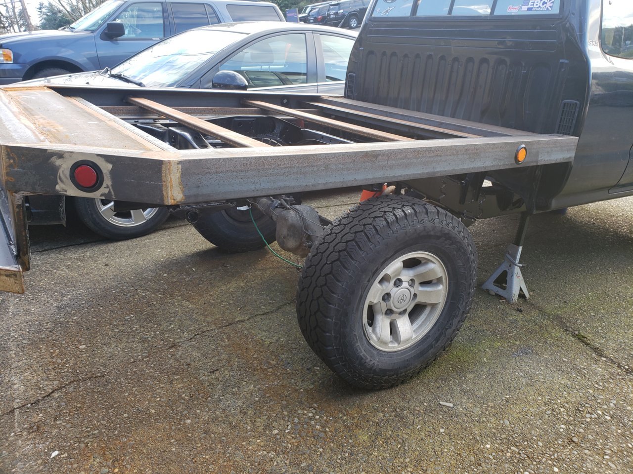

    172

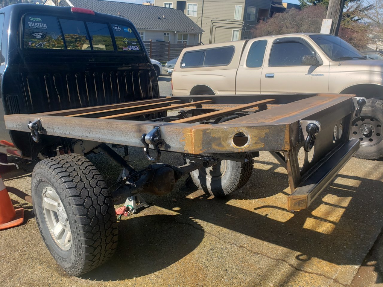

    Welds made and grounded down the joints. I'm really digging how it turned out. Looks much better with than a straight back end. Now to tackle the rear bumper.

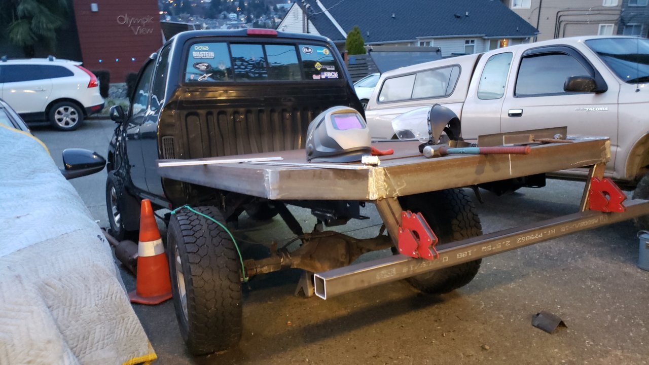

    172

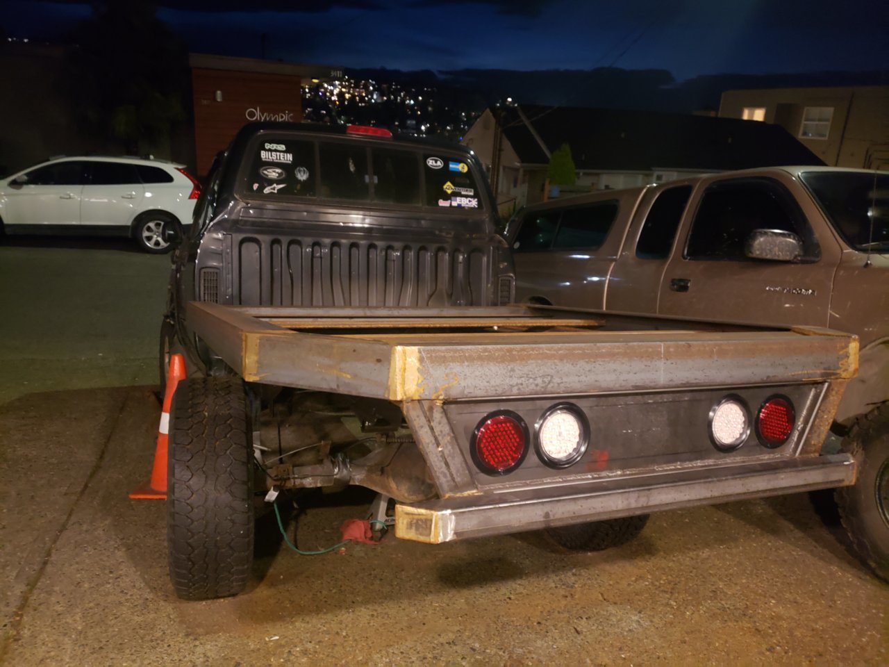

    Rear bumper is coming along. Tacked in some 1"x3" square tube at an angle and mocked up some 2.5" x 2.5" square tube just see how it looks and make sure my supports are level.

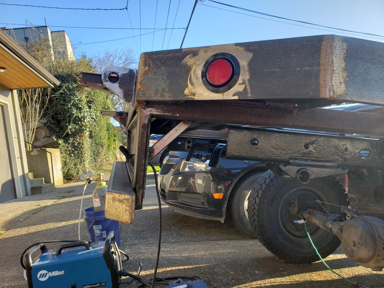

  8. Mar 10, 2020 at 8:13 PM
    #68
    Aray02
    Aray02 [OP] Well-Known Member
    Jan 7, 2019
    #278512
    172
    Welded up a back plate and got some lights mounted up today.

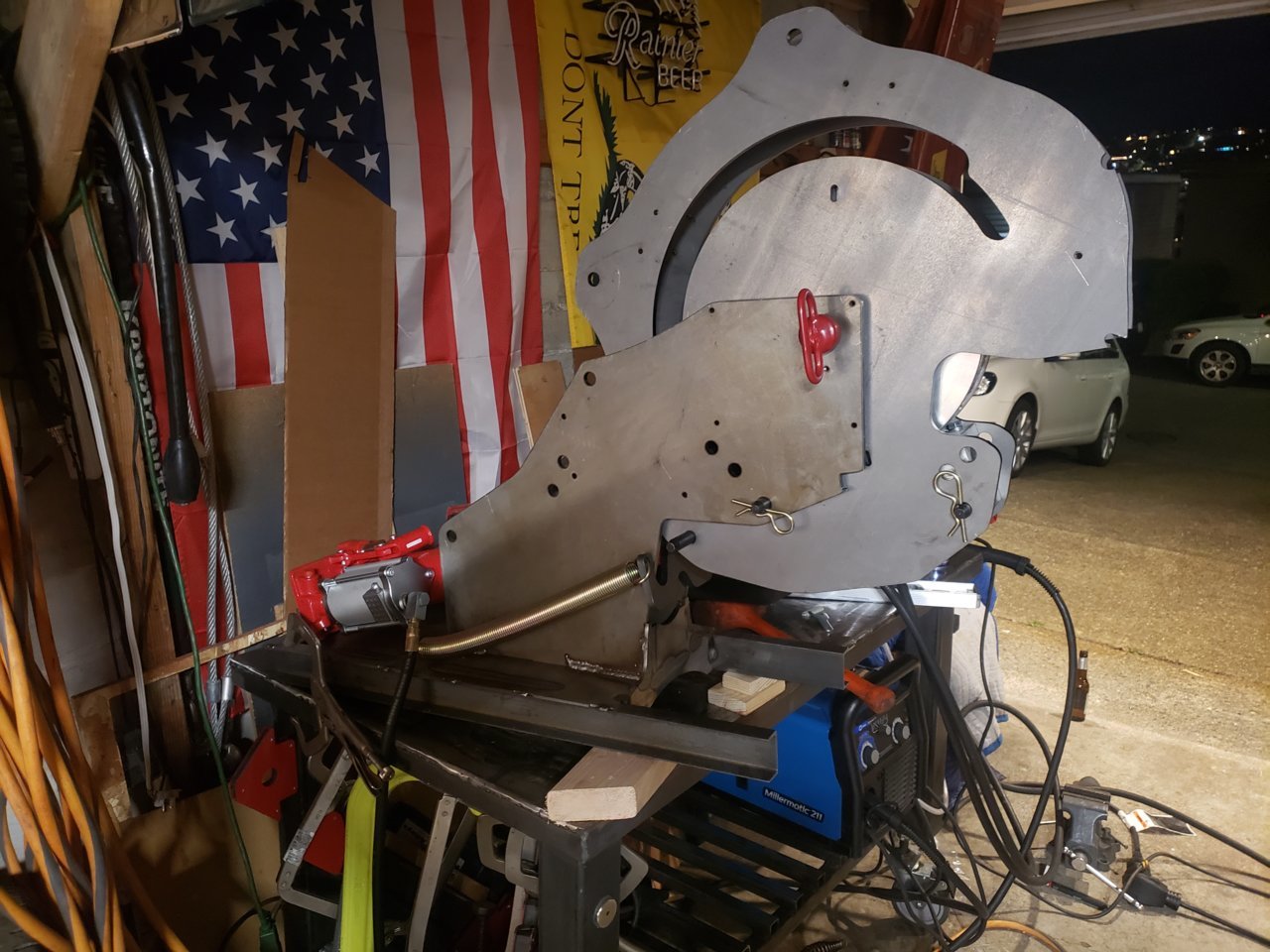

  9. Mar 10, 2020 at 8:16 PM
    #69
    Aray02
    Jan 7, 2019
    #278512
    172

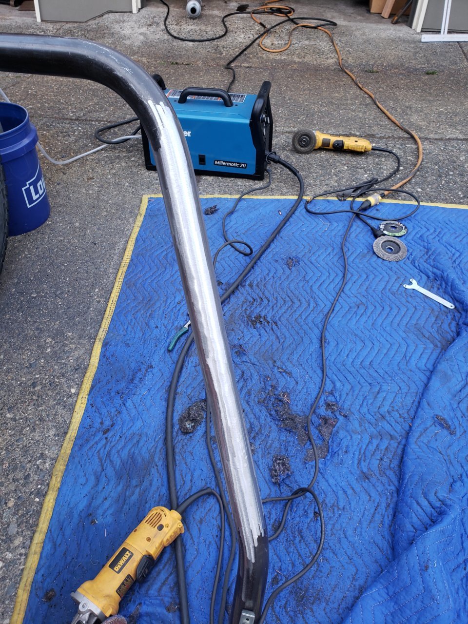

    Also invested in a tube bender from Rogue fab that I finished welding up that I'll be using for the roll bar that I'll start tomorrow. I've never bent tube so it'll be a learning experience.
    spinyard and billybop90 like this.

  11. Mar 11, 2020 at 5:28 PM
    #71
    Aray02
    Jan 7, 2019
    #278512
    172
    Here's the link to where you can find more info.
    https://www.autorust.com/safe-t-cap-kits/
    At the recommendation of my buddy that's a welder a cut S curves where the vertical lines were to maximize the surface area of the weld and to minimize the flex points of the frame. The thickness of the sleeves are a thicker gauge than the frame.

    Drilled some 2.25" holes in the sides to install some marker lights from superbrightleds.com

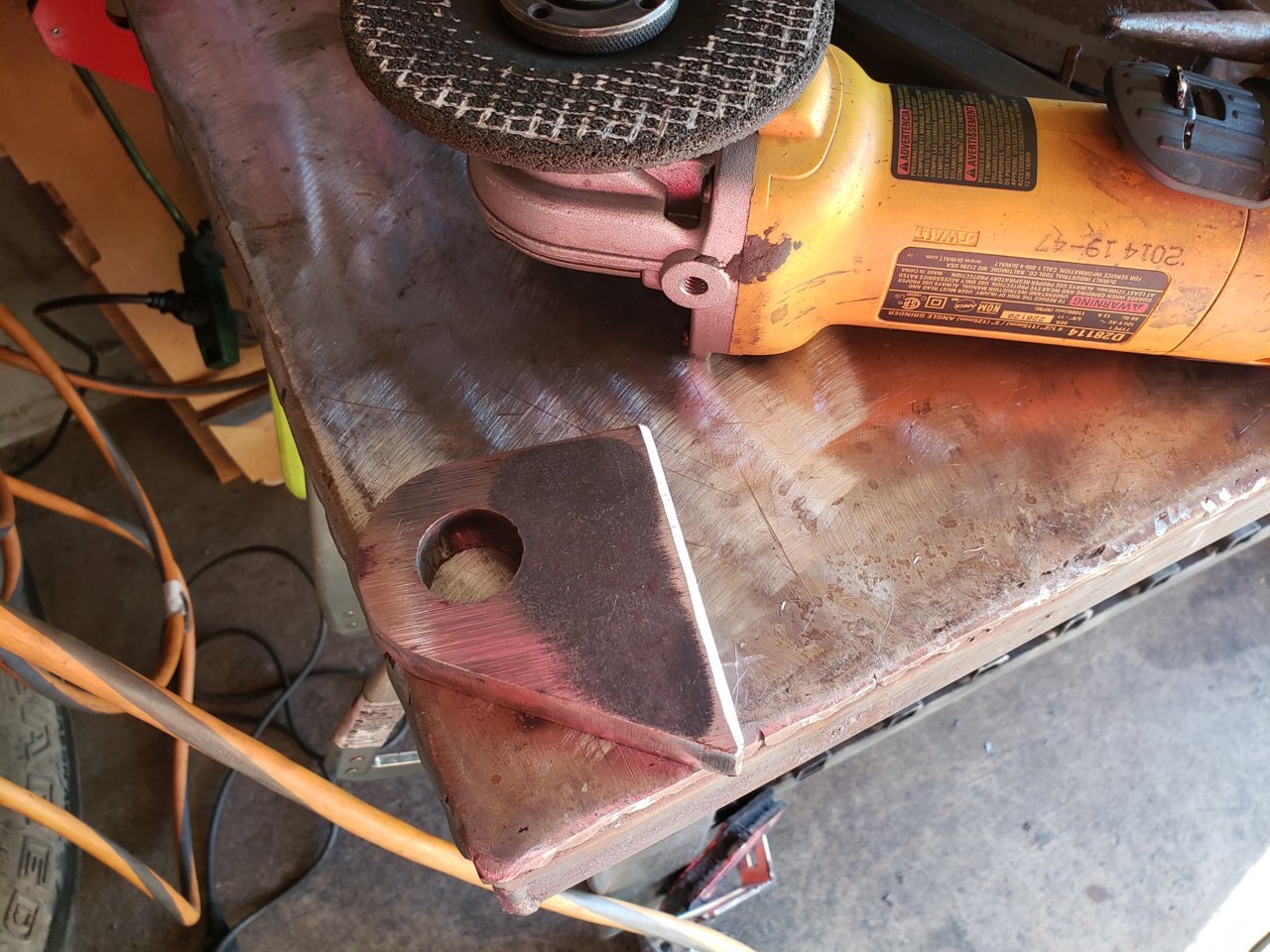

  13. Mar 15, 2020 at 6:23 PM
    #73
    Aray02
    Jan 7, 2019
    #278512

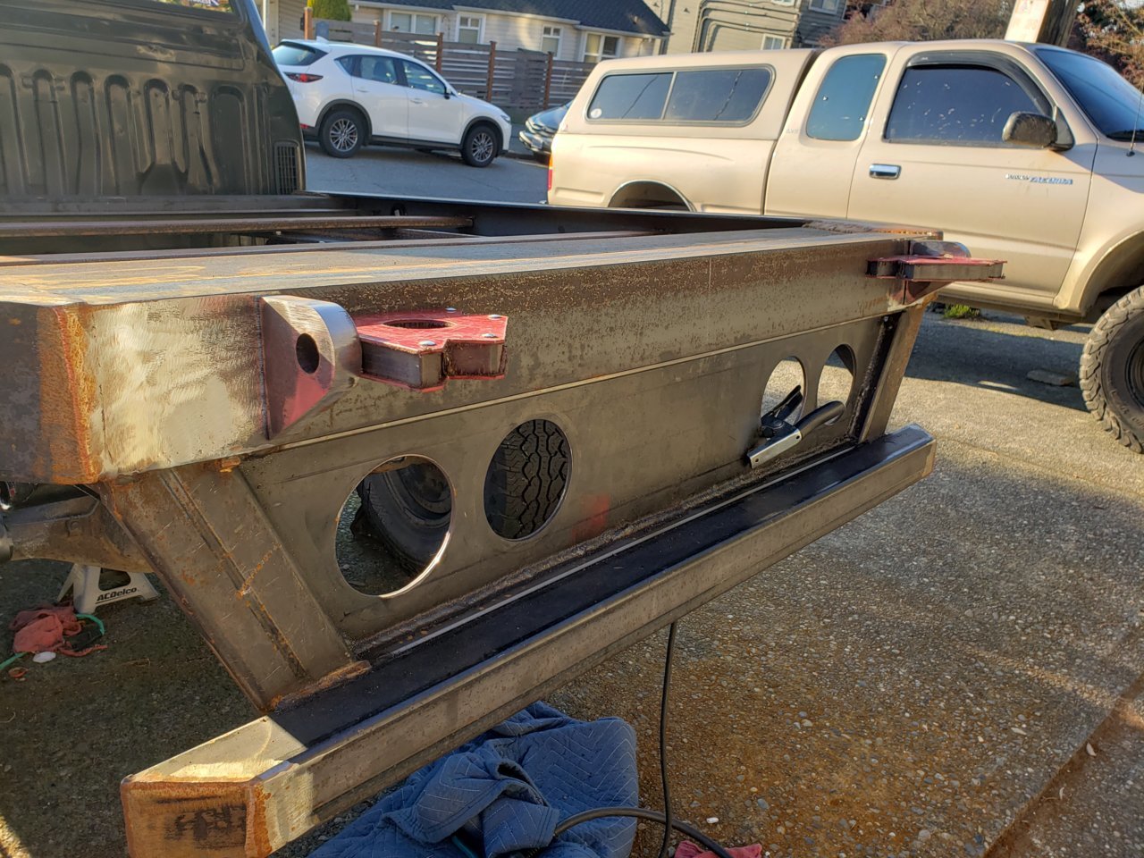

    172
    Good a little bit more work done today after work. Welded some square tube supports for the rear bumper. Also tack welded some shackle mounts. I grinded the edges of the mounts to get more welding surface for a stronger mount.

  14. Mar 20, 2020 at 2:29 PM
    #74
    Aray02
    Jan 7, 2019
    #278512

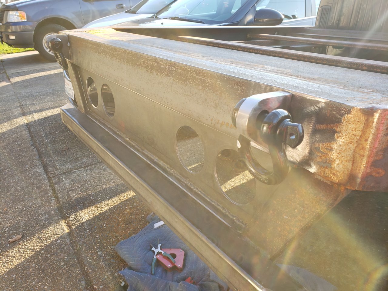

    172
    Finished welding up the shackle mounts from Spyder. There's 2 on each side and 2 in the back so I should have plenty of tie down and recovery points.

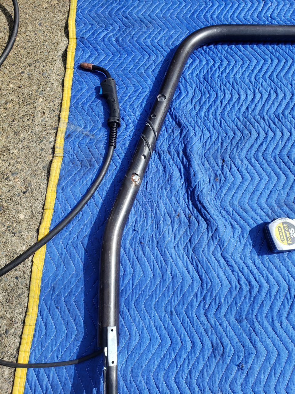

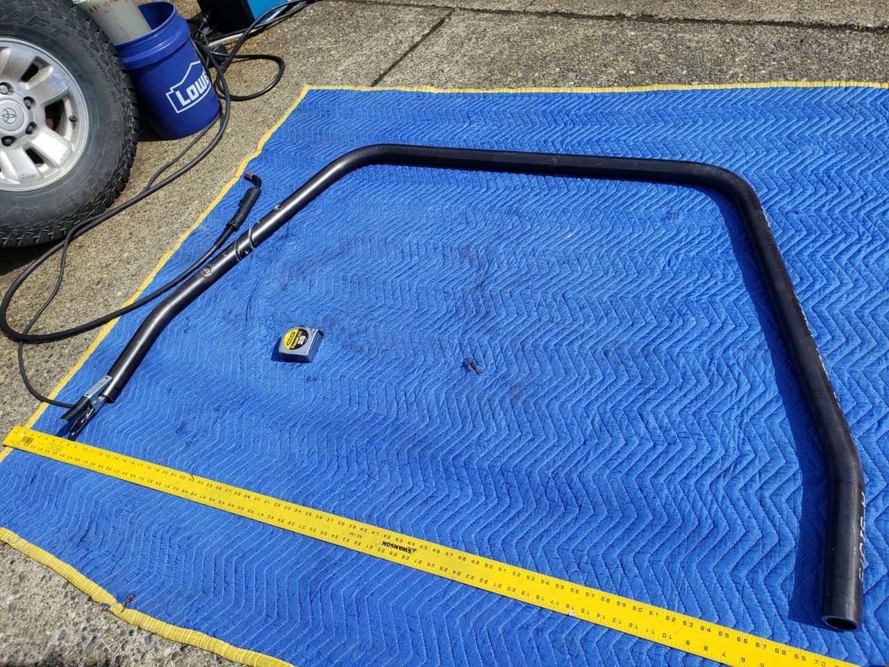

  15. Apr 5, 2020 at 7:25 PM
    #75
    Aray02
    Jan 7, 2019
    #278512
    172
    Finally got the roll bar done! It's 2 OD .250 wall so it's not going anywhere. I could roll this thing down a mountian and be ok.
    Since I've never bent tube before I messed up 2 tube sections and actually messed up this one. I was 2 inches short so I put in a 12 inch 1.5 OD solid stock, and plug welded it in there in 6 places, welded up the sections and took a flap disc and sanded it all down. I realised what I did but each tube section is about $200. The plus side is I have plenty of tube stock for gussets and braces.

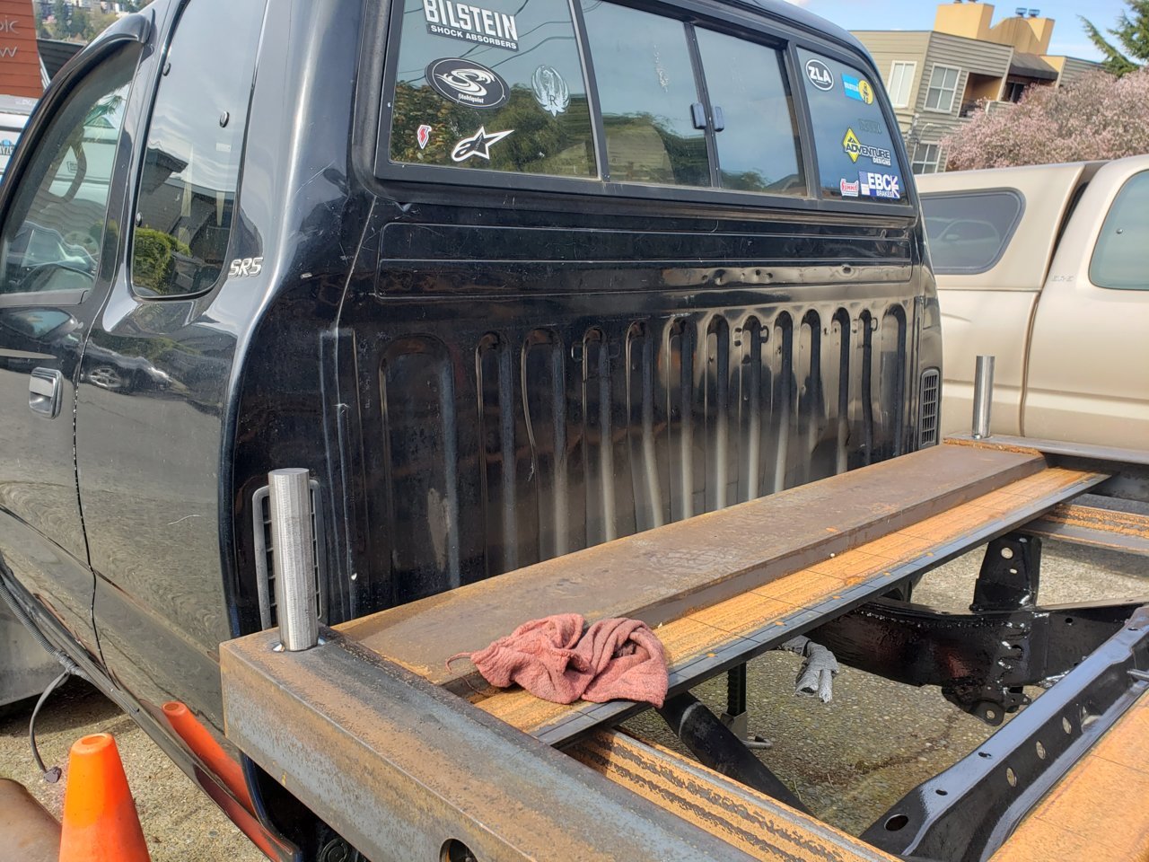

    I used some of the 1.5 solid stock for posts for the roll bar.

  17. Apr 5, 2020 at 7:27 PM
    #77
    Aray02
    Jan 7, 2019
    #278512

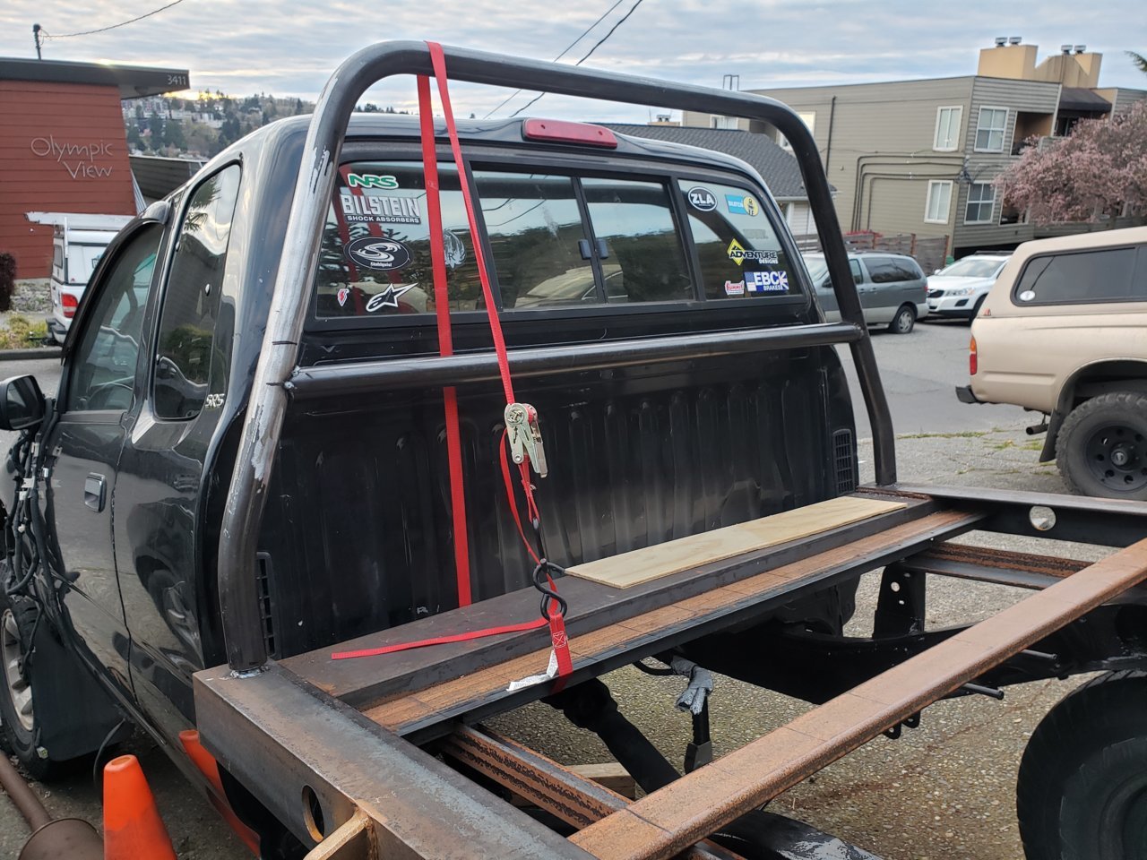

    172
    The roll bar is a tight fit. Also welded in a cross brace. Tube notching 2 OD was a pain since I'm still learning but it fits. Tacked it in there for now.
