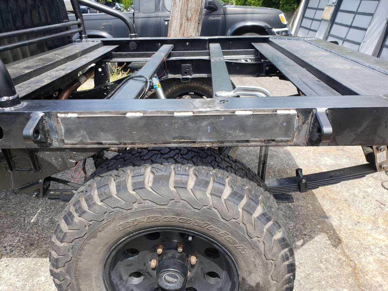

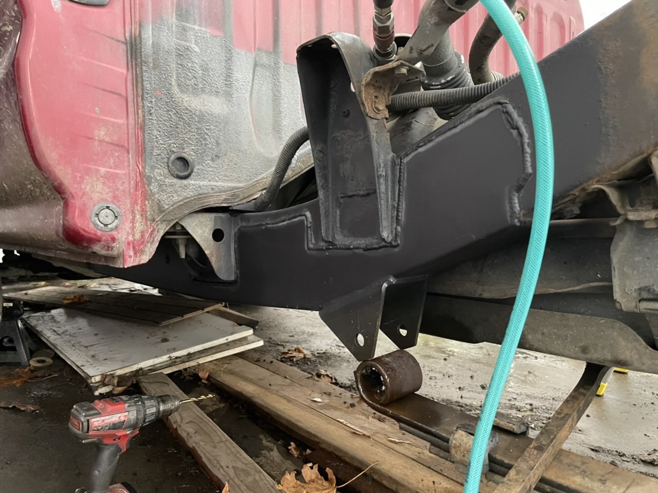

    Welded in some strongbacks at the seperation point. Should add strength.

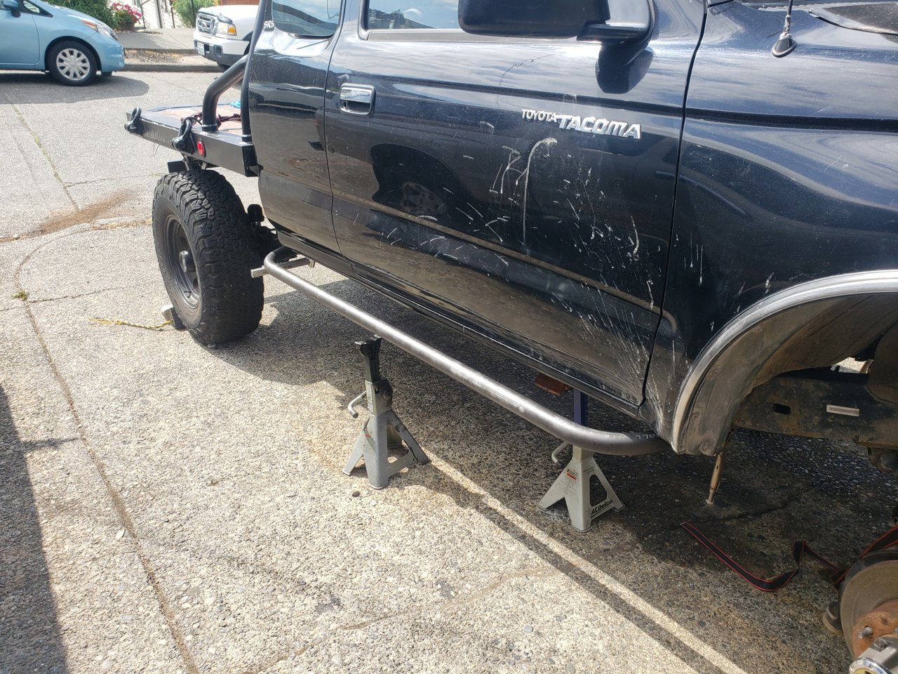

    Also in the middle of fabbing up some sliders. They're just clamped in as of right now. Going to fit some supports and the brackets where they'll be bolted to the frame.

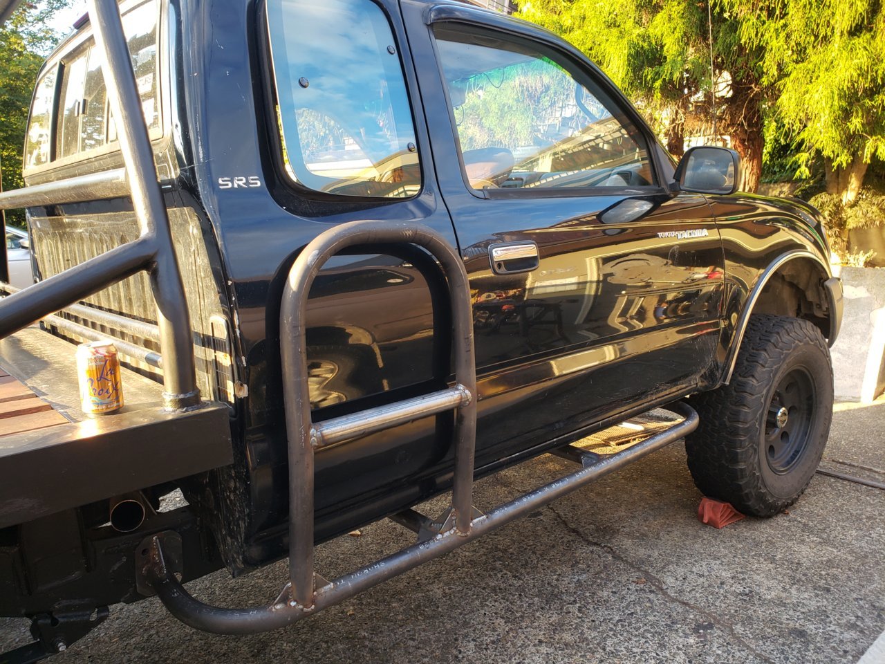

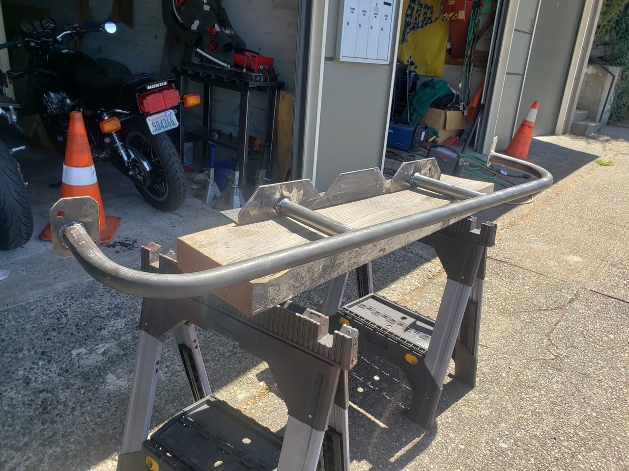

    First attempt at rock sliders. 1.75 dom at .120 thickness. Should take some abuse.

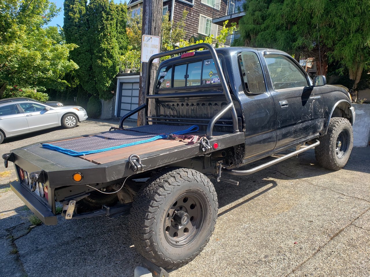

    I don't think you're over weight at all here I think you just built the bed level across while a stock truck has bump outs for the wheel wells. If you look at your truck with the original bed on it the tops of the wheel wells are a couple inches above that crease in the door panel and your new bed is about an inch or two lower.

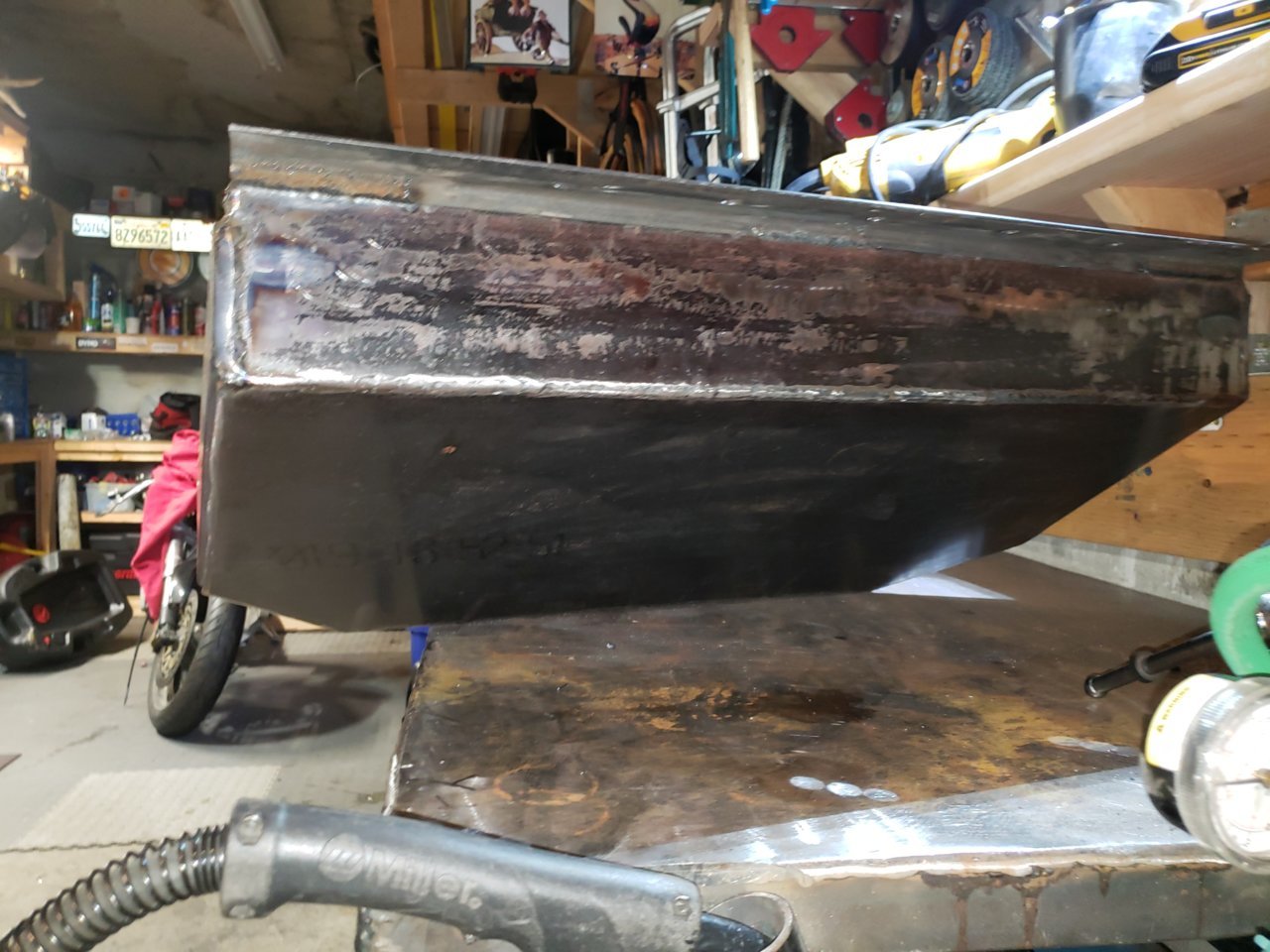

    Did some more work with the bender. Also welded in some gussets for added strength.

    Painted and secured the sliders. When I tightened the mounting bolts done the tube makes contact with the body. I'm going to figure out some spacers.

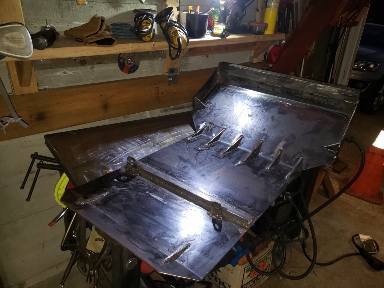

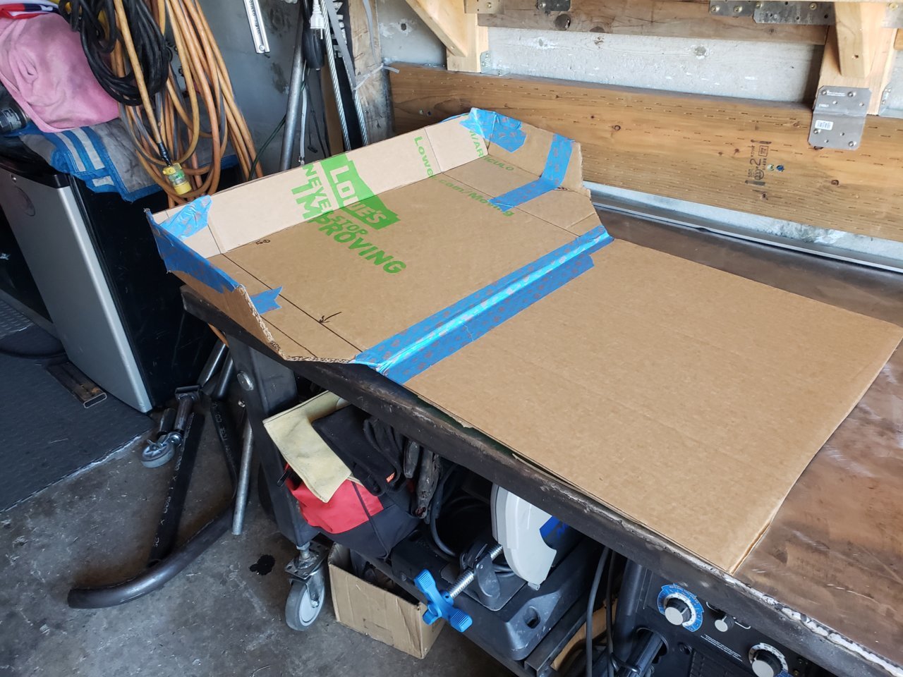

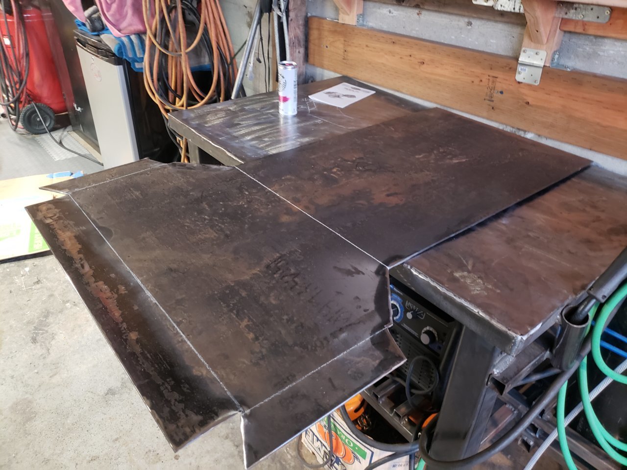

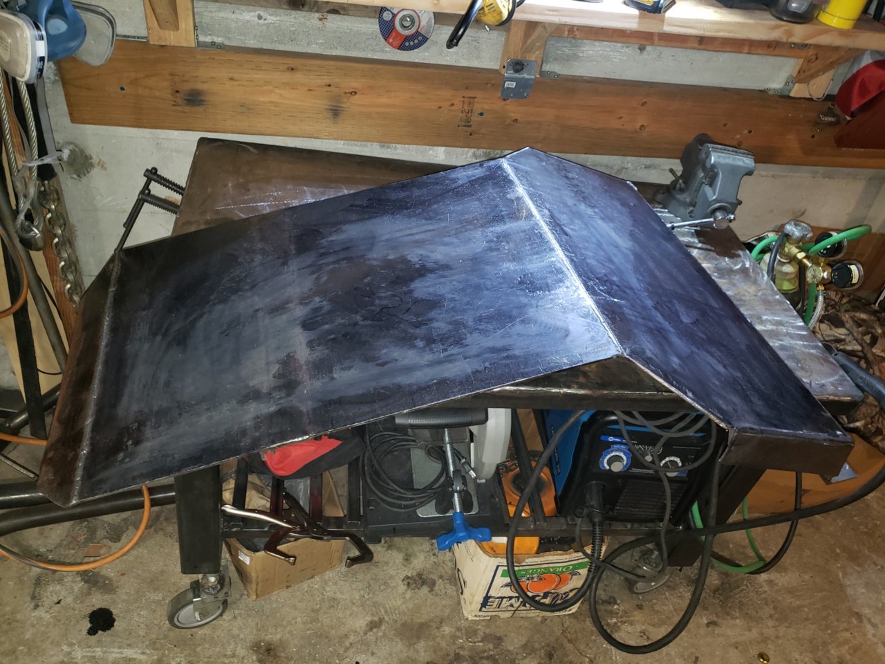

    In the process of fabbing up a front skid plate since my oem one is long gone. Made a cardboard template and transferred to 3/16" plate.

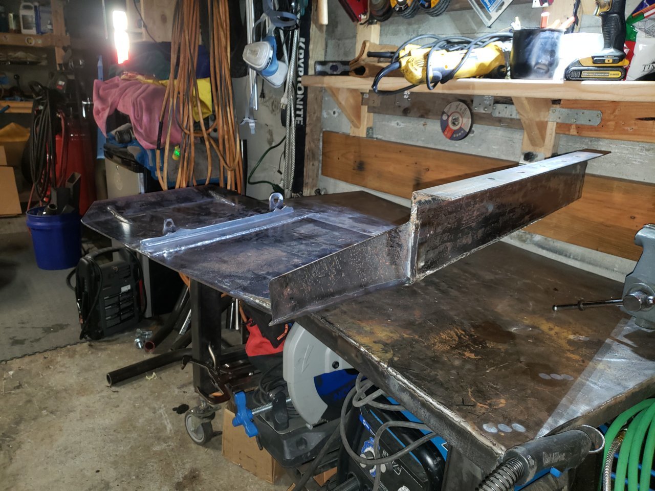

    Finished up the fabbing and welding. Just have to prep and paint.
