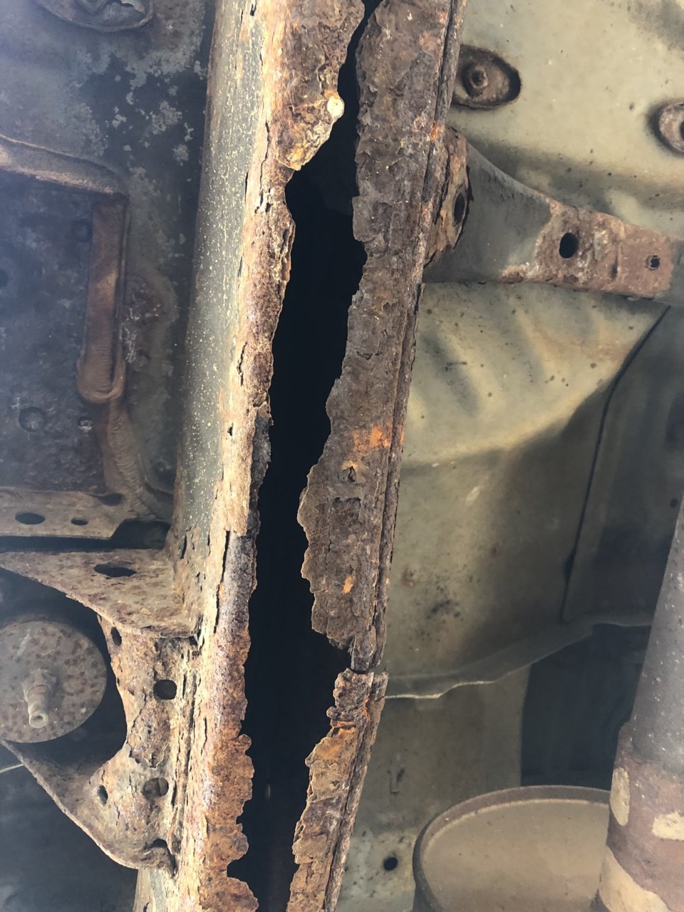

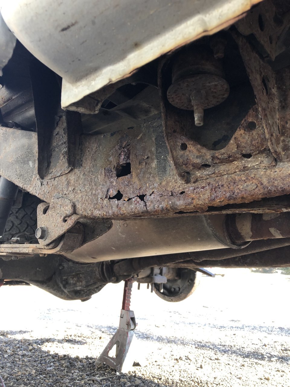

    That's really a shame ,nice looking truck. Have you brought it to a local welder? They may be able to make cardboard patterns and plate over that frame with new steel beyond the rust damage if the rest of the frame is sound (er). It's worth asking anyway. You might get some more time out of it. I can't tell exactly where that part of the frame is, it looks like middle behind the cab, but it doesn't look like much happening there (other than structure).

    My friend works at Monroe Truck equipment, he welds, one of his concerns is that rust spot goes all the way to the back leaf spring.

    Might still be worth a try if you can get to good steel. I wish you luck with it.

    It can be saved might be more expensive then you care to spend .
    If need be a new back section can be made and spliced .
    All kind of different ways you can go.

    That frame is totally done. Not worth patching. Either sell for parts or frame swap which would be costly even done at home.
