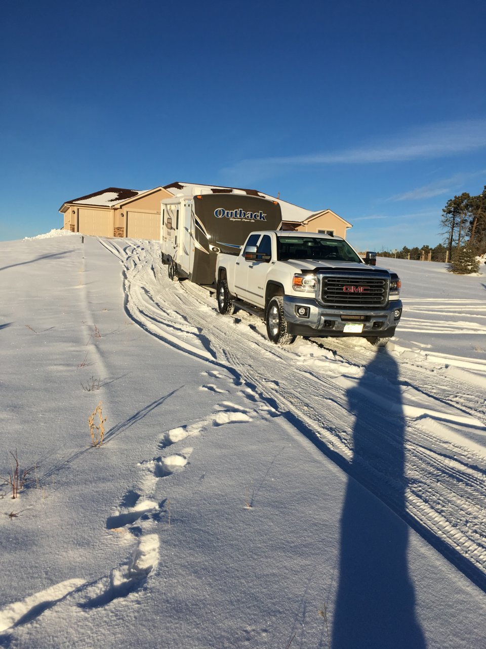

    In 4 years I have not had any mechanical part failure. Well, I had a front CO that had a nick in the shaft. 58.00 later, plus 38.00 for seals and oil, and an hour in my garage it was good as new. ..Now roll overs, flops and dents don’t count. Enough of the Heep junk though.
    So the point is, the OP has a stock Tacoma, in snow, non-aggressive tires (so low traction), no suspension hopping, and this happens? Could it possibly be a defect? As a company I would want to find out what caused the failure, then decide if warranty will be honored or denied. I have had 3 Tacoma’s (99’, 00’, 14’) and wheeled the shit out of first gens. One had a huffer on it, and a healthy build. I have also owned two limited 4Rs, wheeled them both as well. I have broke a half shaft before, but never some failure like this.
    I have a co-worker that just sold his 05 Tacoma, and had a rather rough first 5 years. One failure I would like to point out is his rear axle failed at 58k miles. He doesn’t go off-road, ever. So in stead of just saying “abuse, warranty denied”, Toyota researched what happened. Come to find out, the bearings failed, all service was performed at dealership. Axle was replaced.
    Do you think I’m afraid to floor my Duramax in 4lo? Nope. Last week I had to yank the toy hauler out from my property in a few feet of snow drifts, then back it up my 7% grade driveway. Now I wouldn’t do that if chains were installed. No need. 47F3218C-DC70-4E66-98EE-35CCC19F0112.jpg
    In my honest and humble opinion, a part failed in that front axle way before it should have, and nobody is investigating why. This is obviously very rare. Can anyone else remember a failure like this on any other 3rd gen under 10k miles, or at all? Am I to believe the OP is the only one that has used heavy throttle in 4lo in any kind of terrain?

    #202

    The point I was trying to make is peoples idea of “off-road” differs a little.
    I always like the comments “I have gone thousands of miles off-road without breaking anything...”
    The top picture is referring to those people.
    When my 10 year old is driving my TJ, she thinks it’s hard and extreme. For her, it is. I can’t wait to build her a little crawler.
