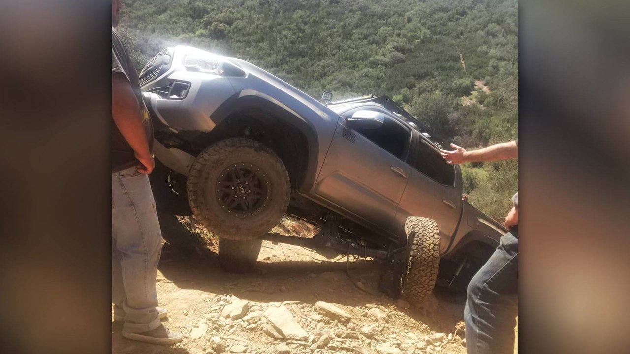

    That was a dude in here last fall. He definitely was at fault, the video is around somewhere.

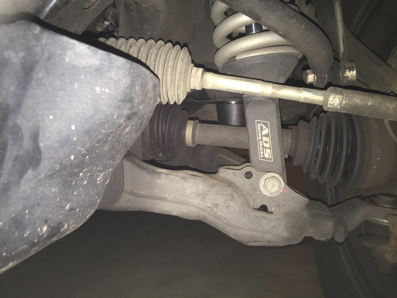

    Is that ok? To me that’s looks pretty angled with ribs touching

    That was @SilverSky I believe

    It looks okay to me. The inner boot has two fins that are close but looks like they clear each other. As long as you can slide a piece of paper through you should be fine. Boots are going to rub no matter what when your articulating the front end offroad, it's when you're driving around day to day that you don't want that happening.

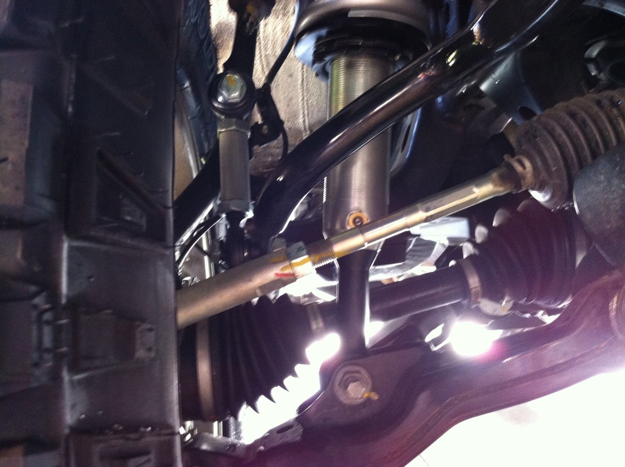

    Lol thanks. My lift is only 1.75” with about 1” of threads in the preload. My skid plate is about 1/2” from the diff arms.
    I could just take it out and drive a bit and put them back in if they seem to angled right?
    Not hard to take out/out in right? Can just use same bolts with or without spacer?
