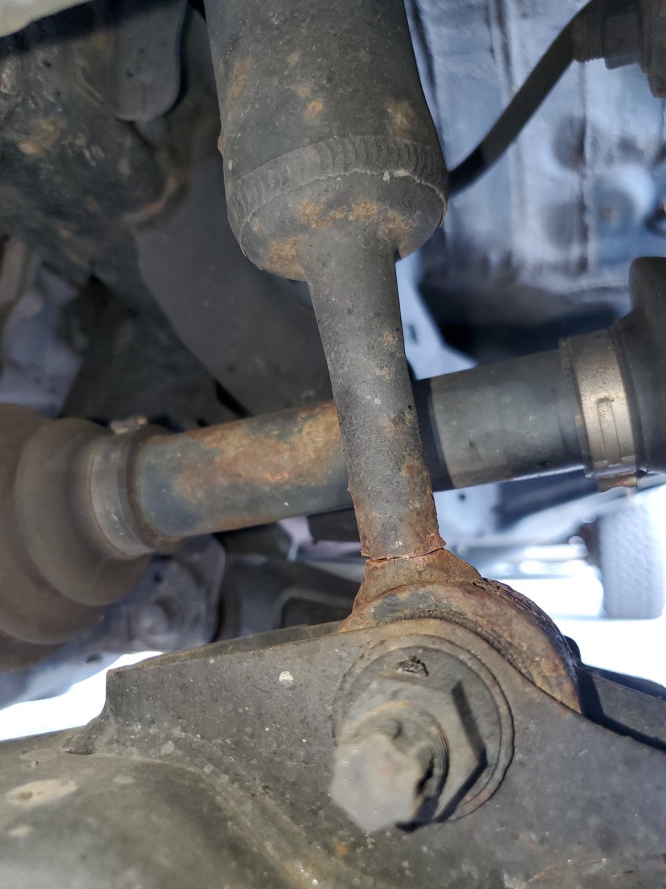

    Was driving on my street and both of my front struts just broke entirely! I don't do much rigorous driving in my truck and this happened while driving 15mph on a residential street
    Has this happened to anyone? Any suggestions on what to tell the Toyota dealer I bought it from? Insane

    @gotoman1969 Trust me man, I've only owned this truck for a year and I take good care of it. I mean if you look at the pics they're rusty but definitely no condition to just break off like that.
    That's the result of some major stress that I have not put on this truck. That's why I'm asking whether anyone has seen struts break like this in that condition.
    Funny thing is I just got an inspection and passed so the mechanics certainly didn't notice (that is if they were even looking closely)

    Yeah, it happens.
    You see it more on trucks that are lifted with top hat spacers.
    Is your truck lifted?

    Looks like the spindle or the part that ties the spindle to the LCA is about to fail too.

    @TnShooter No lift. I guess it just happens. Any suggestions on replacement shocks? I was thinking Bilstein 5100's
    @BLKTRUCK I guess that's gotta be replaced too. Should I go OEM on a replacement for that?

    Strange they broke about the same time, but guess would be possible weld defects or crappy shocks in general. In fairness they look a bit past due. Also might have been seizing the bushings? Maybe get aluminum body shocks!

    It looks as if the the control arms are newer than the lower ball joint mount.
    How long ago was the frame replaced?
    If it was recently, you’d think who ever did the frame/control arms would tell you about the shape the shocks were in?

    When my frame was replaced i got new LCA. You should of too

    FWIW The dealership may have torqued the lower strut mount on the LCA while the vehicle was unweighted and suspension at max height. That would result in undue torsional strain on the strut when the LCA was back in ride-height position. However, those struts look baked so that may have been the last straw!

    That is wild. It almost looks like is was broken, then started rusting.
    Someone not like you and cut thru the struts? :eek:

    I've been doing machinery warranty investigations for years. What does the fracture face look like? The wounded metal often tells a story..... Got more pictures that show it?
