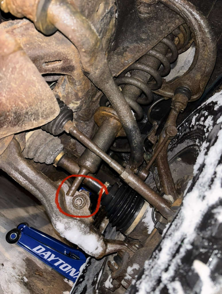

    Actually had this happen on my parents '10 at some point in the spring. My moms been using the truck all winter, but she has a short commute with smooth roads. I got under it after taking it to get gas and it feeling "weird." Driver side front strut had sheared the same way as yours, OP. Passenger side was fine. Original shocks with about 182k on them. I would chalk it up to age and fatigue. But frankly, the time to change a lot of the original psrts was when you were getting your frame replaced. Take care of that new one

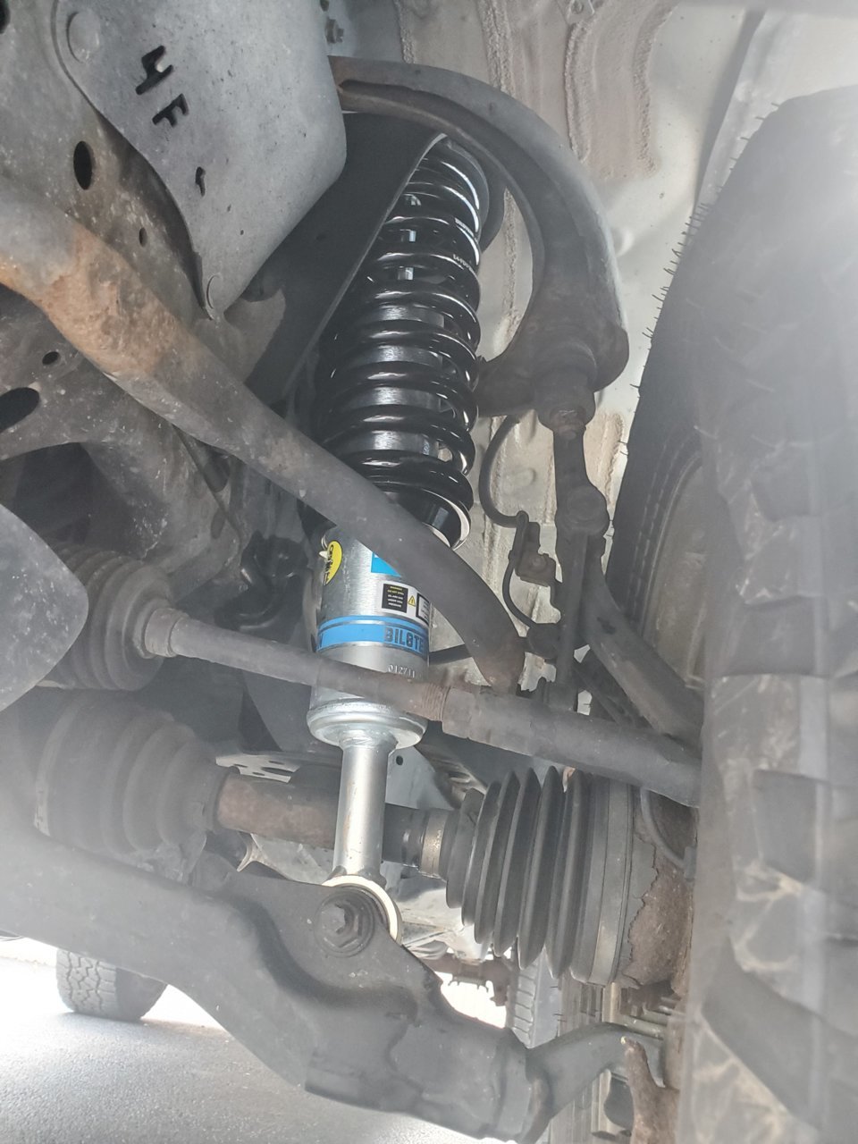

    Thanks for the suggestions everyone. After 11 days of waiting for these to come in the mail and to be installed, these Bilstein 6112's set at the .6" ride height have resolved the issue. I spent more money than I wanted but I got a quality product. It's worth it since my truck only has 80k miles on it and I want it to last a long time , especially since I'm in snowy NY state.20210811_150106.jpg

    My ‘06 driver side sheered just like that.
    I replaced both with some Amazon struts, and then learned that broken struts are a symptom of a worn front end. Explained the recently developed squeaking and creaking from the front. Ended up replacing the whole front end (UCA, LCA, ball joints, tie rods, tie rod ends, sway bar links) and the squeaking is gone. LCA’s were definitely seized, had to cut everything out. Eliminated the squeaking and creaking, think she’s good to go.
    I bought the TRQ front end kit from parts geek for like $320, as well as UCA and LCA bolts for another $70, since I had to cut them all out. Add $140 for the Amazon struts, $120 for Amazon CV axles, and another $45 for the driver side differential bearing and special puller tool. Boat load of work, but did it all myself for about $750.
