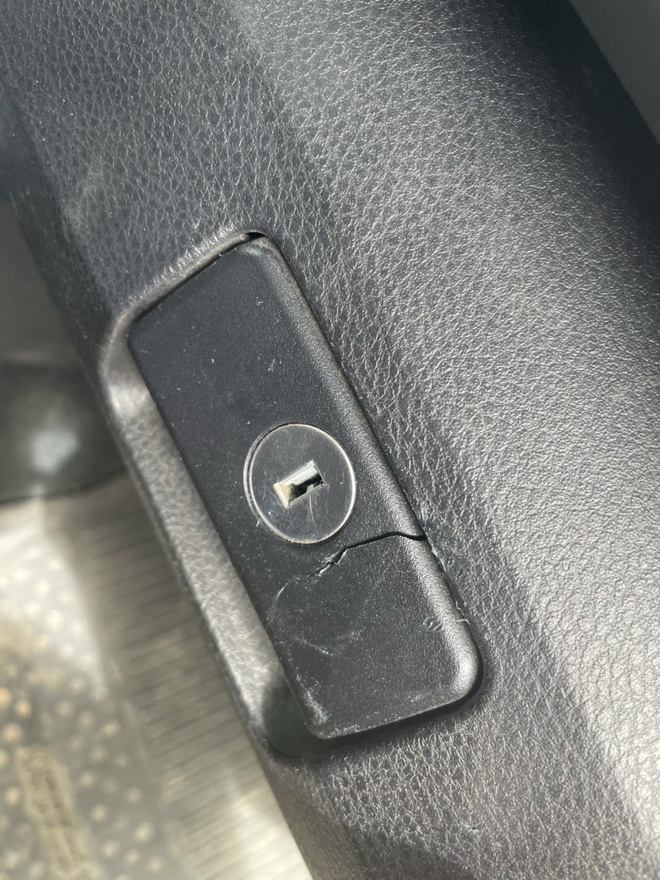

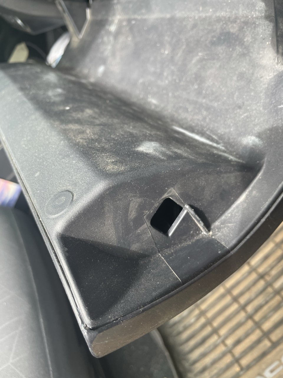

    Some dimwit broke into my truck and stole some stuff I had in the passenger compartment, but also the entire contents of my glove box (including the original owner's manual :mad: ) In the process, they proceeded to break the latch that holds the glove box closed:
    I can hear some rattling inside, so something is definitely snapped off in there. Now the box hangs open unless I tape it up, which the missus doesn't like. I looked into fixing it, and it seems like there's not an easy way to get the glove box out (you have to remove the knee curtain airbag?!) and the dealership quoted $800 to replace it which jives with the PITA factor of removing it.
    Has anyone done this before? Do I need a whole new assembly, or are there hidden screws someplace to get at just the latch to replace only the broken bits? Any guidance is greatly appreciated.
    And yes - the glove box was UNLOCKED at the time.

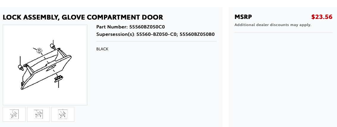

    wonder if this would work for you? it looks like the glove box latch...
    or you could always ask Jeff Lange in this thread to ask if this is the right part number and if that latch is replaceable:
    https://www.tacomaworld.com/threads/2020-parts-list.619005/page-45
