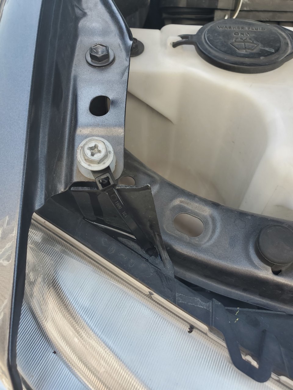

    Quick fix for those of you with broken headlight tabs. Mines been this way for 2 years and finally decided to do something about it!
    Materials needed
    1 hole zip tie, Phillips screwdriver, sharp object

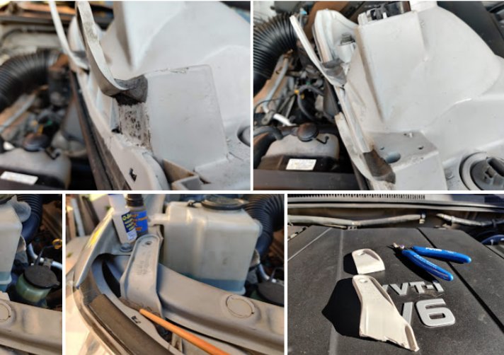

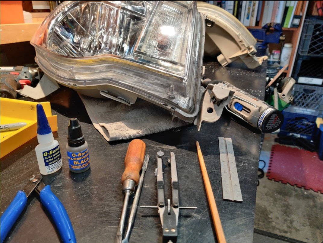

    I did five or six tabs recently, when I replaced my opaque 06 headlights with some oem take-offs from an ebay seller (who pretty much just sells headlights..). The headlights were in very good condition, but a bunch of the tabs were broken. I knew this when I bought them, so was expecting to do some repair work. I dremel'd off the old tabs from the original units, and bonded them to the new ones using a combination of 2 part epoxy putty and Q-Bond. Which is cyanoacralate with a reinforcement/filler powder. It's always in my tool-bag o'tricks, very useful stuff.

    Ran across this thread while trying to deal with my same broken tab..
    I'm surprised that bolt fits through the zip tie. Will have to give this a try.
